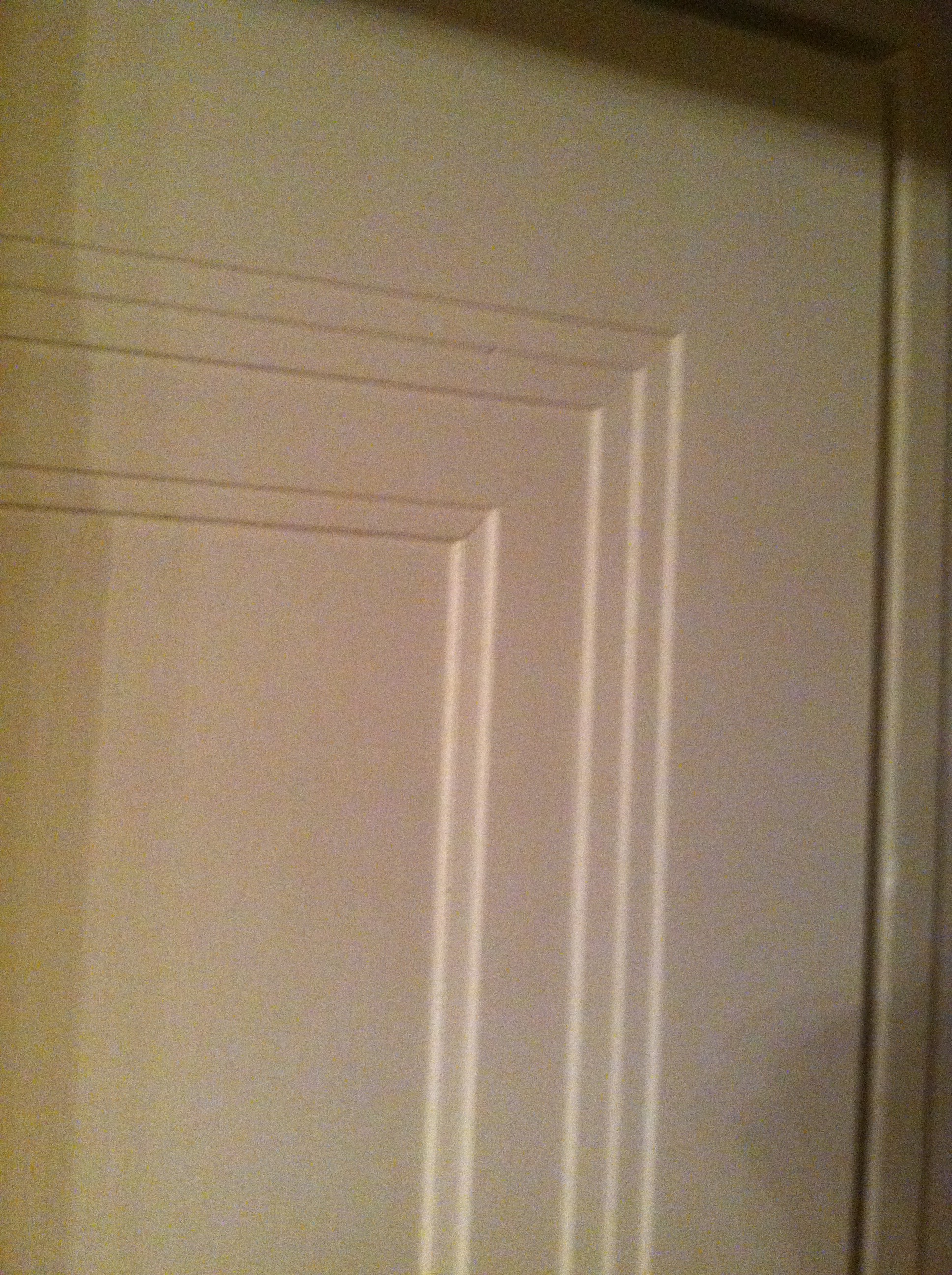

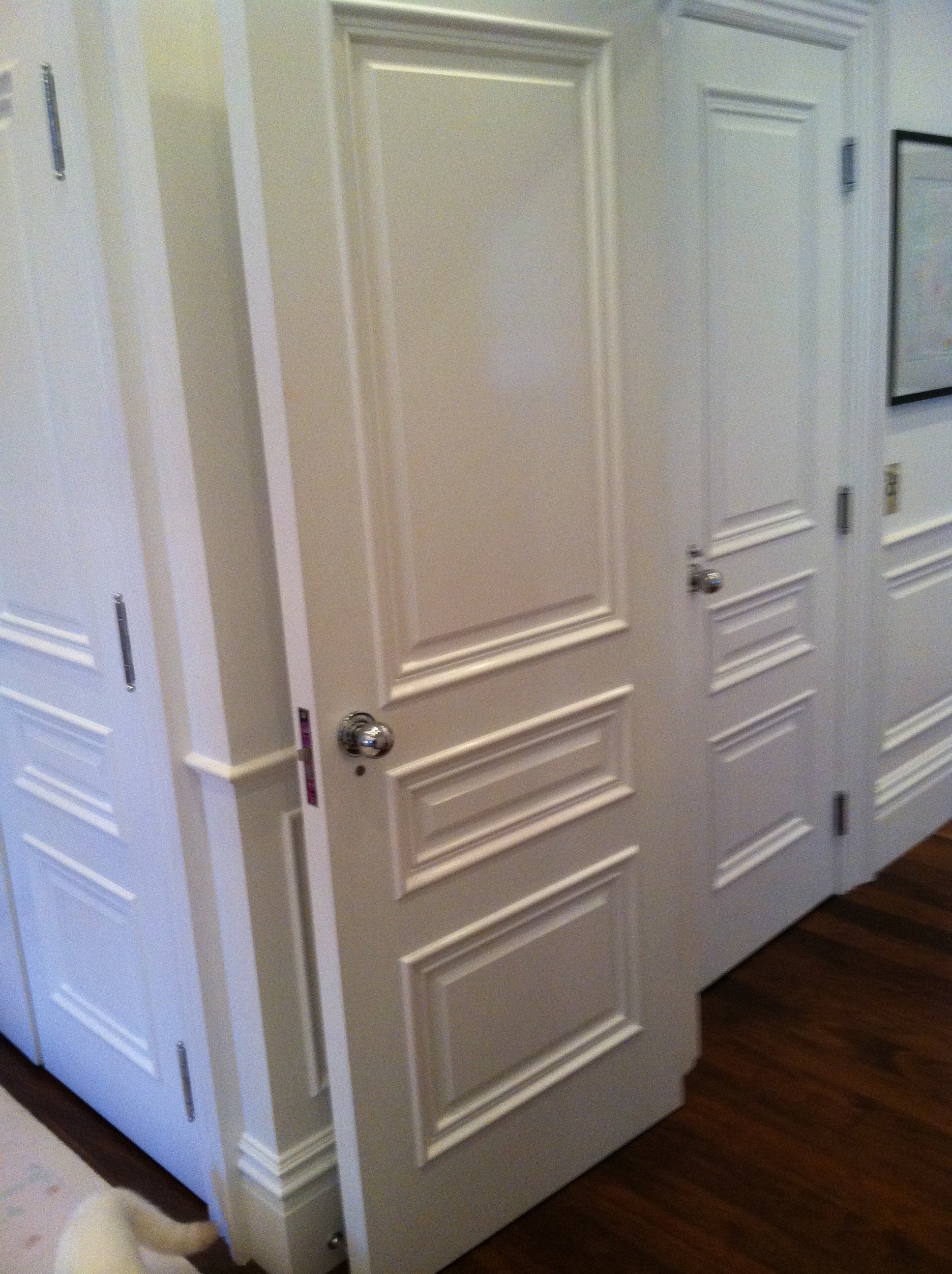

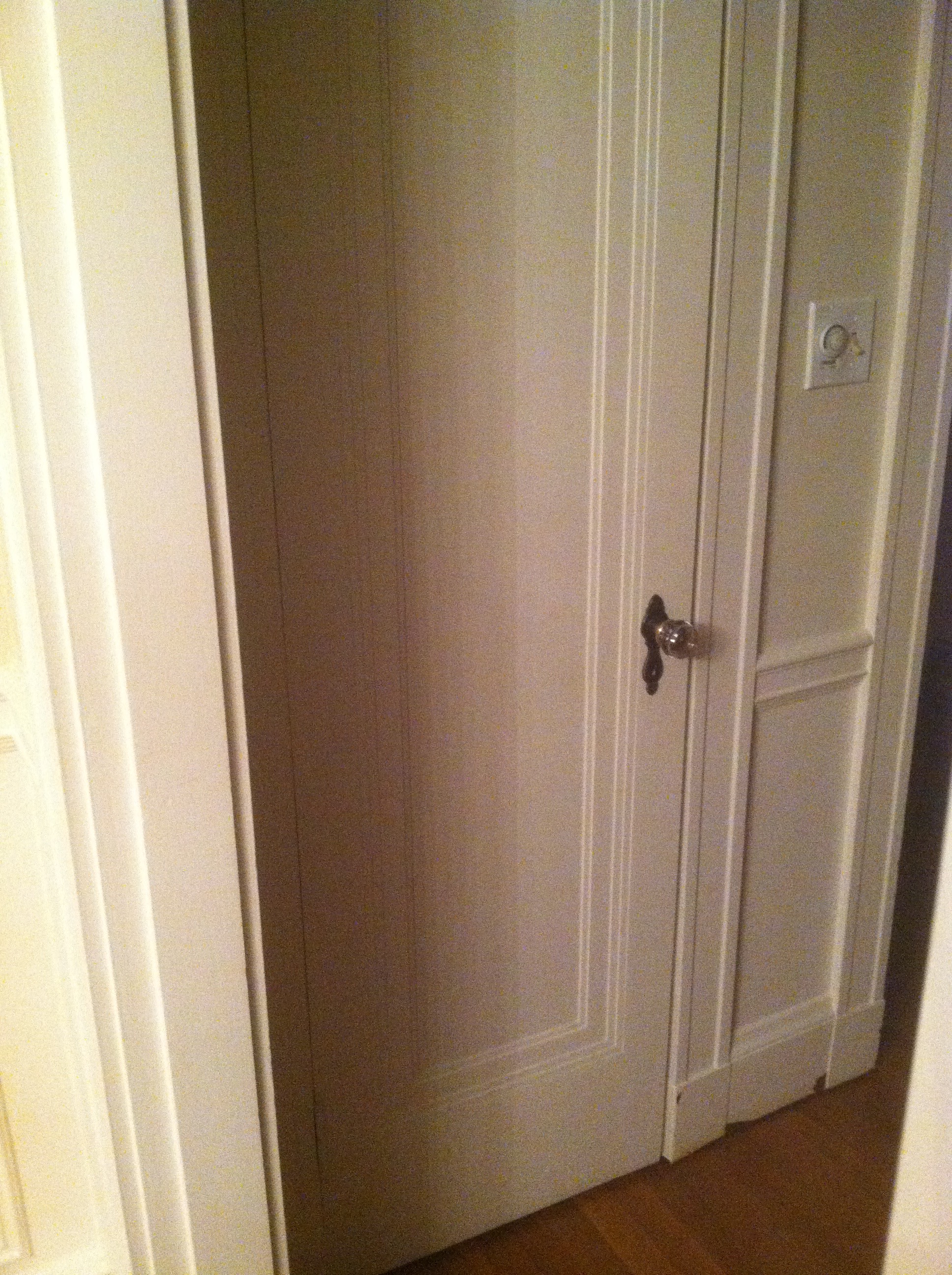

How would you make these doors?
2/12/16
JeffD
Or maybe a better question is how do you think this one was made? I have to make 2 doors to match this one and am trying to figure the best method of construction. Right now I'm leaning towards fabricating with just a plain square edge shaker style cope and stick, and loose tenons. Then add the molding by gluing to the edge and the plywood panel. Seems simple but I didn't think it was proper technique to glue a somewhat wide molding to a panel? But certainly seems to be what's going on here?
JeffD
View higher quality, full size image (1936 X 2592)
2/13/16       #2: How would you make these doors? ...

That is a type of door from the middle of the last century called the Miracle door. Why the name, I do not know. Perhaps it is due to the inner frame members and ply introducing an added resistance to movement. I have reproduced them several times. I usually saw the originals made in Red Gum.
It is a 9 pc door, with a frame mitered around the ply panel - and glued to it. And the 4 pc coped and stuck, mortise and tenon rails then go around the inner frame in the conventional manner. The inner frame can also be coped and stuck and then mortises used. Alternately, the profiles (molded onto the frame edges, integral) can be stop mitered at the corners to avoid having to cope or have the tooling made.

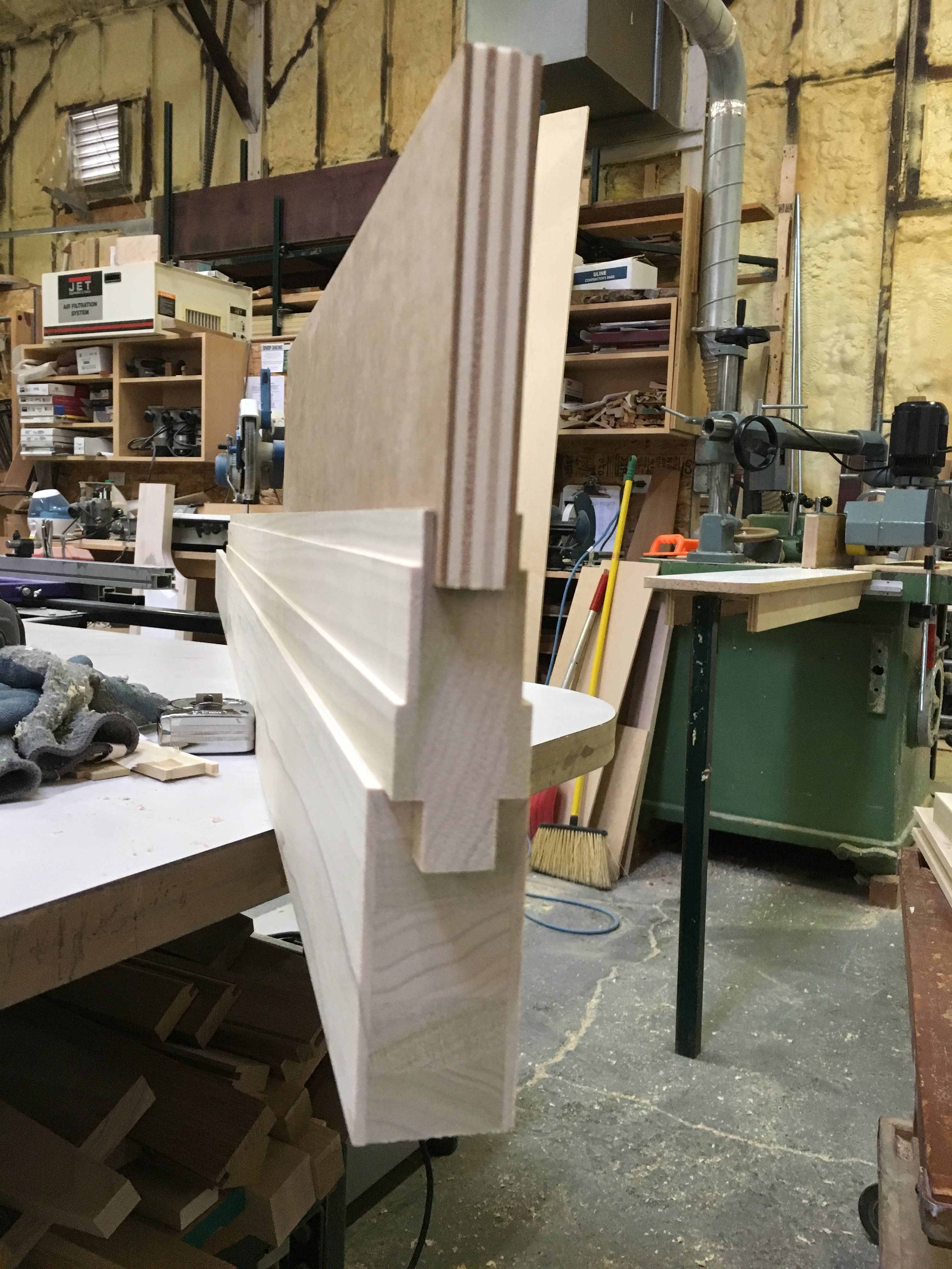

Ok so I started the doors last week and am making progress. I've decided to go with the poplar for the doors and see how it goes. Since it's only 2, and it's local, and the family are good clientele who will report back if anything is amiss....it's a good place to see how it works out.
Anyway I have the outer stiles and the inner frame parts all milled. So what I'm wondering now is best way to assemble? I'm thinking of going the way I think Dave was saying, which is to glue the inner frame members to the plywood panel. Then have that entire panel assembly "floating" in the stiles and rails as a normal panel would? I just have to come up with something to keep it centered as I don't think spaceballs are gonna work here.
3/7/16       #23: How would you make these doors? ...
Kevin Jenness
Jweff,
I thought David was suggesting that you house the inner frame in a dado as wide as the frame is thick so as not to have to size the parts so exactly. Your photo shows the inner frame tongued rather than fully housed.Do you plan to have a slight reveal around the inner frame?
Given that scenario I would use some sticky backed foam weatherstrip to center the inner frames .
Is that Plumaply you are using for the panels?
3/7/16       #24: How would you make these doors? ...
Kevin Jenness
Sorry, I meant Jeff. I wish there was an edit function.
3/7/16       #25: How would you make these doors? ...
JeffD
Thanks Kevin, looking back I think I've started mixing up the different methods guys have proposed! I really didn't like how thin the stile edge would get though if I recessed the entire assembly into the s&r's and decided against that method.
Right now I'm deciding between gluing the inner frame to the outer frame tight and letting the panel float. Or leaving a reveal between inner and outer with the inner floating, and gluing the panel to the inner frame.
There is one last section of profile about 3/32" x 1/2" that will be loose until final assembly and will be the last step between inner and outer frame and would cover any reveal. Though the more I think it through at this point it's probably better to glue the frames together into a solid piece and let the panel float. Otherwise that last piece is going to be problematic. My concern is will the miters then become a problem?
