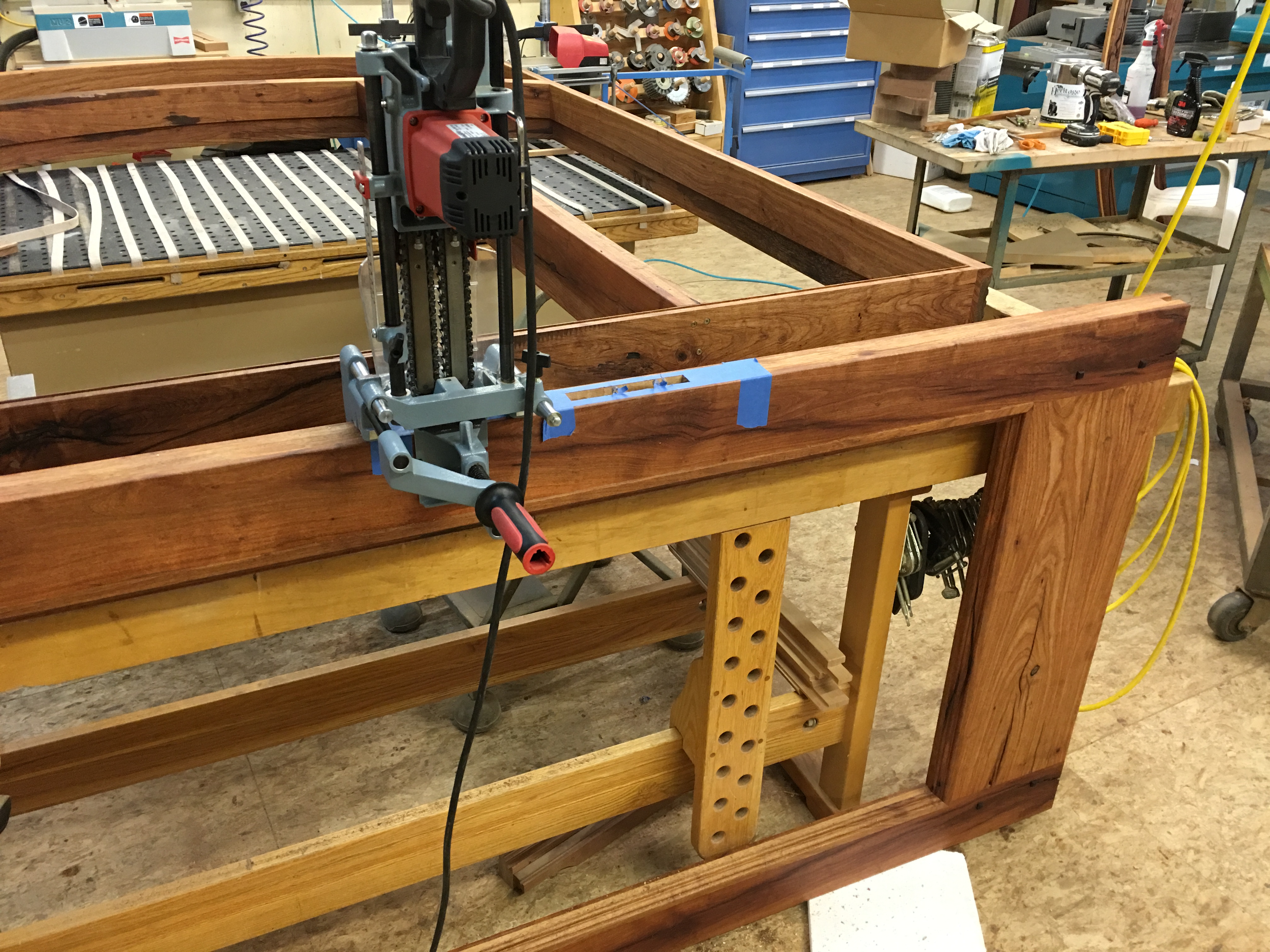

I have a PC and agree with the above posts. Once you get the hang of it, set up is fine if you you use a test piece (which is key). Mine is missing the rod set where you can index down to the same height from the top of each door. That would've been nice, but I just put blue tape on the edge of the door with a reference mark.
