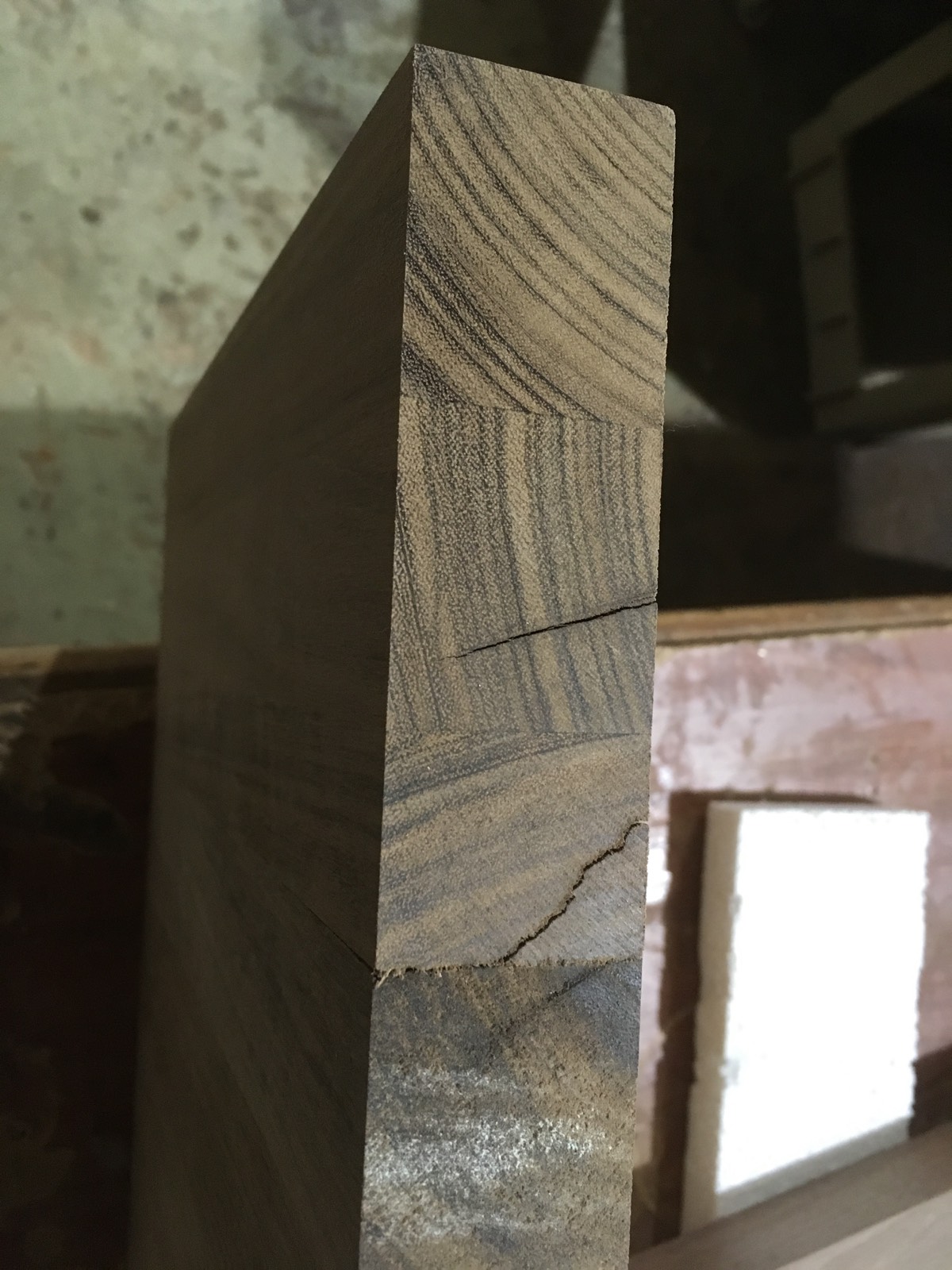

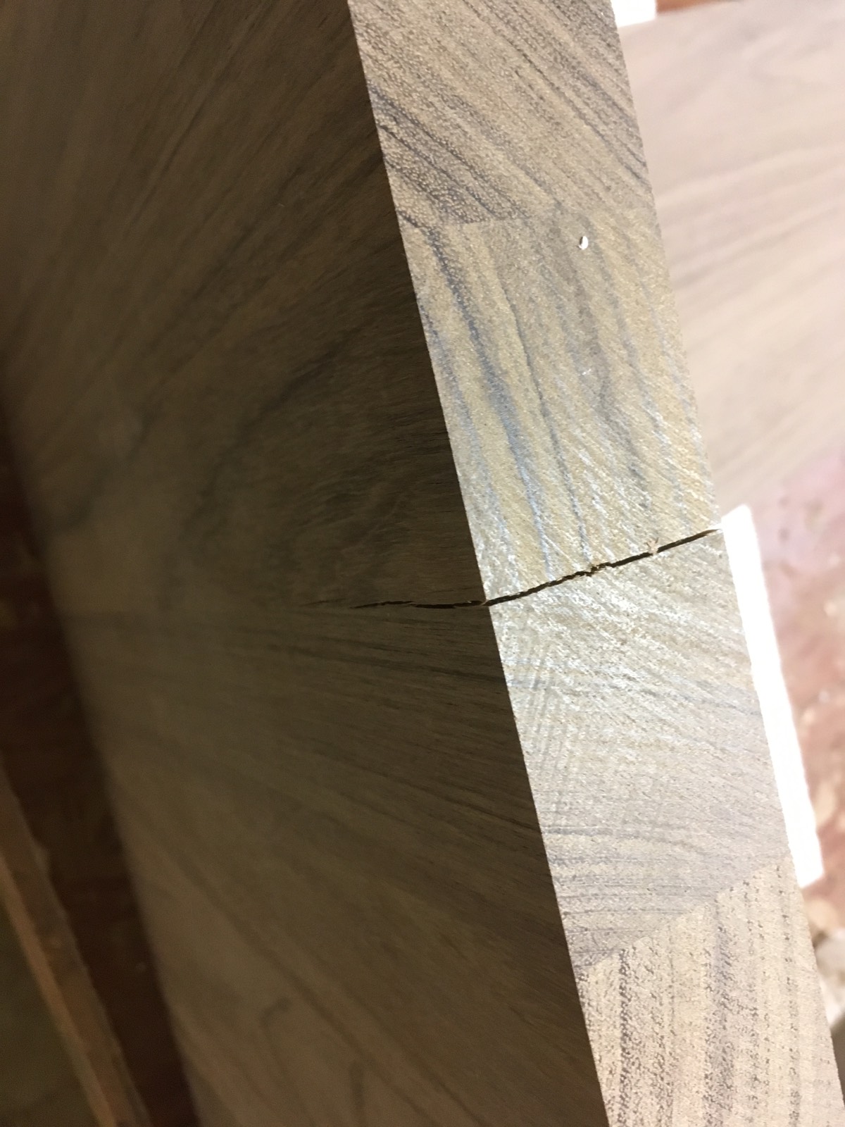

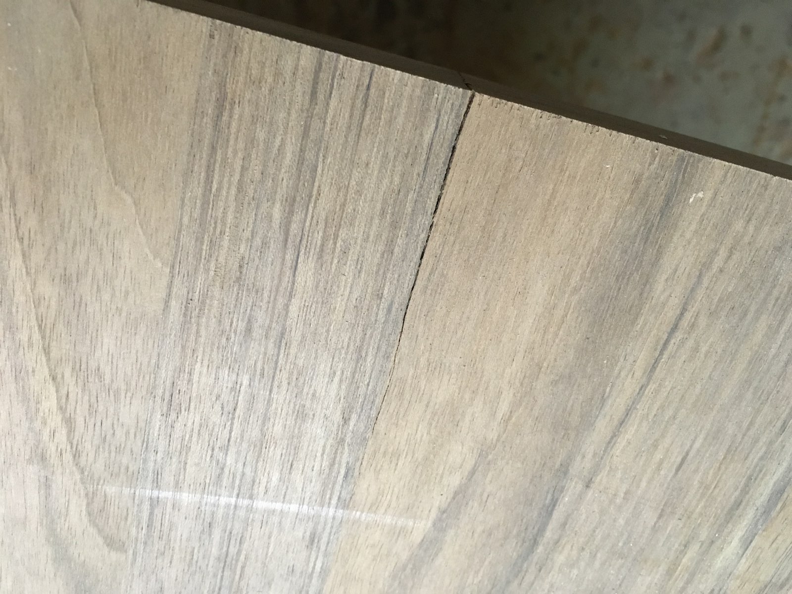

it has been unseasonably cold here (as it has been in other parts of the country, for sure) and we're experiencing some cracks in glued and single piece lumber that we've never experienced before. the attached pictures are some examples. none of the pieces that have cracked have been secured or have any finish applied, and all have been elevated off work tables slightly to allow for even airflow. most are in the path of our forced air heater but none really that close (halfway across the shop). the results (cracks) are new but our procedures, lumber sources, etc. are all the same. we do not have a humidifier and humidity levels have been dry for a couple weeks now. this would be around 15-20% humidity. this is our second winter in this location but our tenth year in business. the cracking problem has been limited to a handful of pieces. these have been a few different wood species and most have not been glued up.
1. are these cracks some how there and just open up as the wood contracts?
2. for glued pieces, like the pictures, the crack can originate at the joint or not, but does seem to incorporate some part of the joint in the separated lumber section. is this some sort of failure in our joint preparation? wouldn't the crack only open, or be in, the joint not properly prepared area?
3. is there an easy solution for these? will epoxy save the day?
thanks, and stay warm.

I'd say that any crack that only goes part way through a board, was there before the glue up. A structural or drying crack in the wood that you did not see. Be more liberal with you end trimming. The crack that runs on the joint is from improperly dried or acclimated wood, poor glue spread, too cold for proper glue setup, or poor joinery. Glue choice has nothing to do with any of the failures in my opinion. Consider your shop conditions, temp and humidity swings, and add a humidifier if the levels are too low.

To my eye the first photo shows some discoloration around the crack suggesting that was already there but enlarged when exposed.
Keep a drop cloth or use a piece of board to protect wood from direct forced air flow.
Let your wood acclimate in the shop before glue up. If you can't afford the 2 weeks of acclimatization then at least make sure that the wood comes to room temperature before machining and gluing. It takes a long time for wood to rise to temperature throughout. Glue joint will be weakened if the wood is too cold.
Have you checked wood with meter? In my shop (Ottawa Canada) the walnut I am working is below 5 percent.

To clarify my previous comment. Photo 1, preexisting cracks, (agree that the darkness in the crack indicates it was there previously) Photo 2 and 3, shrinkage or improper jointing and glue spread.
Do you have overhead heaters? If you are getting hot air and high air flow going over freshly machined wood and glue ups, you'll quickly see that cracking as shown in photo 2 and 3. Just because you've had the stock a long time doesn't mean it won't move when you blow hot, dry air over it.
