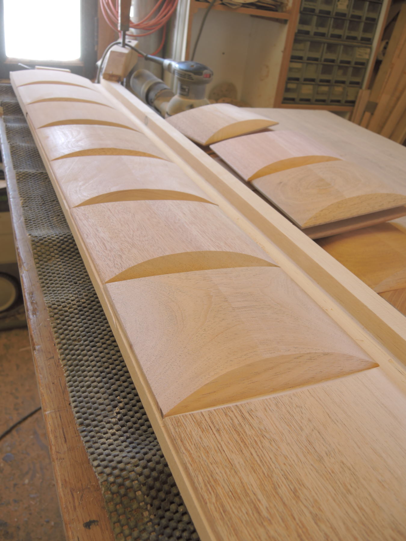

A holding jig was made for sanding with a R/O at 150 grit. It held 8 blocks at a time and in the window light, it was easy to judge accurately what was going on. They were fit onto tongues once again and then clamped to hold in the other direction.

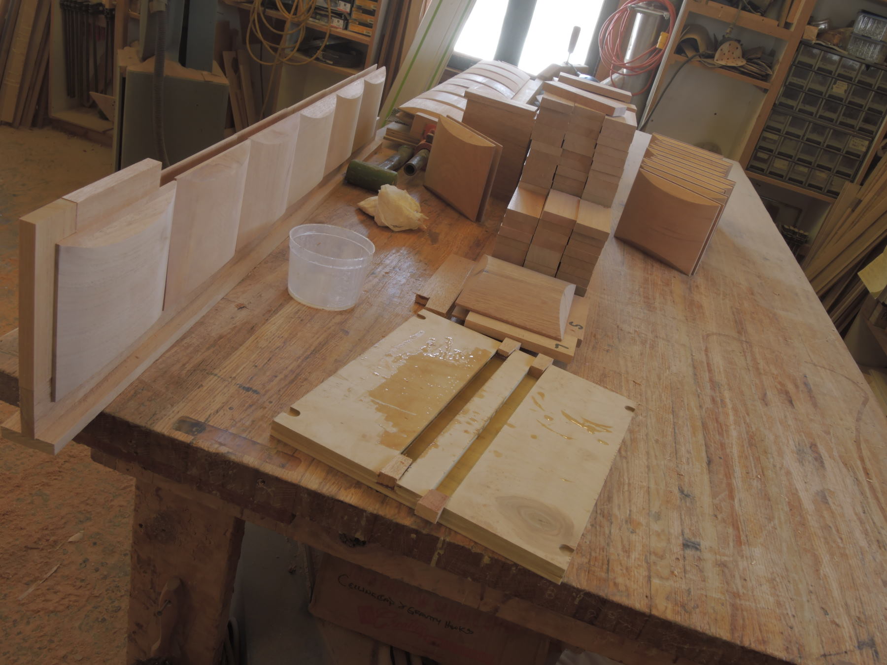

Splines were made and sized to be a loose, almost snug fit in the blocks. We planned on using epoxy, and it likes a thick glue line, so did not need to be clamped. So I built up a rail to hold the blocks vertically while I buttered the splines with glue and slid them in place. 240 splines, that is. They fit well and did not want to creep around as I laid the blocks flat to set up.

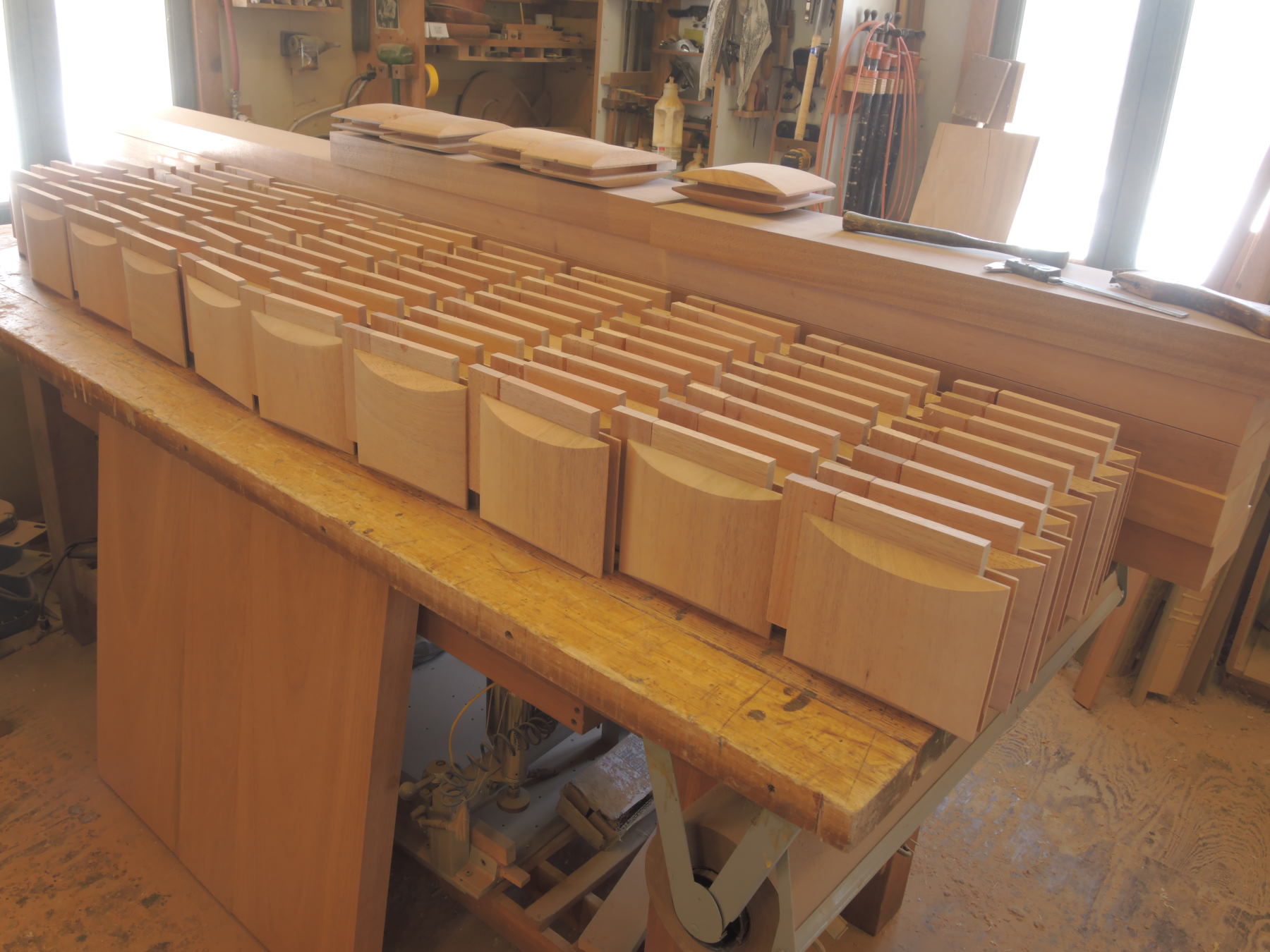

Looking over my shoulder, turning off the lights on Sunday afternoon, the parts were all lined up on the bench like so many dominoes. Sanded, cleaned up and splined, ready to be fit into a large panel and then into the door.
