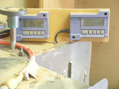

I am looking to setup two shapers with DRO units to speed setup times. I will be starting a job that requires multiple profile changes.
My question is, what brand have been tried and tested and any setup pitfalls that can be avoided.

We have several Accurate Technologies units in the shop. They have worked well for us.
We have them on a shaper spindle, works great. I am not sure how you would use it on a fence. You better get tooling made with the same diameter.

We also have the Accurate Pro-scales on anything we can. They are a bit pricey but easily worth it in time gained. The read scale needs to be located as close to the real movement as possible to get the best results. We can easily tune tenons from slip fit to tight fit with just the DRO's.

The pro scale is great but when we have an application that doesnt have the proscale in the budget we recently tried the igaging dros available online mainly used for milling machines. They display in .0015 accuracy and have worked well.
