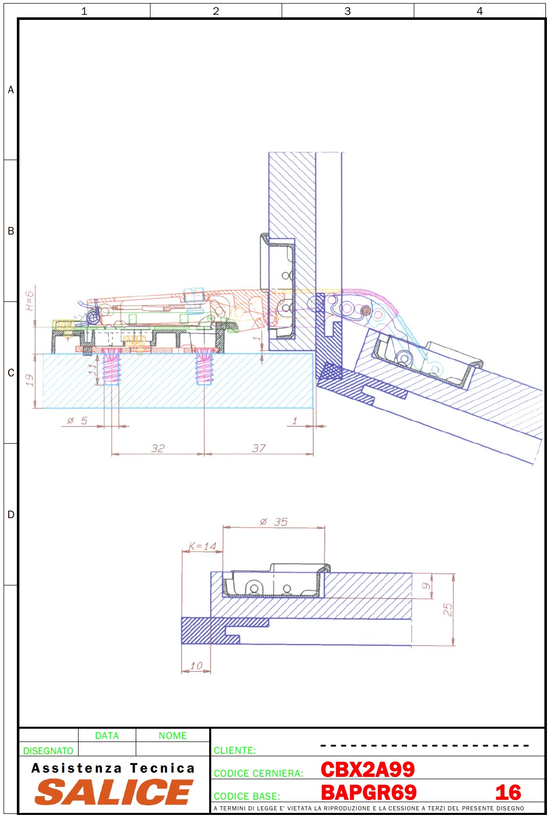

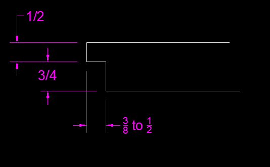

I need to find some sort of rear mounted cabinet hinges with no to minimal face exposure for the doors in the attached drawing.
These are inset doors but do not have the standard 3/8" x 3/8" edge rabbet detail.
Anyone have any ideas? Or perhaps it doesn't exist.
Thanks,

Salice makes a different articulating hinge that does odd things. I used them on a similar rebated door 15 years ago.

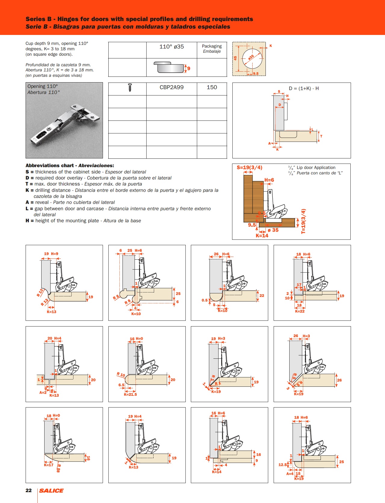

Hey BH,
Adam is correct. We do indeed have a hinge specifically designed for this application. This is the B Series hinge for profile edge doors.
Your local distributor should have them in stock.
Here is a copy of our catalog page showing this and an example of an application similar to yours.
Please let us know if we can be of assistance.

You're not at a dead end yet if you are able to block our behind the face frame flush then hinge the door like a frameless cabinet.
Dennis

I've been away from my computer for a few days. Regarding the Rockler platform, they have that piece made exclusively for them and only sell it as part of a kit that includes our B series hinge and a 6mm mounting plate.
We did look at producing this but the quantities to produce this efficiently are too large compared to the possible number of customers who would be using it. We simply suggest building the side flush with the frame.
Question #2: Larger end rabbet? I don't think that would help. It's not the rabbet that is an issue.
