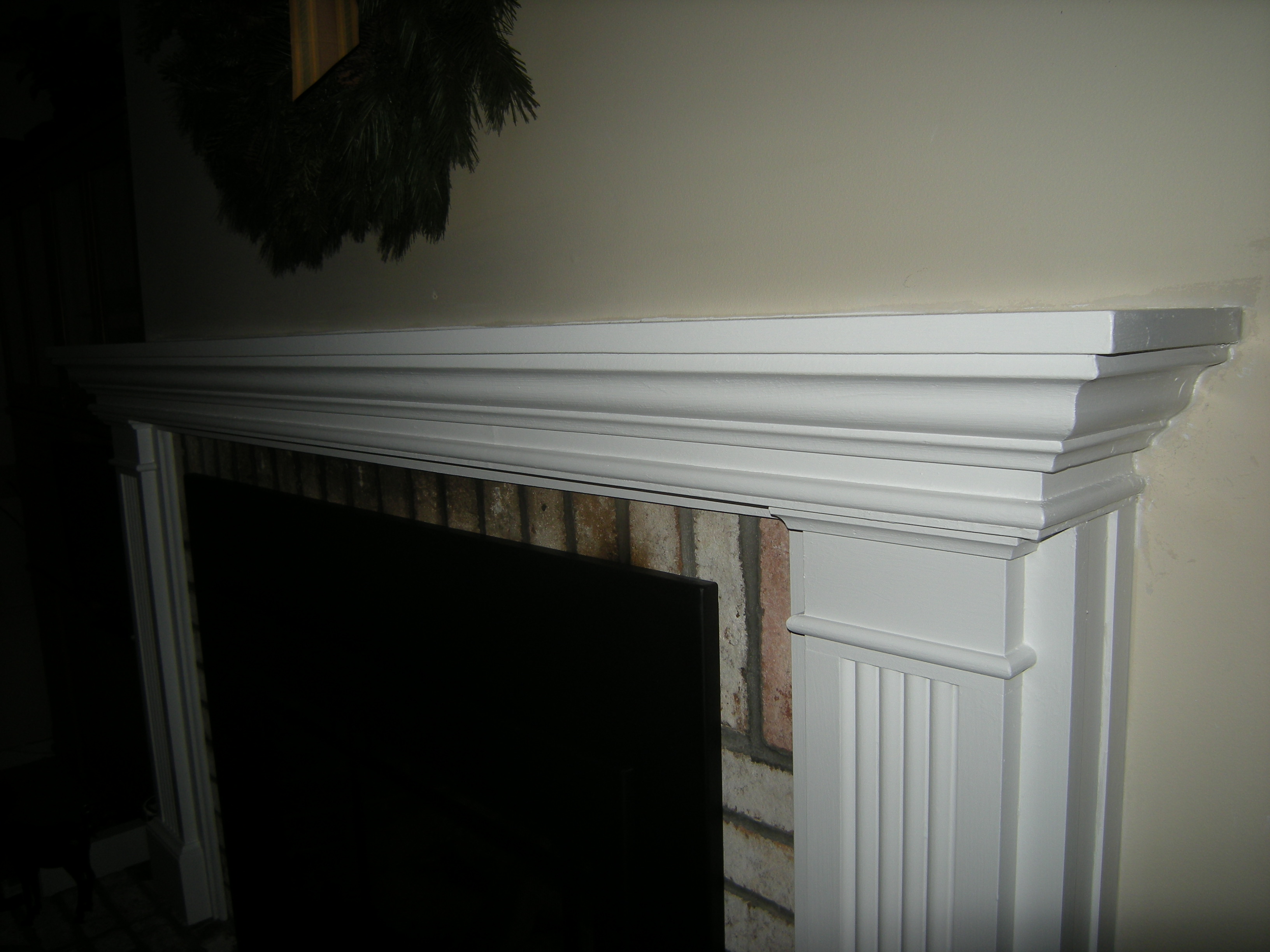

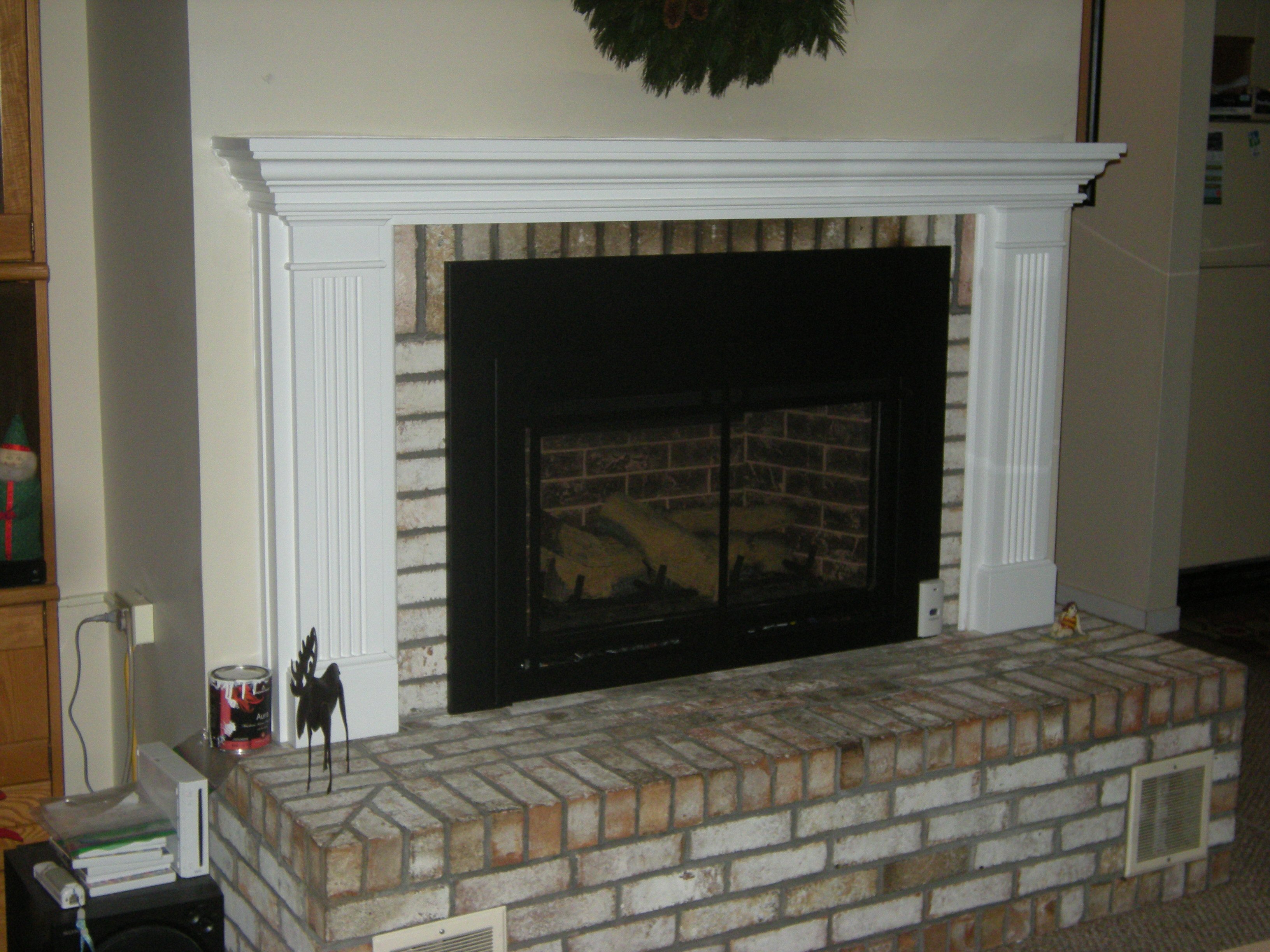

A couple weeks ago I built and installed this mantle in a neighbors condo. I've had experience with the gas fireplaces in these condos so was concerned about overheating of the mantle head directly above the firebox.
My solution was to use Hardie Trimboard and their 3 1/2" crown. This gave me a fireproof (but not fire rated as Hardie products transfer heat) mantle head.
The vertical side legs are made of poplar. All materials meet the required firebox setbacks.......whether wood or cement board.
I spoke with both Benjamin Moore and Sherwin Williams tech support and found that most latex paints are rated to 200°F before failure. I was also told that above that they could fail but would not ignite.
Has anyone else worked with Hardie or other brands of cement board for architectural detail work?

Oh.........I neglected to make one point I wanted feedback on as well.
I ended up using the best Benjamin Moore latex for the top coat. It was way too thin and runs while brushing it on were a significant issue. Then when it dried I had an extremely rough surface which you can see if you click on the image and blow it up. Next time I'm at their place I'll be sanding it out and trying to get a cleaner surface.
I think both the rough surface texture of the Hardie Trimboard as well as the issues with the paint caused this poor finish.
Any thoughts on this?

Now now David. Not every mass produced 1980's era condo complex can be developed as beautifully as your photos.....chuckle.........
And you are absolutely right about that fireplace design; it is just about gag me ugly. There are 24 of these in the complex which was built by a company with somewhat less than a stellar reputation.
I put a 100% wood mantle in another one of these units and it got so hot I had to have the gas fireplace installer come in, remove the gas unit and insulate the original wood firebox. That helped a lot. The problem is primarily the design of the gas insert units that have their circulation fans blowing into the top rail of the screen/grill door instead of through the screening. Very poor design. If it were not for those gas units a wood mantle would be fine.
I thought the use of the Hardie Trimboard was a clever idea when suggested to me by the gas fireplace dealer. It was certainly worth a try. As you well know a simple mantle like that........even made in cement board.......doesn't take long to build and install. It was a favor for a neighbor so money was not an issue.
The mantle does meet the 10" setback from the gas insert firebox and then some. That has a metal black surround though to fill the oversized gap of the original wood fireplace which makes it look like it does not meet the requirement.

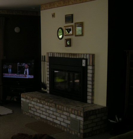

Here's what these fireplaces look like as built in the 80's.
View higher quality, full size image (445 X 464)
