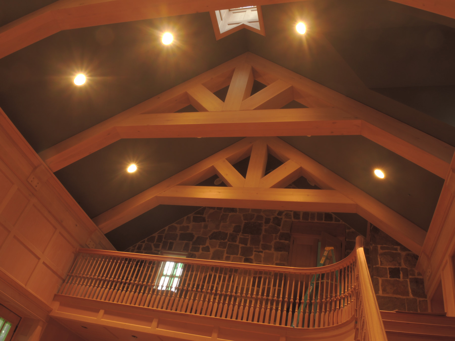

The beams in the photo have 18'+ long mains that are scarfed together. These were 6/4 and the corners were tongue and grooved. In Alder, the joints cannot be seen up close, much less down on the floor.

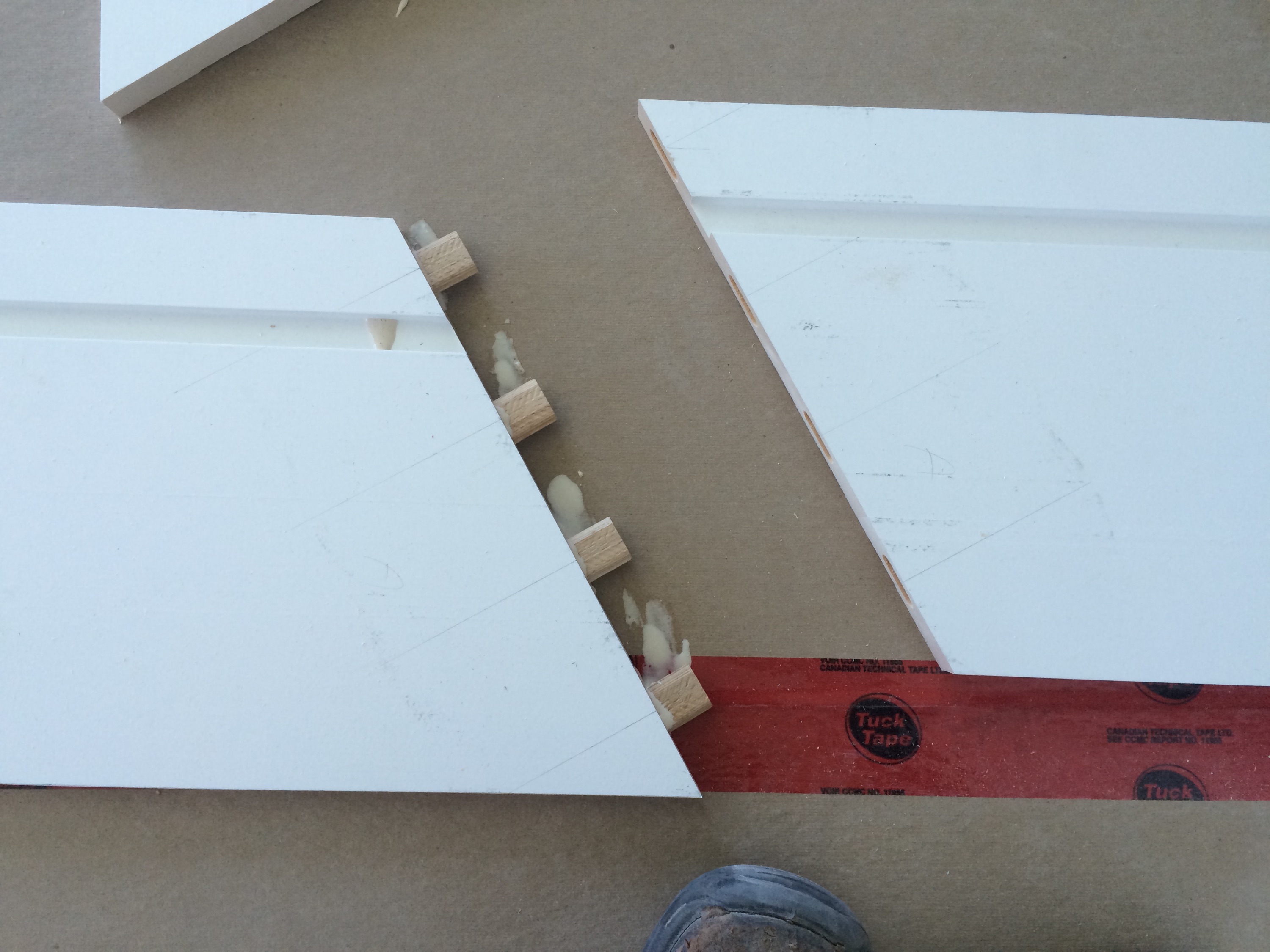

Not really the same, but we have used dominos for this type of thing on long/ wide runs of baseboard, it works well given enough dry time. We do a domino scarf hybrid!! The only reason I know this is pretty strong, is because one time I glued a few lengths together oriented the wrong way in a long hall, the painter helped me fish it out the balcony end for end nothing broke 10' each side of joint, also with dominos and the angle the joint just slides together when you tap the end, if you go too far tap the other end to get it back, we dont even clamp them!
