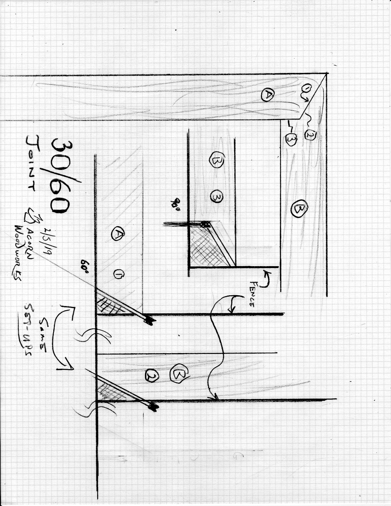

Does a lock miter work on a tapered leg? Having trouble visualizing how that would work.
1/29/19       #8: 1-3/4" Lock Miters ...
Nope. This is why we used a modified "60/30" joint. One edge surface is 30 degrees and the other is 60 degrees. This provides a ledge to pull the two pieces together in a positive manner.

Bruce H
David, do you have a photo of how you do this " modified "60/30" joint"
2/5/19       #11: 1-3/4" Lock Miters ...
Here is a section of the 30/60 joint in one inch material. All tablesaw, 3 passes, two on the same set-up. Hold material down and over for accuracy - Jointed materials and feeders or featherboards are required. A sacrificial fence is also needed so the blade can be run into it, past the joint cut.
