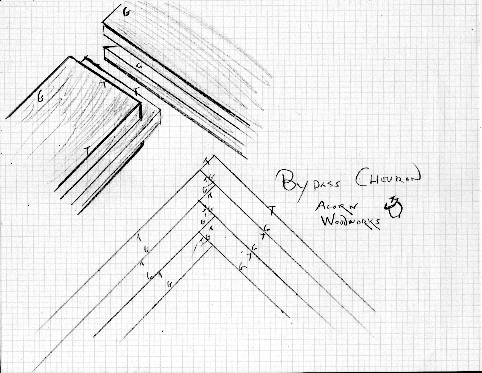

Could I expect a chevron pattern of mixed hardwood boards glued edge to edge , & end to edge, 3/4” to stay together within a grooved frame 30” x 100” , for a barn style door as said in previous post ?

Chevron or herringbone with the T&G and be done with a loose spline.
We did not feel like the regular T&G we milled along the edges had the strength to hold up in end grain, so we make a 1" deep plow in the ends of the boards, butter it up, and glue a spline into the voids, pulling the two ends close while the glue sets.
Instead of butting the two ends together, a 'bypass chevron' can be made. This can go together without extra joinery, as long as the ends are tongued or grooved. As and all the 'left; side parts are tongue and all the 'right' side parts are grooved on the ends.
All the above assumes the maker has the skill to make a basic door, and all the panel boards are not just going to be PL 400'd and pinned to a sheet of 1/2" ply.
