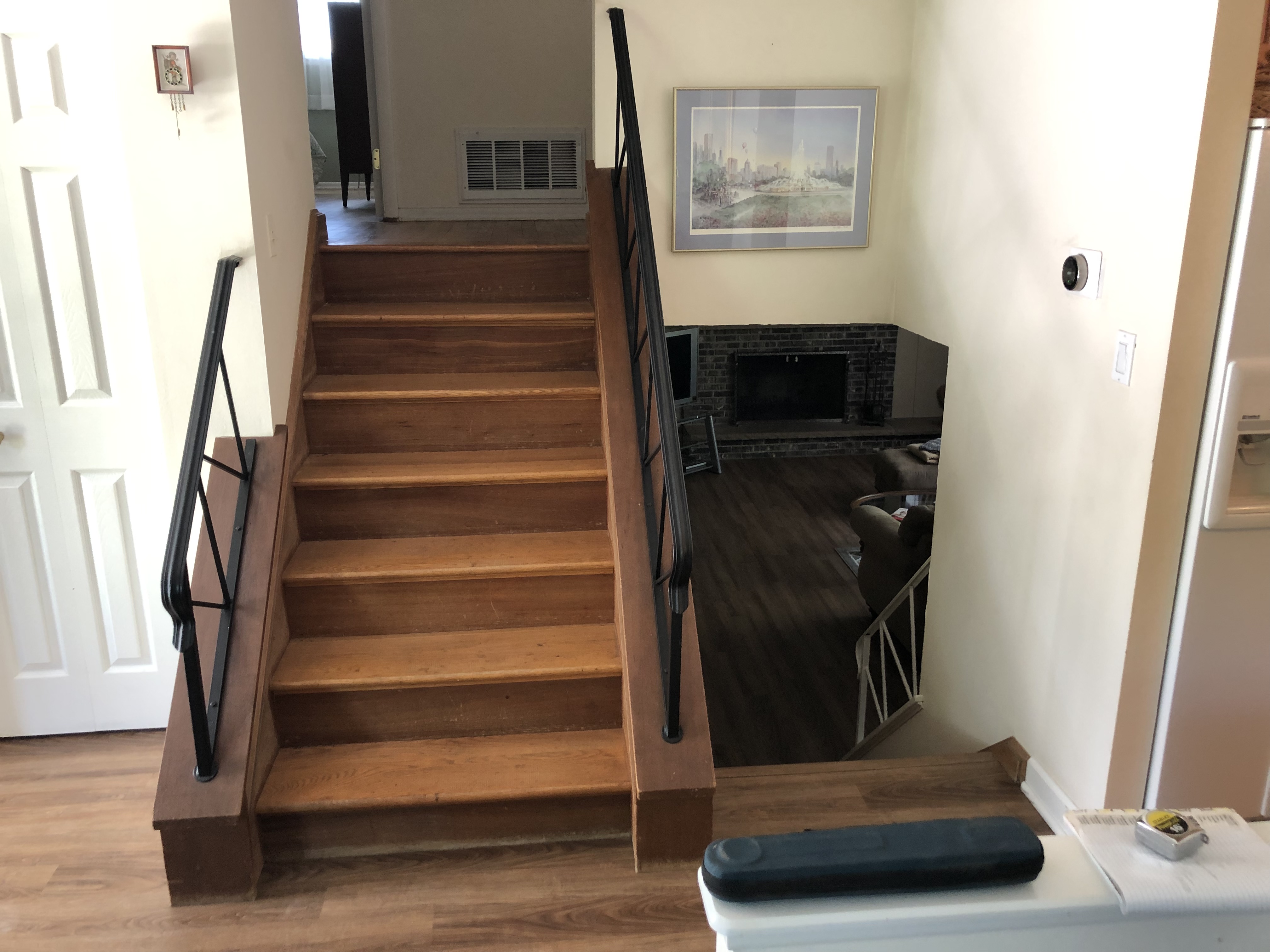

I have a customer wants me to install wrought iron spindles and they want a oak handrail for them. I went to Home Depot and Menards and thought they saw the 45° angle cap pieces which tighten up with the setscrew. The wrought iron spindles are square on one end and round on the other. One and or both sides needs to be cut off in order to be the appropriate height. I have a couple ?’s

I would check the building code on those balusters. Kids these days are getting fatter, but still, you would have to have a pretty big kid for them to not fit right through those openings.

No idea how that picture relates to your questions. There appears to be a lot wrong with those stairs in regards to being to code. Treads must be narrow as it looks like lots of scrapes on the faces of the risers. Hand rail spindle spacing is definitely not to code. I think you're getting yourself into a lot of trouble.

My take is that the photo is what he is being asked to replace.
I would scrap any pre-fab, home-center-type fixtures (set screw, 45 degree angle or adjustable angle). And just order in wrought iron balusters in a design they like and then shop fabricate a base plate to affix to the skirt cap in your photo and shop fabricate the handrail with corresponding boring as well. Newels get same treatment. Then you just pack it all to the job and smack it together.

Those balusters shown apparently are perpendicular to the base and top rail, aside from distance between them, seemingly big box horizontal flat intention. As to top handrail, one would think flush sunk wood screws into hand rail from beneath rather than Epoxy.

I could be wrong but I am under the assumption that the photo is the current state of the handrails, in which the customer is wanting to replace the assembly shown. Hopefully the original poster can chime back in.
