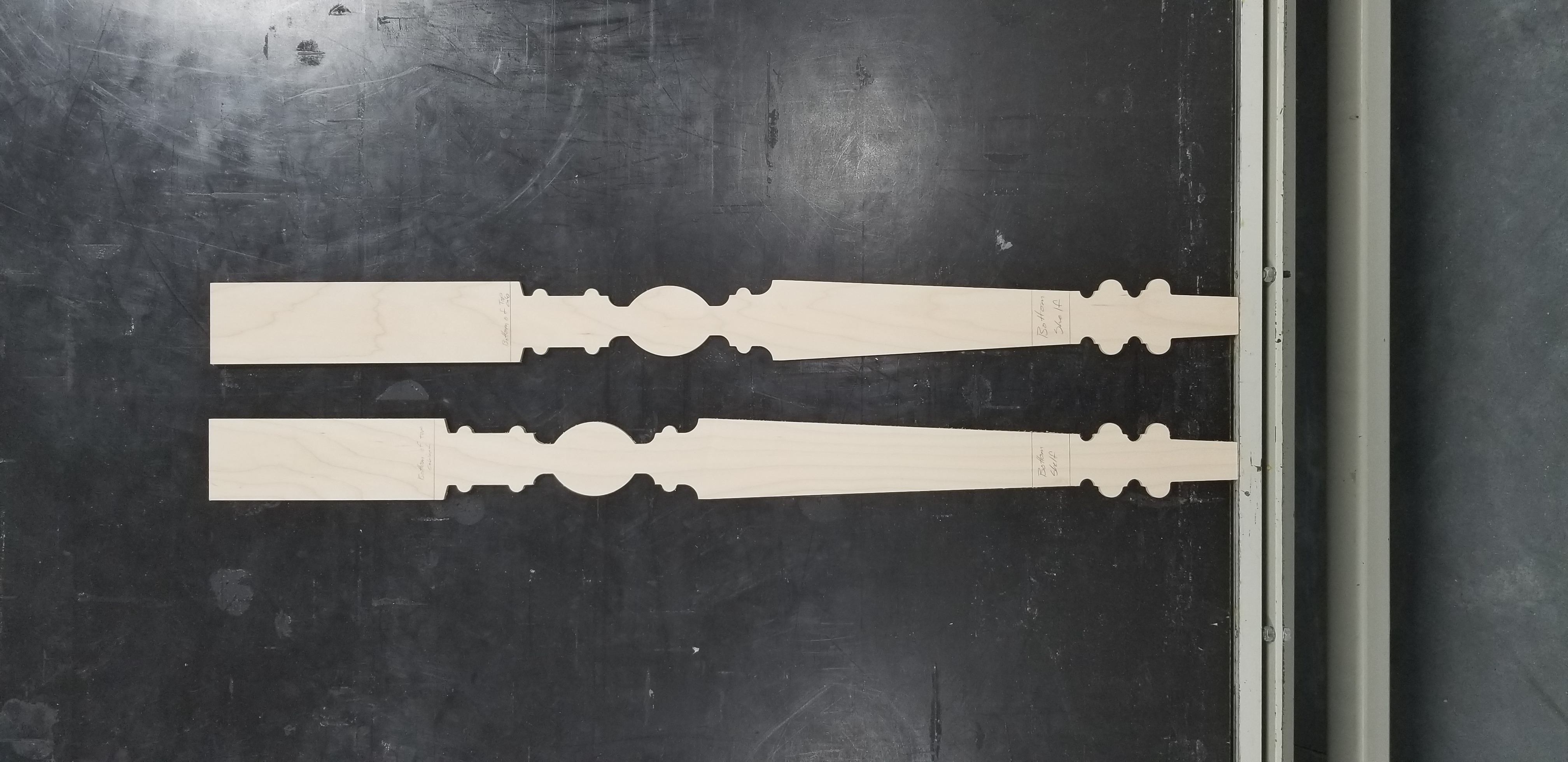

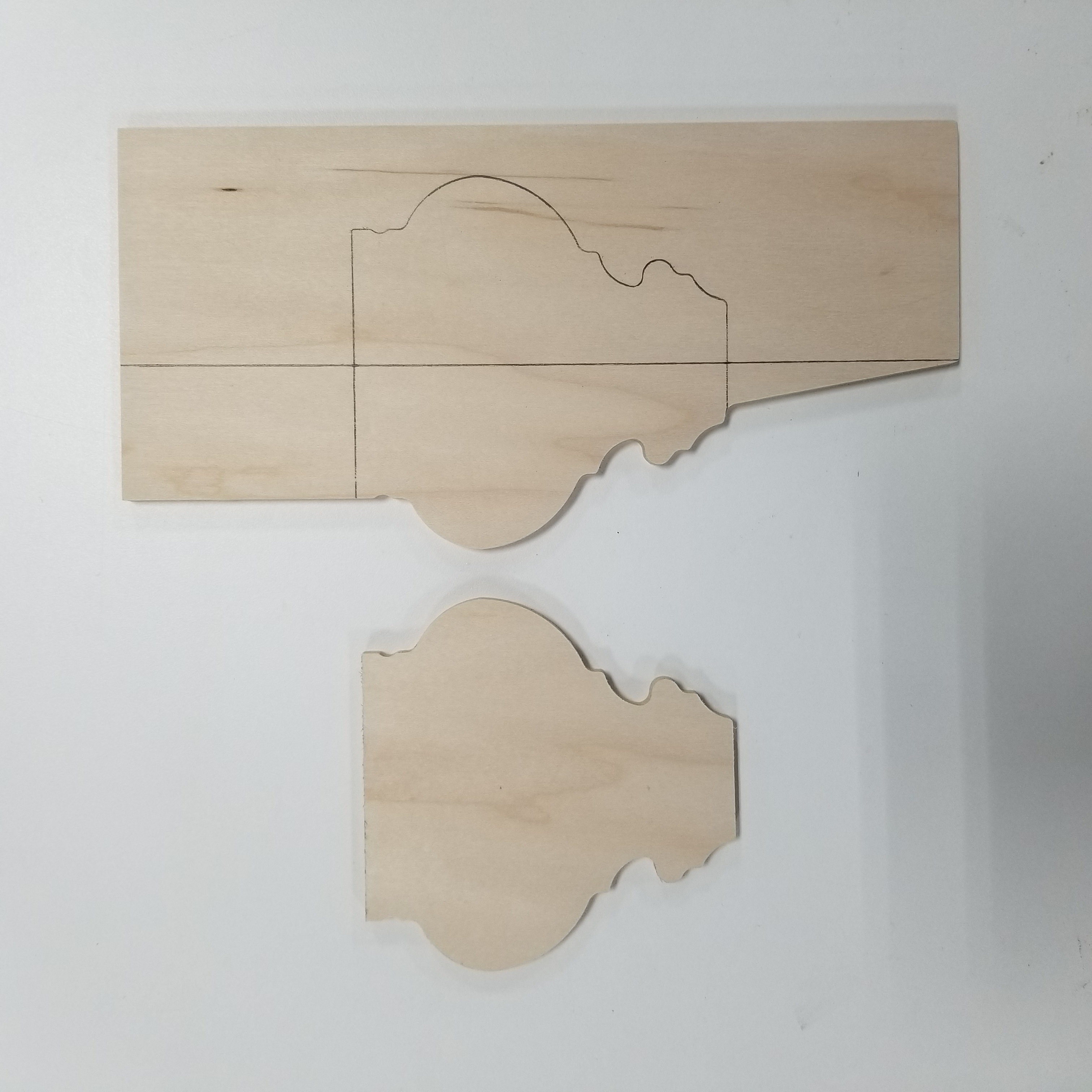

Just make one yourself? The dude that does our turning, all he needs is a piece of 1/4" thick whatever for the stylus to ride on. I stayed making the templates on the cnc just so I could save them digitally and not have to save a bunch of wood templates that will likely never get used again.
View higher quality, full size image (4032 X 1960)

we've made them from acrylic and wood, but the "real" guys are using thin steel cut on a water jet or plasma table. reach out to some metal fab shops to see if they can help.

I have seen 1/8" to 1/4" aluminum used for templates. Cuts easily on the bandsaw, and files nicely.

I like your ideas and will try cutting some out on the CNC and I have tried cutting one out of aluminium already and it worked quite nicely.
