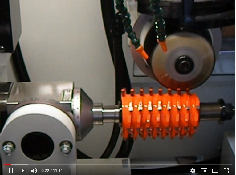

Most grinding shops in the U.S. will have an NC controlled tool grinder to sharpen these. You sharpen on the face as you can see in the video link below of an UTMA LC35-NC Grinder doing it.
View higher quality, full size image (766 X 569)
https://youtu.be/6p28ibdDzQk

Thank you David. What kind of grinding wheel is used to grind the face, as shown in this picture?
4/20/20       #4: What is the method to sharpen a Car ...
David Rakauskas
A six inch diameter, 12V9 shape Diamond wheel if its carbide teeth (90% of the time). CBN wheel if they are tangtun or Janalloy teeth (10%).
