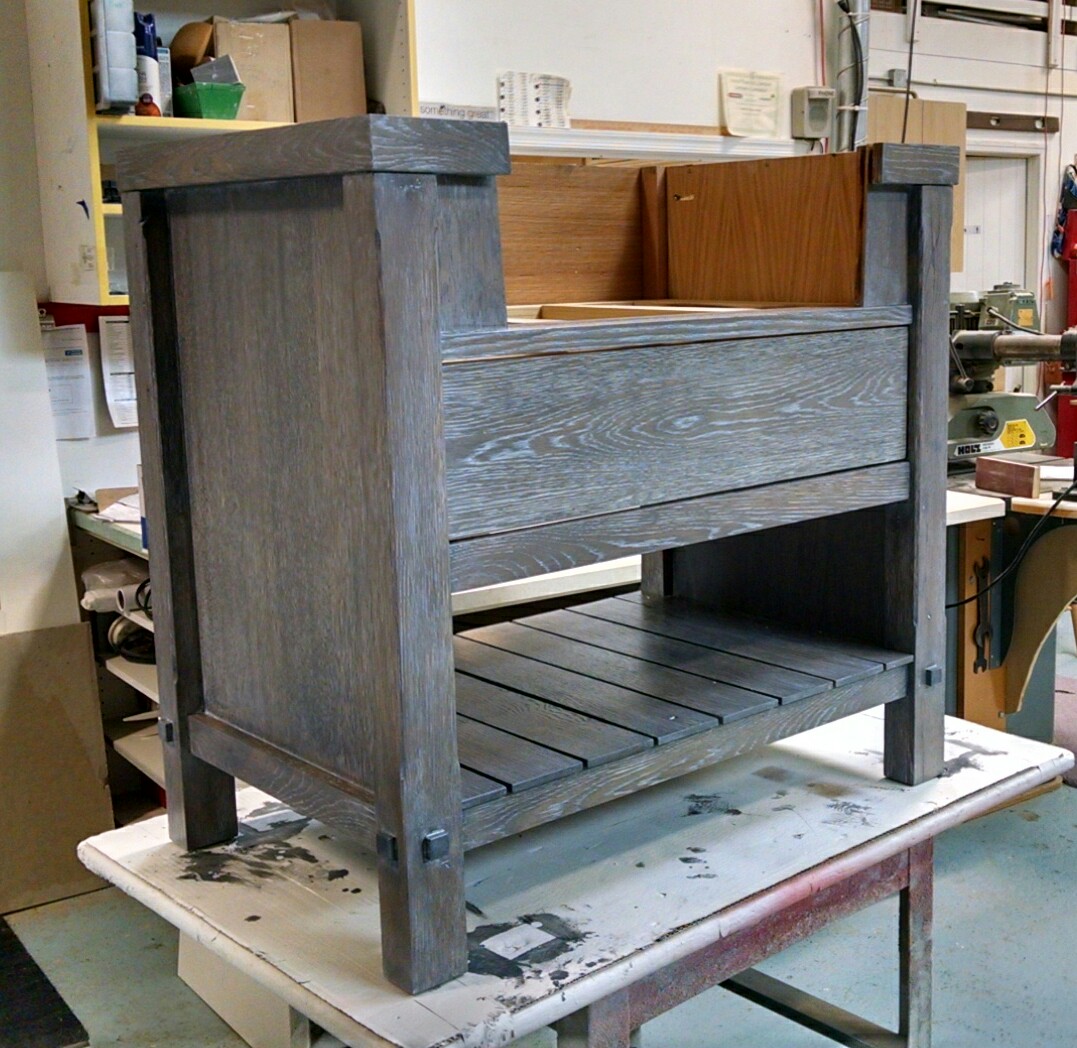

We have had a 9741 Makita wire brush sander for a couple years. Works for us on the occasional job. We do a lot of rustic floating shelves with it. Edges and faces
We actually do quite a bit of MDF core Rift White oak , I get shop grade when available. Most jobs get finished with glaze to hang in the recesses.
All parts get wire brushed ,finished flat panel. Flat Conversion Varnish topcoats.
It does get to be a bit much on larger jobs . The home office took one guy all day to do and it is best to just have one guy do it for consistency. Like anything - Upcharge for special finishes !
Buy it - Not cheap - you'll still need it for what you can't send thru a big machine. But it's not 20 k either..

Had to shrink down the pic to attach. Several more cabinets to the left...
Was about 10 sheets total ,50 bd ft 4/4 solid

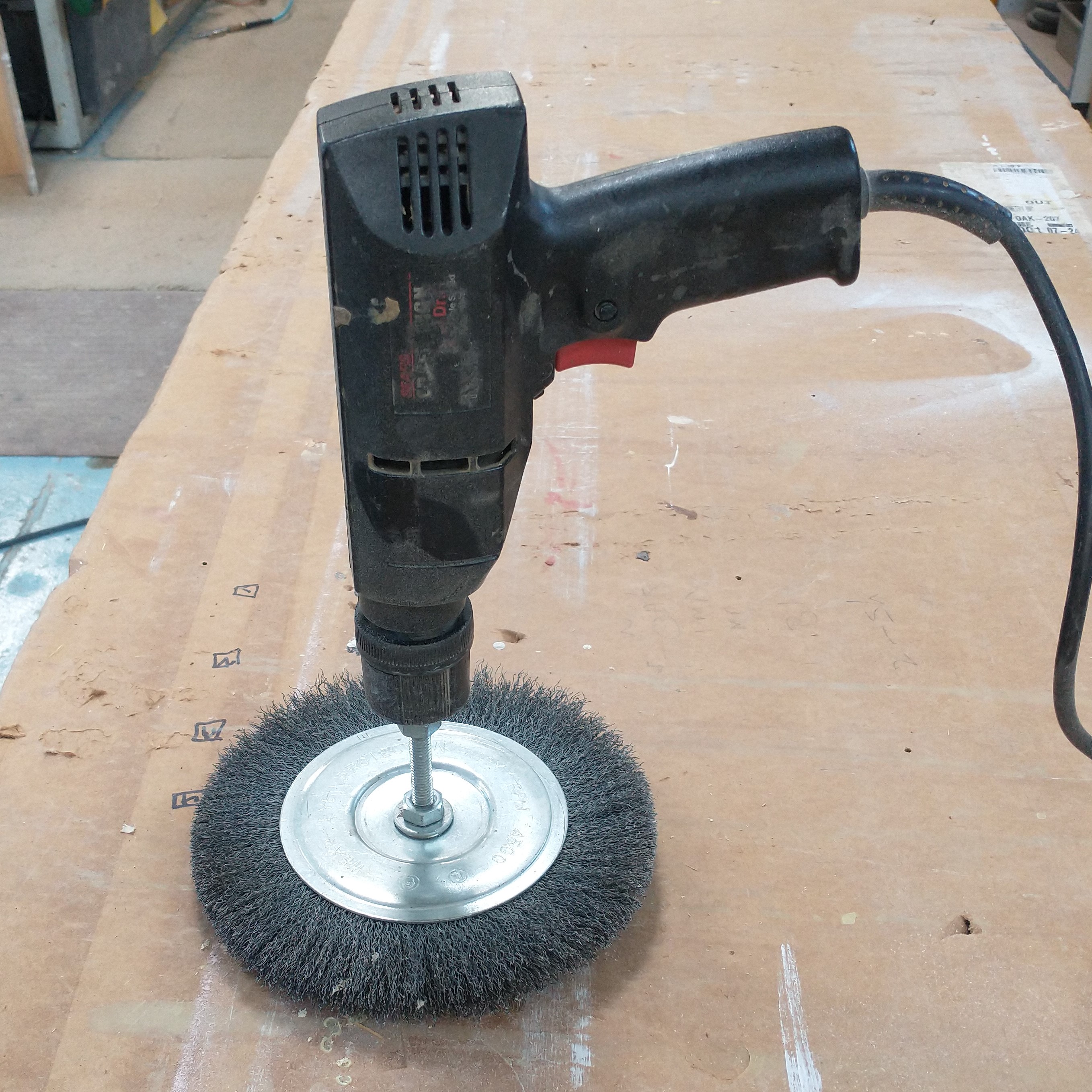

Sorry for the slow response guys.Covid labor short with a guy out. Shop foreman before Christmas had knee replacement surgery out for the next couple months. Been out in the shop a lot, should be posting a help wanted ad on wood web instead of responding to threads...... Al, we started out with the wire brush for the first couple years, bought the 100 grit nylon brush. Thought that would get me more texture. Really need to get the 80 grit one instead.We do not do a lot of prep sanding. Wide belt to 80 grit,Mirka heads into 120 real quick before starting with the Makita.
The Google- Barn Beams - cleaned up dozens of them --Exactly !
The Porter Cable is a toy compared to the Makita, smaller diameter and not as wide.Only really order them online., the brush only has a 12 mm hole. Finish schedule after wire brush stain, catalyzed vinyl sealer, quick light scuff, solvent-based glaze. 1-CV flat top coat..
I also order Conestoga doors with the wire brushing , not worth for me to do at what they charge..
Pic of an 8" Wire wheel on a drill- use for moldings and edges.

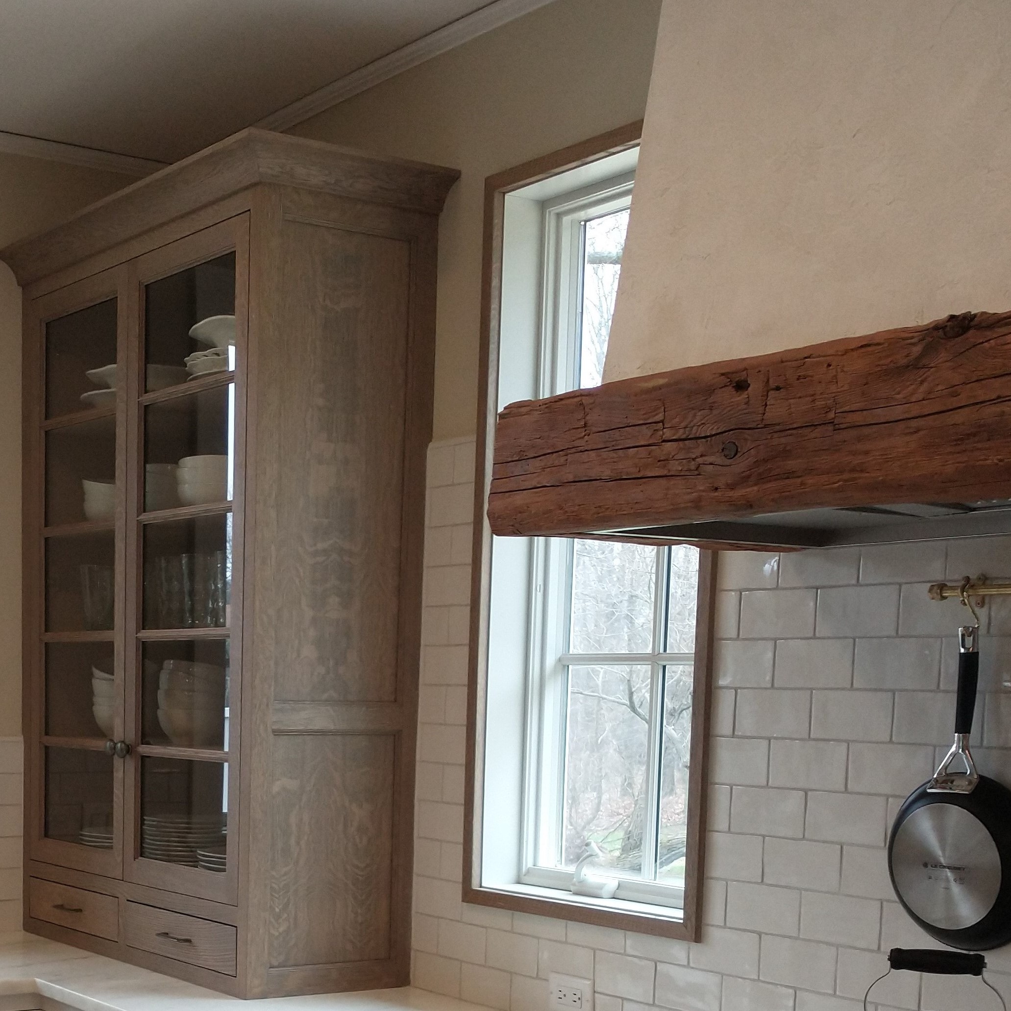

Pic attached
