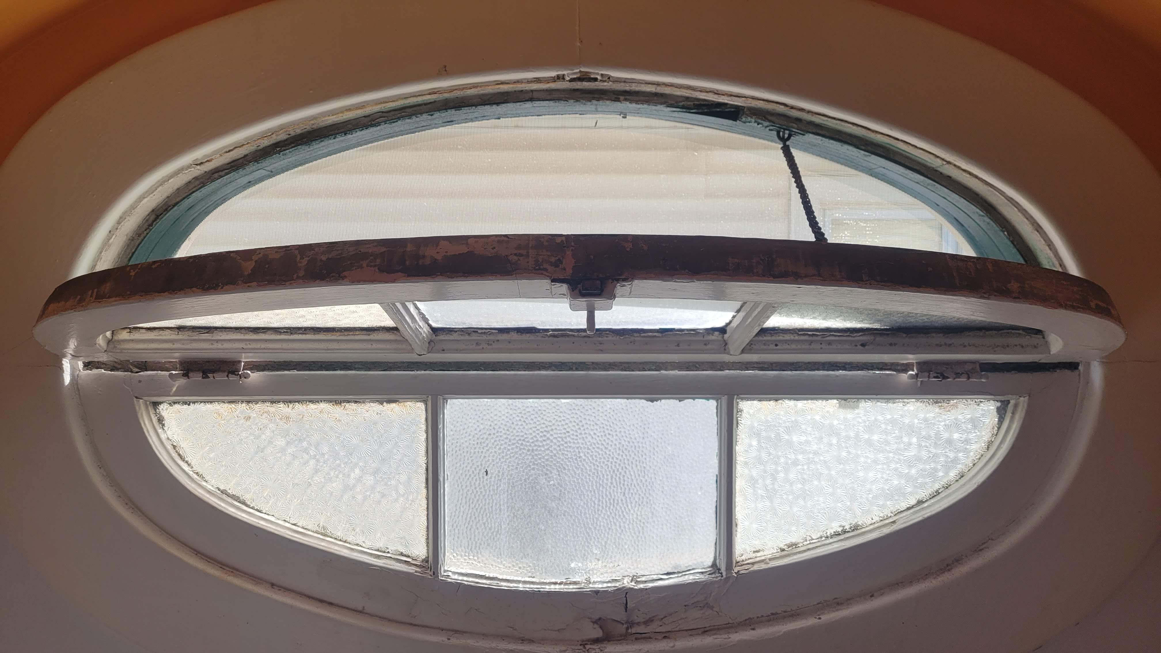

I got an inquiry if I could repair two oval windows. Having never worked on an oval window I was intrigued so I went to look at them. They are true divided lite sashes, and the upper half of each is hinged and tilt inward. The bottom curved portion of the sash and the bottom half of the curved case molding are decayed and need to be replaced. The lites need to be re-set in the sashes, and everything needs new paint.
I'm more than capable of doing the repair work but I'm not sure how to remove the sash. The outer case molding looks to be nailed on in the usual manner, I think. Assuming that's correct and I get it off w/o damaging it, I'll be looking at the sash in what looks to be brick layed jamb. So, to my question. How do you think that the fixed lower portion of sash is held in the jamb? Just nailed in or would it be something more sophisticated?

9/6/21       #2: Oval Window Repair - Advise Please ...
John Member
No one here has ever worked on an old oval or round window? OK, if you were to build a new one how would you set the sash in the frame?

BH Davis  Member
I have to assume the hinges are on the horizontal straight section (center rails) between the upper and lower sash. That's about all I can assume from your description.
You are right that a photo would have helped a good deal.
To make the window "right" for that rotted lower half there either would have been a rabbeted jamb with a stop on one side or a stop on both sides on a non-rabbeted jamb. The upper operating half of the oval would have been missing the upper, inner stop, or it would have been a false stop attached to the inside of the half oval sash. If built like that then there would be no need for nails or screws coming through into the edge of the sash from the outside of the jamb.

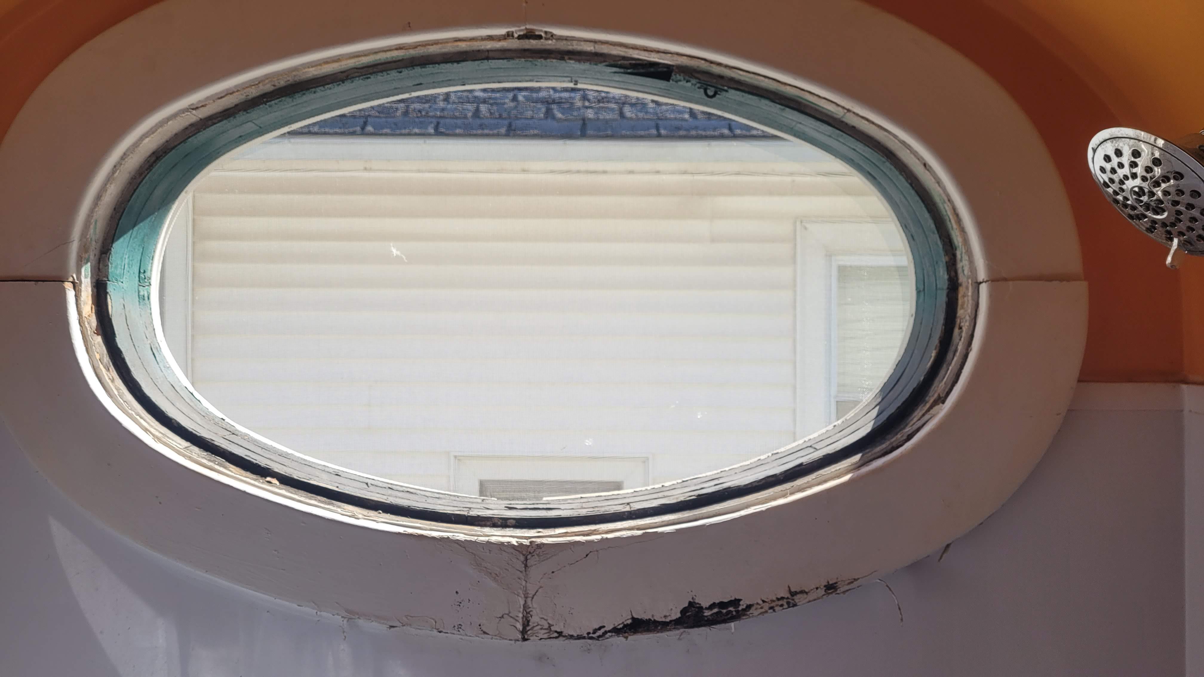

John Member
Thanks for you input, BH. Turns out, it was pretty simple to remove. The sashes fit into a rabbet on the inside of the brick laid frame.
After removing the hinges I lifted off the upper sash and then cut through the paint and caulking between the lower sash and frame with a utility knife. A little wiggling and I could tell that it had been nailed to the frame near the top on both sides so I cut between the sash and frame with my multitool. A putty knife and small pry bar freed the lower sash w/o drama. The case molding came off with some gentle prying. Now for the repairs.
