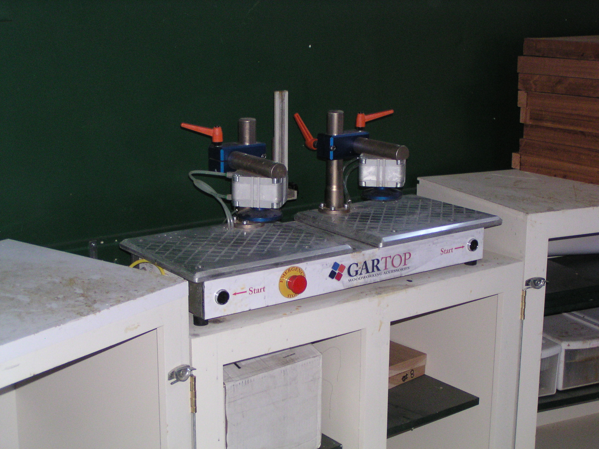

Although I think it is no longer available Rangate used to sell a pneumatic machine that did the job. It had a double table with a gap between the two sides. One side was fixed in place and the other moved towards the fixed side by air pressure.
You air clamped one arch segment on the fixed table, and the other arched segment on the moving table. Pressing the activation button brought the moving side into the fixed side, thus pulling the two sides of the joint together. You had to leave it like that until the glue set, or use a wood welder like the old Workrite units to set the glue.
Of course there are many other creative ways to pull this off with clamps and home made fixtures. The pneumatic unit above though is the only machine I know of that was specifically designed and sold for his purpose.

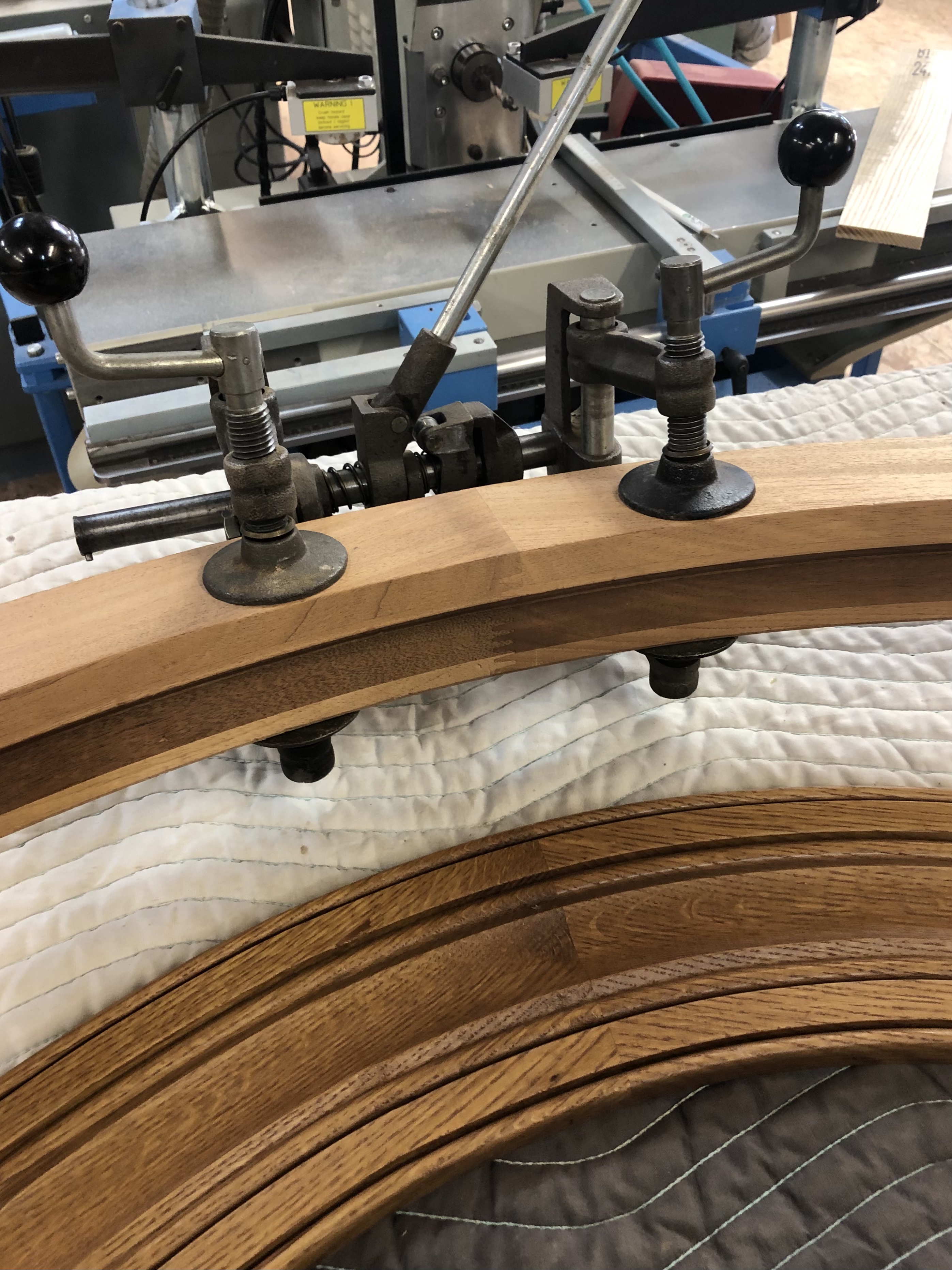

I had the Arch Press BH mentions. They are no longer made but Soukup makes one. See link.
Since semi retiring and scaling back my work I found a old European hand clamp for this and sold the Archpress.
I have looked for a manufacturer of these in Europe with no luck.

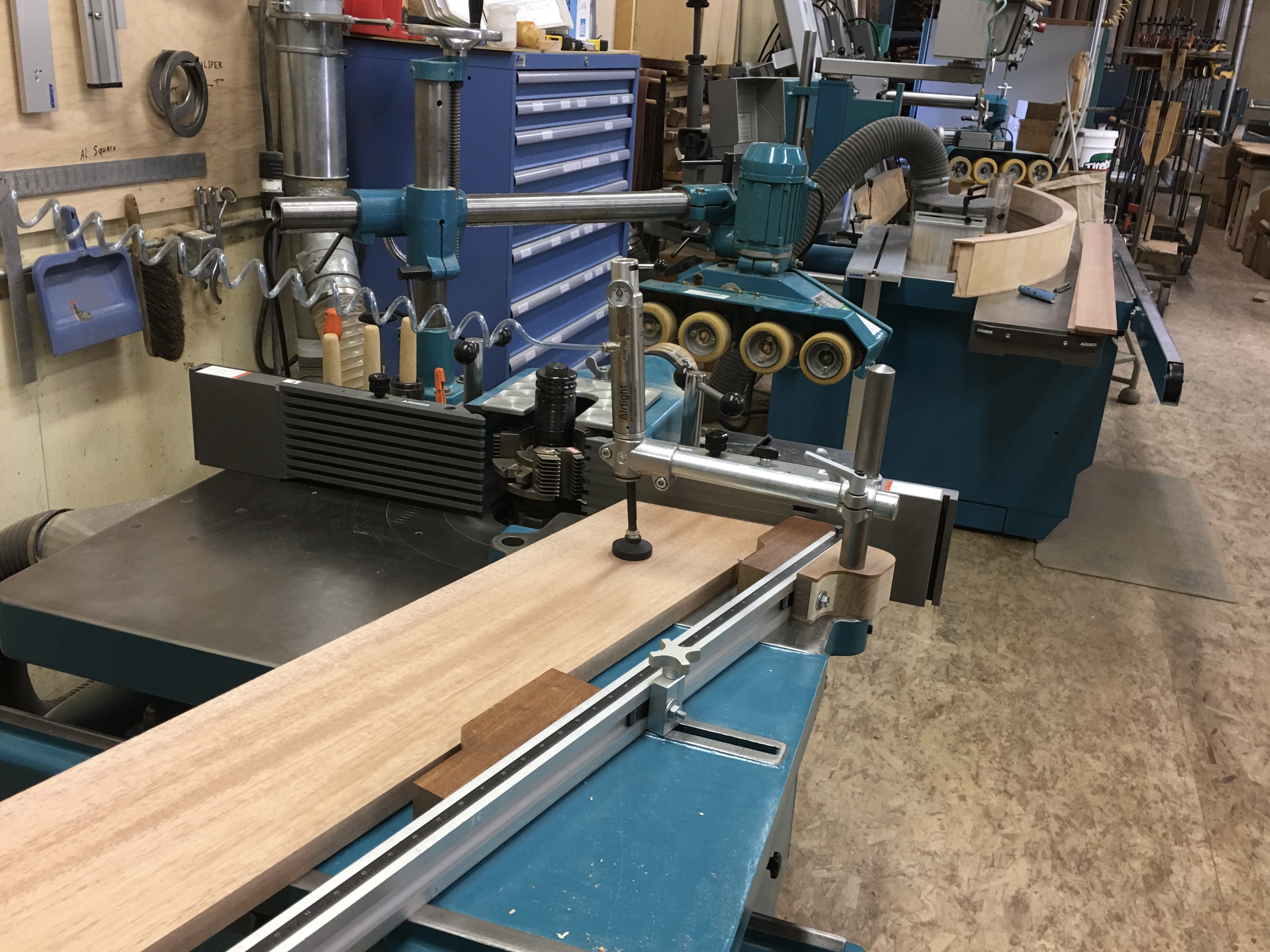

For tooling I use my old Garniga adjustable finger joint cutter. 14mm to about 100mm thickness possible. Rangate sells a newer version of this made by Zuani.
View higher quality, full size image (2794 X 3725)
View higher quality, full size image (3752 X 2814)

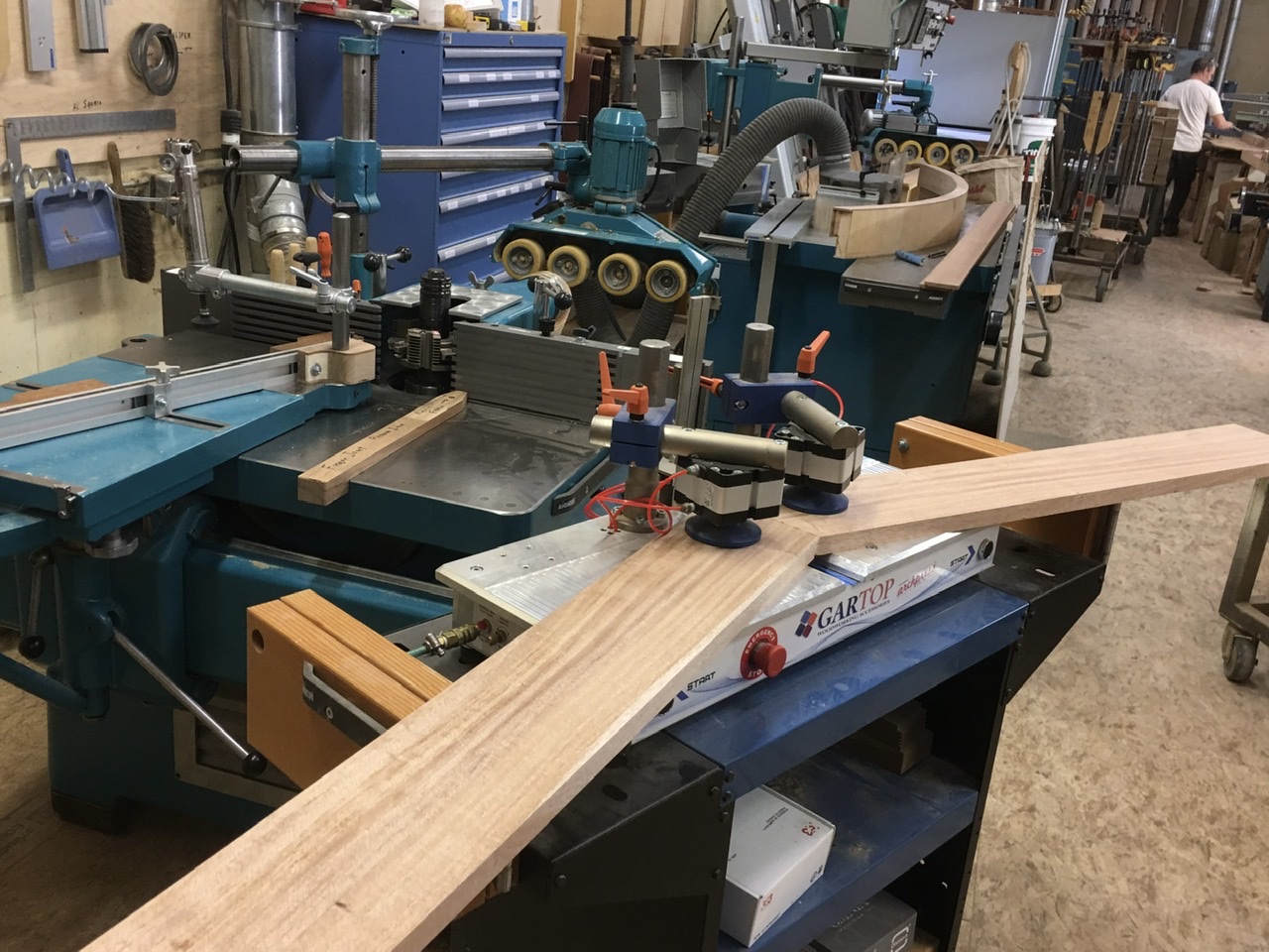

Couldn't find a photo or reference to this machine online but finally thought to look in old insurance photos and found it.
The pneumatic press I was referencing above was the Gartop Segment Press. Photo attached. This is a great solution if you can find one.
