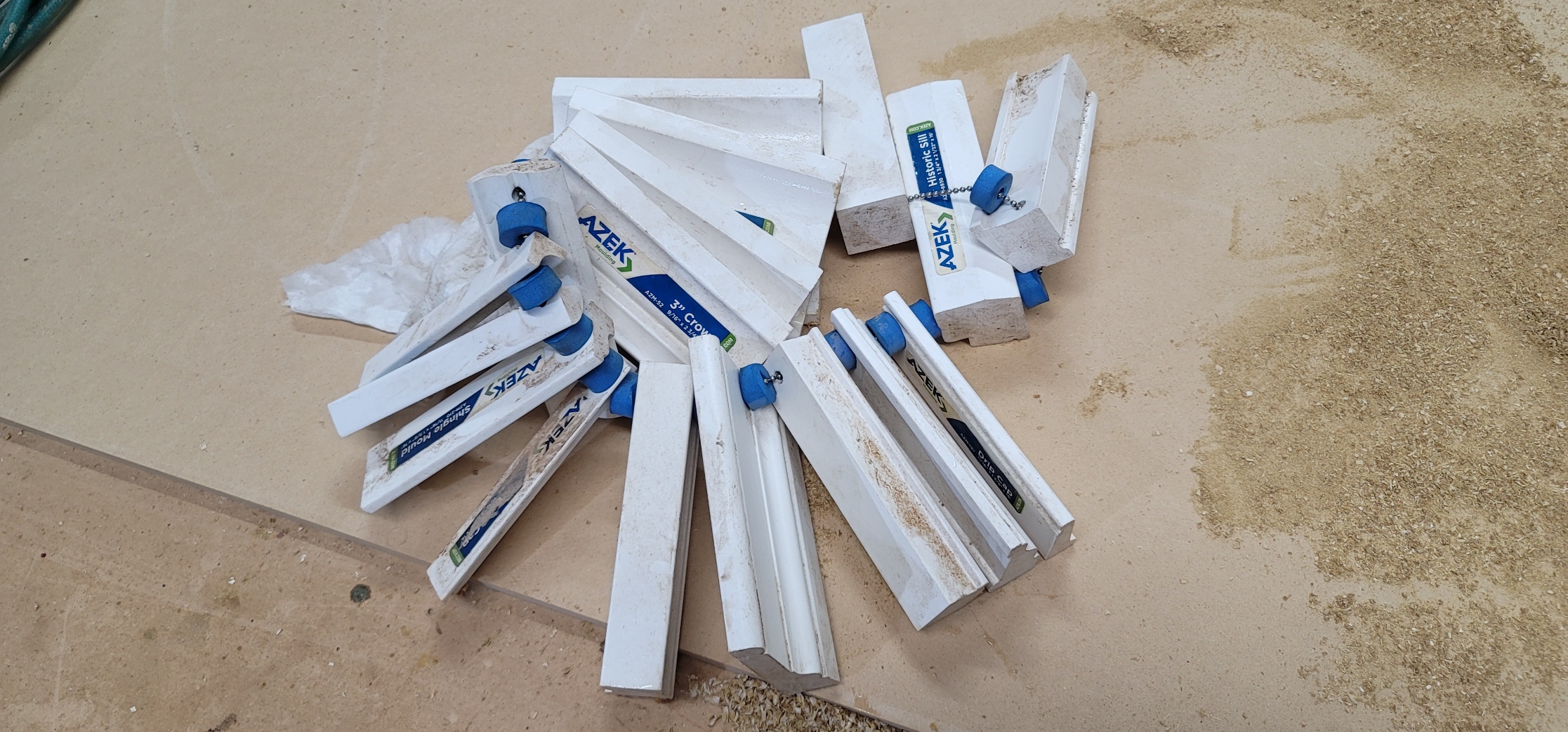

Ive run a ton of PVC, Royal, Azek, Versatex, etc. Im assuming the profiles you have to match have no mate from Azek or others? If you dont have a full molding profile chain from Azek, contact them ASAP and have them send you one to see if they even have a few that will save you running them from raw. Their moldings are all extruded with the standard dead smooth exterior all the way around.
For machining profiles on the shaper/saw either go to the dollar store and buy a few cans of static guard for clothing, or order some machinery anti-static spray (high priced version of the same stuff) and spray down your machines, fire up the dust collector and let it suck up a bunch of the static spray. It will help a mile with not winding up looking like a snow storm blew through the shop when your done. Keep the cans handy and re-apply as needed.
Sealing up the raw machined moldings is harder than finishing wood moldings which is why I say to see if any profiles are available in stick form before you resort to machining it all. If you can even rip elements off factory run profiles and toss the unneeded portions you will be way ahead as compared to having to prime/scuff/paint the machined profiles.
View higher quality, full size image (2233 X 1043)
