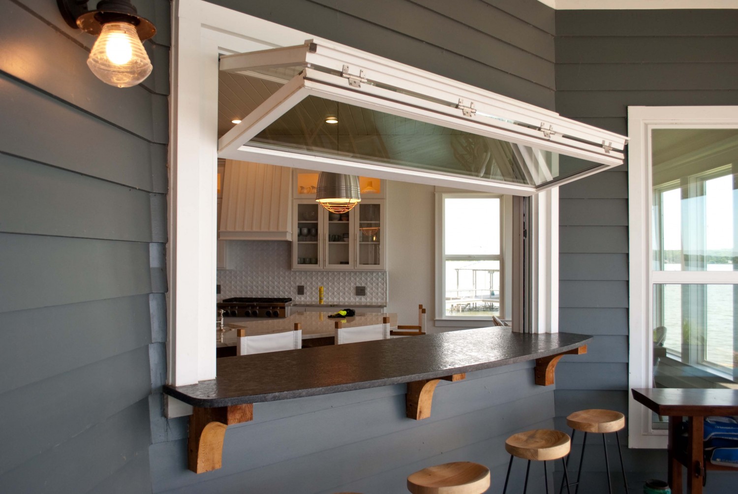

I was asked to quote a fold up window, basically a horizontal bifold where the sashes fold up into the room.
Is anyone familiar with what balance/mechanism is used in the jamb for this style of window?

I've tried many searches and haven't encountered the right hardware, maybe I'm overlooking something. All the hardware I've seen is for traditional bifolds that fold and slide to the sides of the opening. The style I'm looking for folds and slides up the jamb, I assume the balance is integrated into the sliding mechanism.

Oh, that is different than what I was thinking. I’m not familiar with that one. I wonder if you could use weights like a traditional Double hung to lift the lower sash?

I've considered doing that because it wouldn't be too hard to fabricate the sliding track and tying it into the sash. My concern was trying to figure out how to size the balance so the function is smooth when the window is opened and closed and it stays put at any position. It's easy to size the weights for a double hung, I can't tell if having the sashes fold up to one side where the weight is off center would need additional force and if so how much?

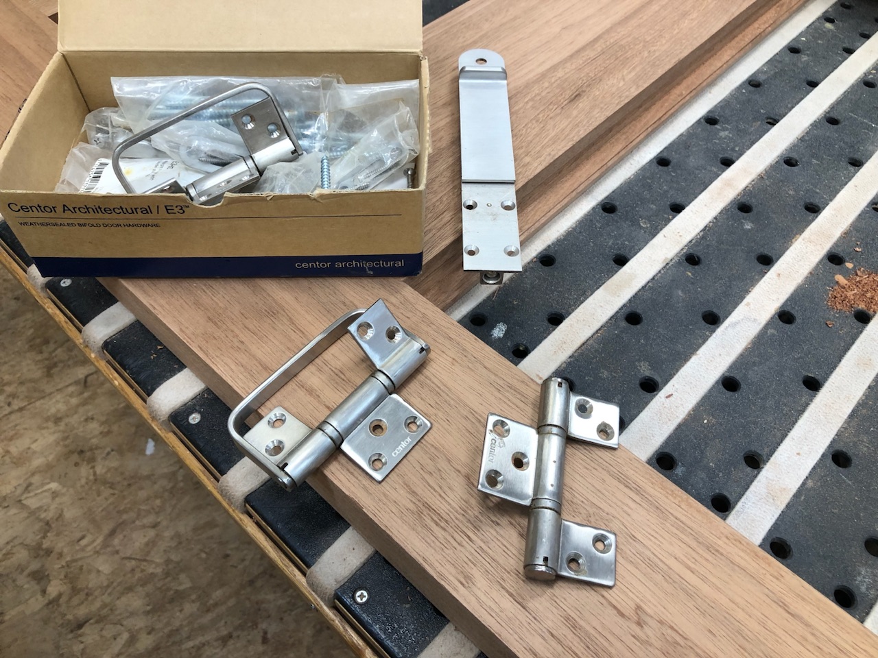

A challenge for sure. Looking closely at your picture those look like Centor hinges and possibly a spiral balance in the jamb. Looks nicely done whoever the builder was.
