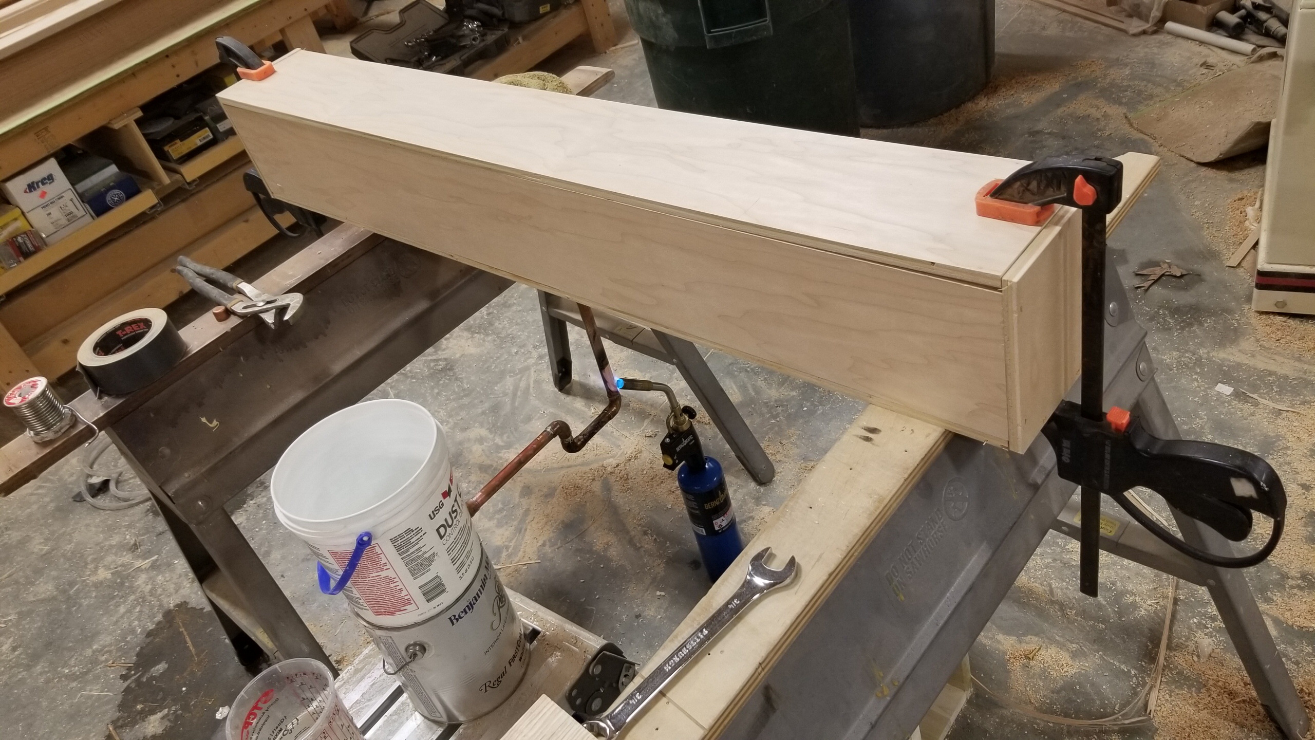

Wham bam thank you ma'am steamer. Needed to steam a couple pc of oak and came up with this setup with stuff I had in the shop. Steam about 1 hour per inch of thickness according to what I've read.

Hardwoods tend to steam bend well. Green or air dried wood is preferred as opposed to kiln dried. you can make a steam box out of plywood or heating duct. Just need to hold your piece kind of in the center of the pipe so the heat/stem can surround it. Thinner pieces will steam faster than thick ones. It takes a fair amount of steam to get everything hot. If you can handle the wood out of the steam box without gloves it isn't hot enough.
