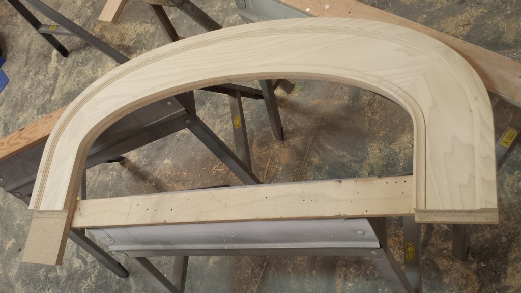

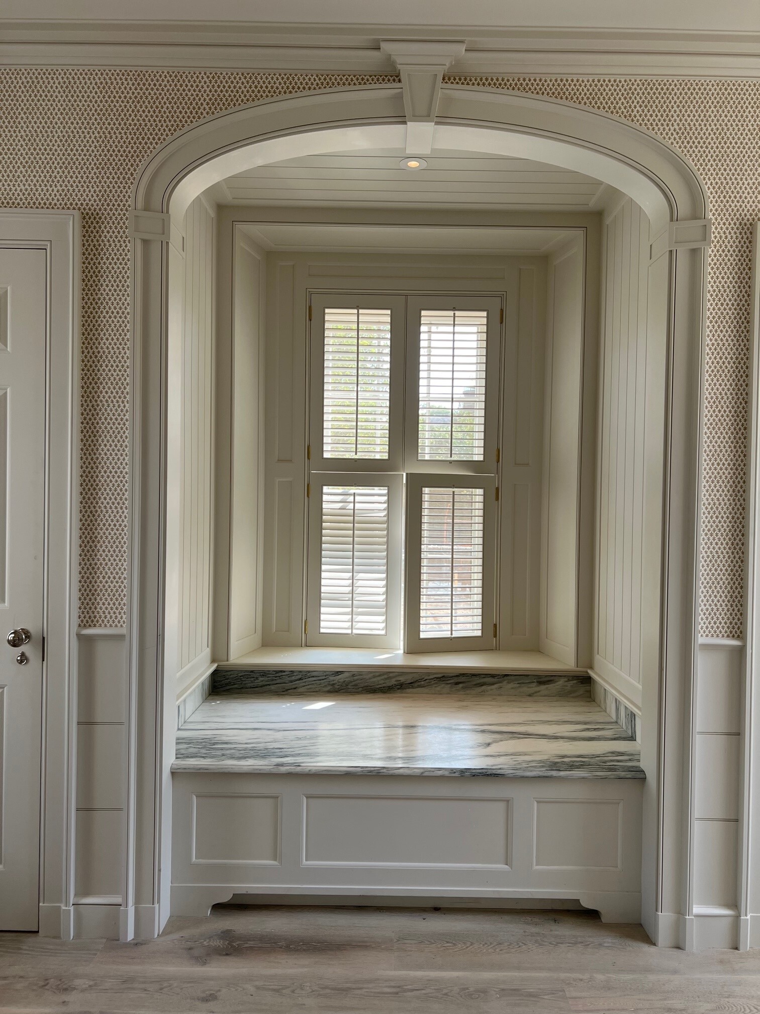

We switched to carving curved and elliptical casings many years ago to get away from the distortion inherent in using moulder knives. Curious as to what others are doing for their work. We are a high end architectural shop.

I've never really noticed the distortions in the curves. But that can really depend on the molding profiles. Very bold profiles with larger hills and valleys will show up on tight radiuses. I've never carved one out and have some somewhat deep profiles. Nothing really exaggerated though.
If you want to get away from carving a CNC would do the job. Or even have the CNC rough the blank out and finish it off by hand if the CNC takes too much time because you'll likely need a 1/8 or 1/16" ball bit which are pretty slow cutting but give great detail.
8/15/23       #3: Radiused Mouldings ...
By carving, you don't mean hand carving do you? A CNC would be paid off pretty quickly if you do a lot of those.
8/15/23       #4: Radiused Mouldings ...
Leo G, Some custom router bits work far better than trying to use a 3d carving program with tiny step overs.
8/15/23       #5: Radiused Mouldings ...
Leo G
I'm sure they would Rich. Especially if you had a machine with an automatic bit changer. The machines I normally work with (not mine) are hand change. So one or two bits make it less challenging.
8/15/23       #6: Radiused Mouldings ...
Leo G, You machine curved moldings with 1/8" tools and a few thousandths step over because you don't want to change tools? How many days does it take to cut a curved molding on a 6' wide window? What does it take, 1 minute to change a tool and enter the Z axis distance? Machining curved moldings with a CNC is such that in most cases you can machine two at a time and then crosscut them apart. With a few custom bits, a curved molding can be machined in around 20 minutes or less, depending on size.
8/16/23       #7: Radiused Mouldings ...
Wes Leach Member
I use a 1/8", 1/4", and 1/2" ball mills to machine most of the profiles. It gets to be a pain in the @$$ when you get 1/16" and 1/32" quirks it really slows things down. I can machine most mouldings in 30 minutes to an hour.

I mainly use Leitz/Onsrud tooling but any good tooling manufacturer will do. All of our radiused work is made on a Biesse Rover A, programmed using bSolid. Though I have produced a lot of work on our Onsrud flat panel machine using MasterCAM.

I’ve put many miles through a William and Hausey and only had noticeable distortion on wide, eleptical, moldings. Then I’d break them up into smaller stages to solve that.
I prefer that over a CNC, which we’ve done plenty, for the advantage of running long lengths with the same knife -vs- running straights on the cnc and occupying the router for a simple linear process.
I just invested in a used USConcepts molder that I’m hoping will be better than the above. We’ll see.
