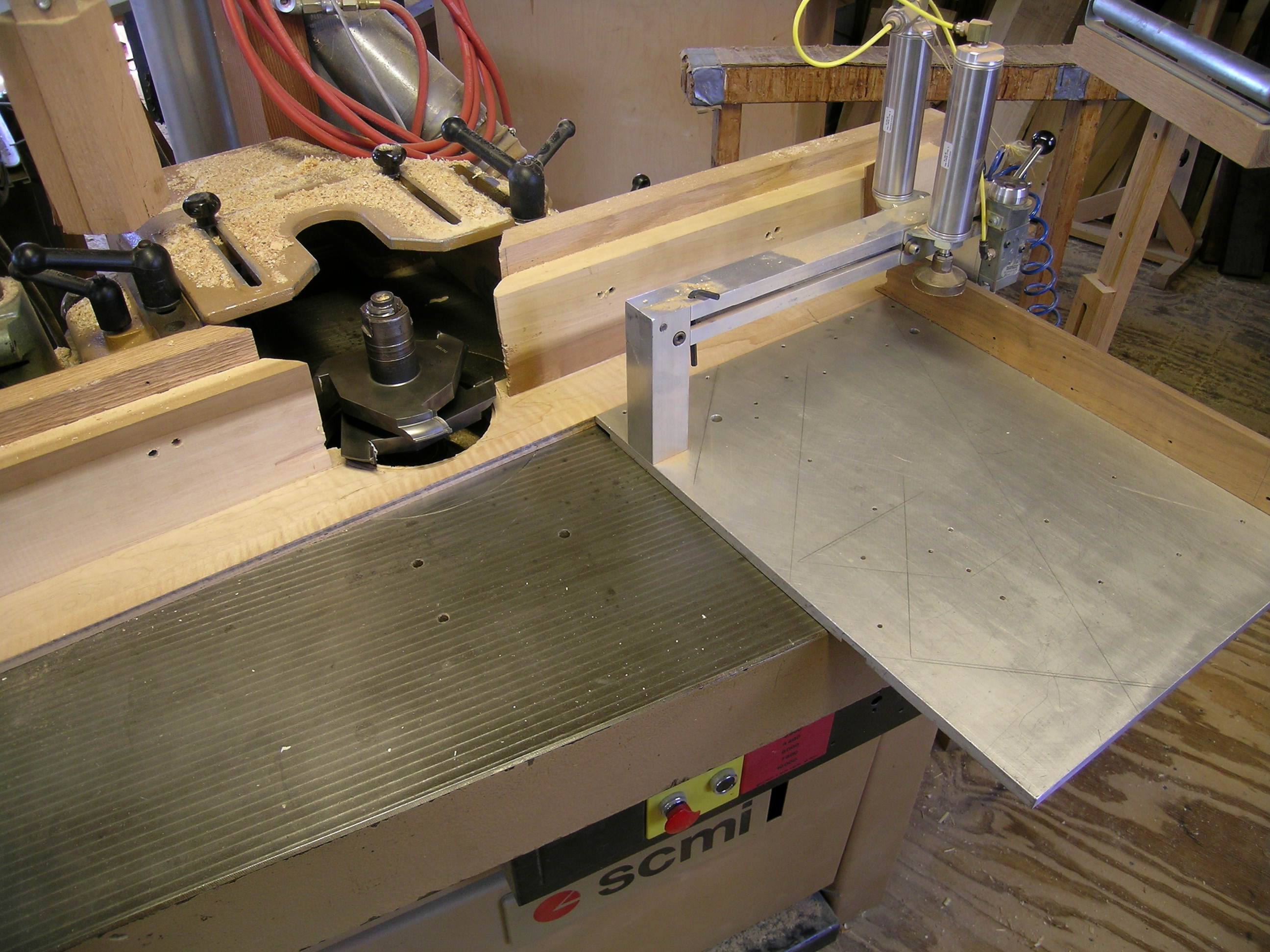

I have a coping sled that registers along a continuous fence that runs under the cope heads. The sled is 3/8" aluminum plate, with two air clamps above, and a fence that accepts a wood backer. Can handle up to 13" width as well as muntin stock. It rides on UHMW straps. Fast, easy sold and safe. Also will accept up to 3" thick parts. Love it.

Any chance you can post a pic of your sled?
5/9/23       #6: Coping Sled ...
Not the best shot, but you get the idea. The overhead aluminum bar holds the two air clamps and allows positioning where needed. The aluminum back up bar is concealed by the wood back up strip. It is fixed at 90 degrees so we would never have to go in and try to get back to absolute square. The heavy plate rides on two recessed UHMW strips, and registers against the fence.
