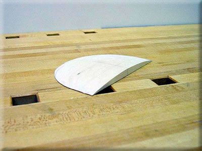

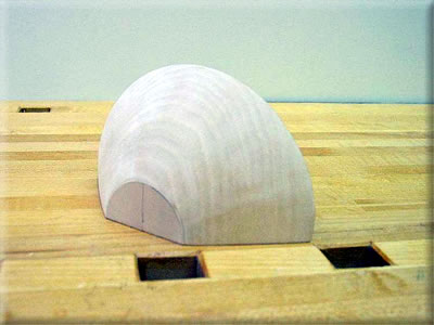

Folks,
I'm trying to make my first Lute and Oud, as an experiment in instrument making.
I need to cut the attached shapes (the neck and base blocks), ideally on a table saw, but can, if necessary, also gain access to a bandsaw.
The neck piece front and back sections are semicircles, and I need a method which will allow me to cut the piece in various sizes.
The base block also has a semi-circular profile, but humped.
Any ideas ?
Thanks in advance.
12/29/23       #2: Cutting a Lute/Oud neck on a table ...
Dave Edgerton  Member
You cannot cut those on a table saw. It is the wrong tool. Bandsaw is better and then lots of hand work. There is no easy way in my opinion
12/30/23       #3: Cutting a Lute/Oud neck on a table ...
I have seen this done using a band saw at a bevel angle and cutting out rings
