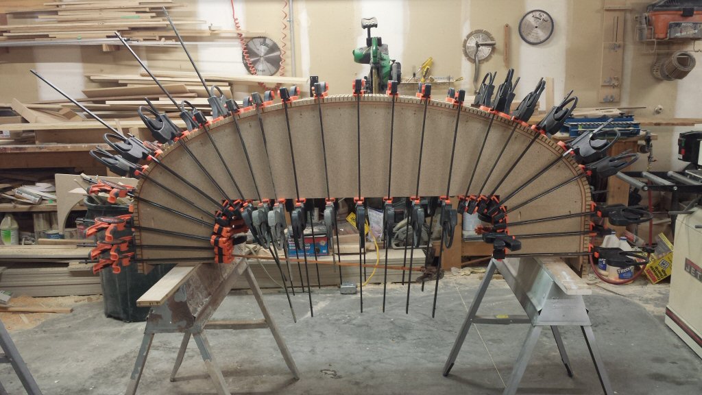

For an 10'' wide radius jamb head is it better to build a mold approx 11'' and deal with keeping the jamb coming out flat across it's width OR make a mold approx 5-1/2'' wide and edge gluing them together after both have come out of the mold and have cured ?

I do mine in one pc. I use kerfcore to help keep it flat. Used squeeze clamps an have the jaws cover as much of the surface as you can to help keep things flat.
I think this one was somewhere in the area of 8.5" wide when it was finished.
