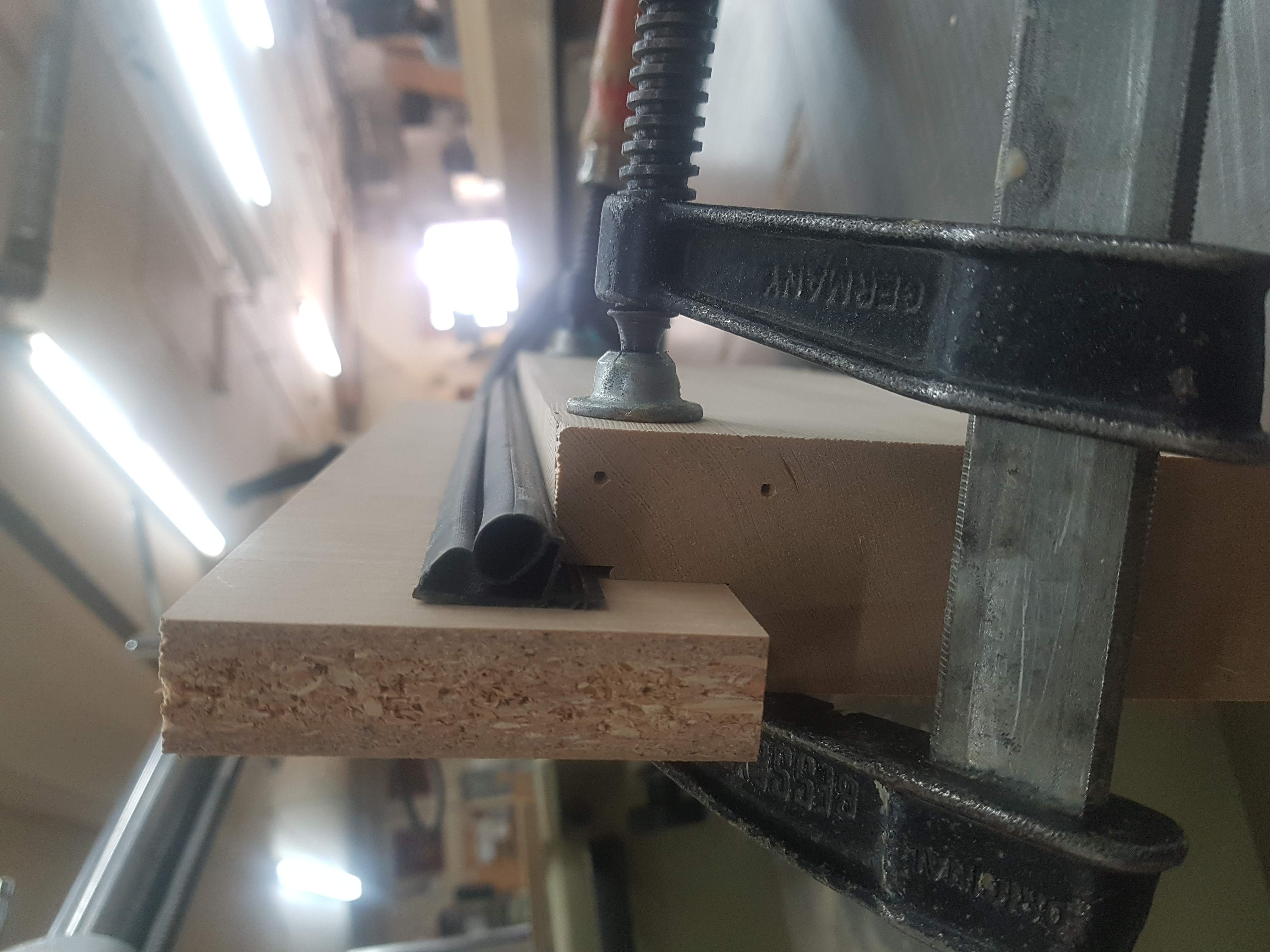

HI Gary,
We do build our exterior jambs up as a 2 part unit. For deeper jambs sometimes even 3. This gives you the option to offset your corners as well.
the attached picture is just a mock up but it should explain.
