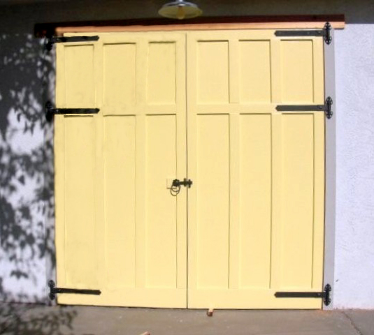

Anyone have any advice on the best ways to insulate a garage carriage door?
I love this door, and the woodworking that went into it. But I think I could get a little more insulation out of it.
Maybe EPS vs Urethane? Does one insulate more than the other or is it just overall strength that matters when choosing one vs. the other?
Any thoughts?

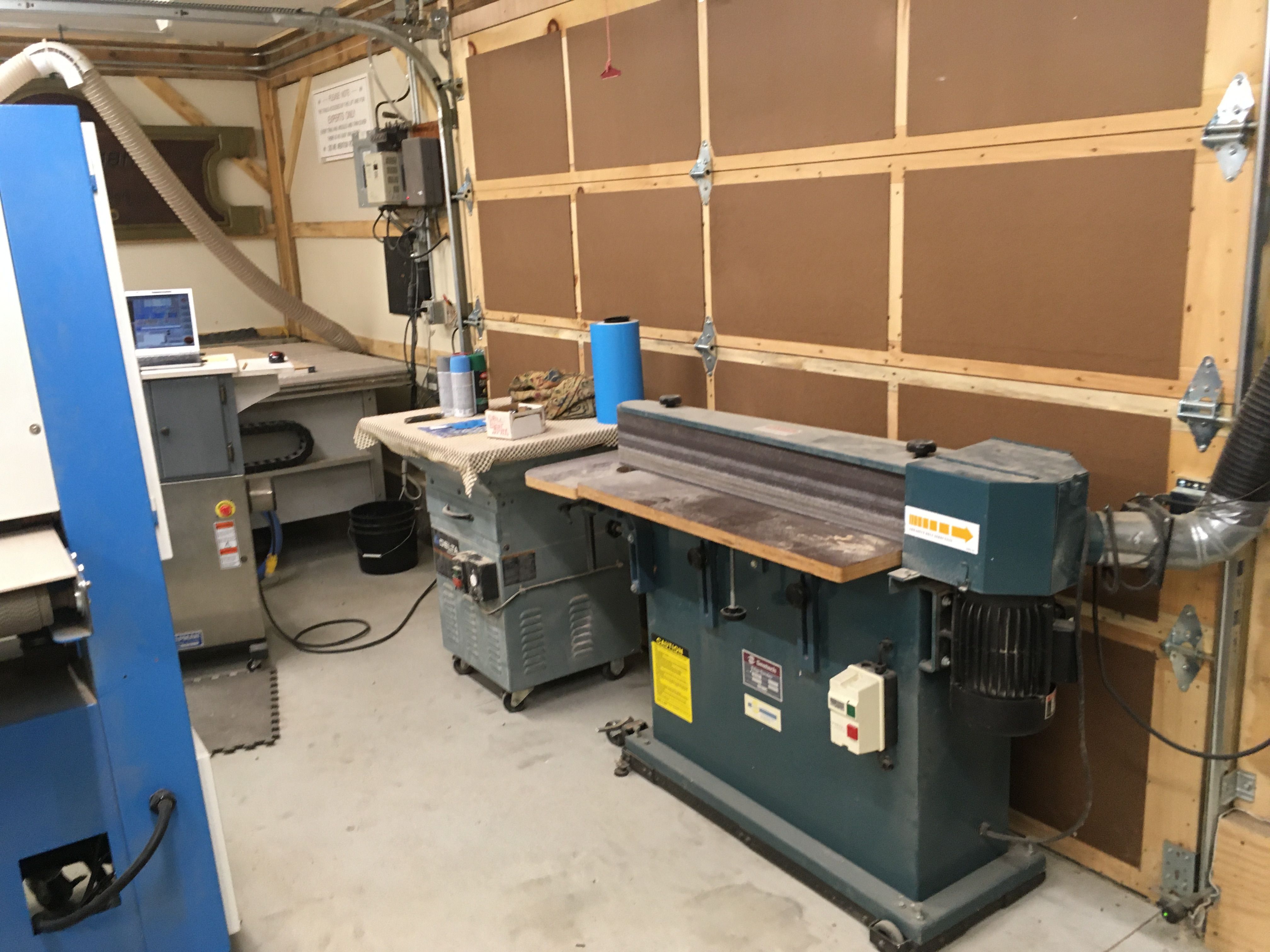

I'm confused. Your business link is to Sing Core University. Looking at that website it seems the whole purpose is to produce products with lightweight, insulating cores. So why build an uninsulated solid panel door..........if that is what it is?
As to the question, I need to ask where you are located. Some foam insulating products loose the insulating capacity in cold climates. So where you are could determine the best insulating material.
On garage doors where the inside appearance is not a major issue I've used 3/4" foam board in the panels with 1/8" Masonite spanning the panel recess and attaching to the stile and rail frames. This looks presentable enough in a workshop sort of environment and gives a small amount of insulation to the doors.
5/20/24       #3: Garage Carriage Door ...
BH Davis  Member
Photo attached.
