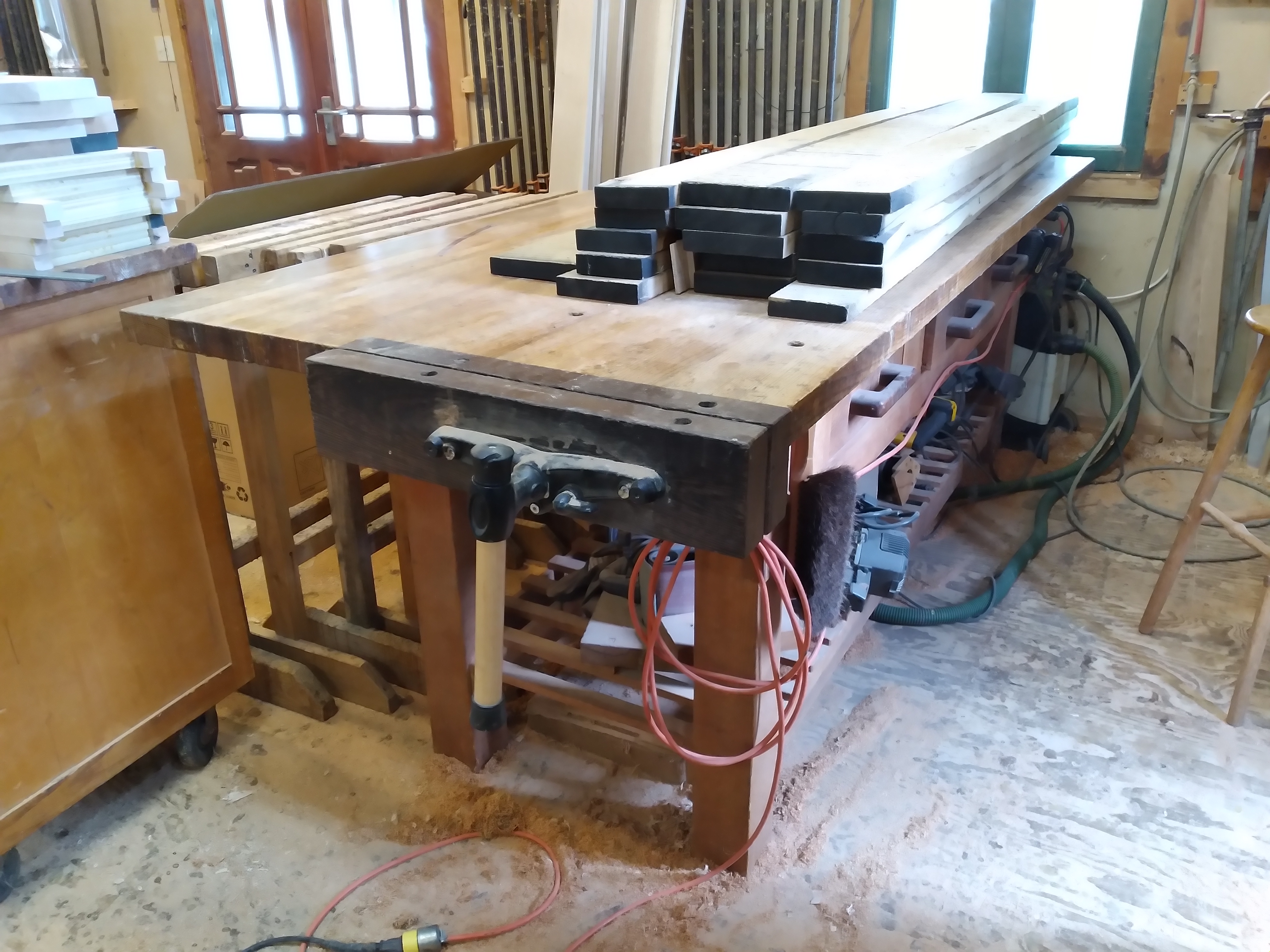

Dave Sochar Member
"Start flat, stay flat." is what I learned. I have a 600 lb bench that is rarely moved. The floor is marked where I know the bench is flat. If moved, all I have to do is get it back on the marks and it's flat.
The process of getting the bench flat is detailed in my book "Small Shop Production of Custom Wood Doors".
View higher quality, full size image (4160 X 3120)
