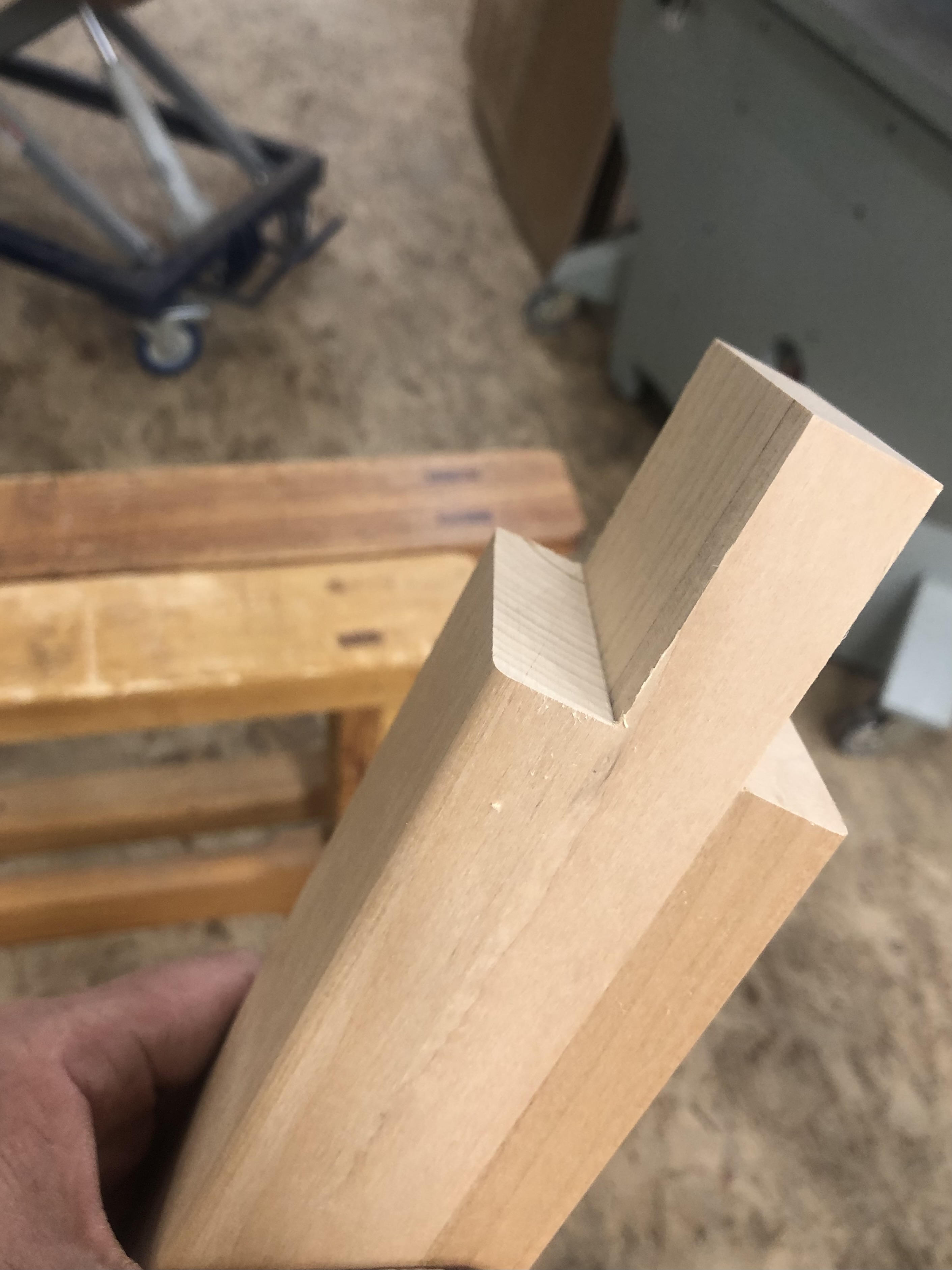

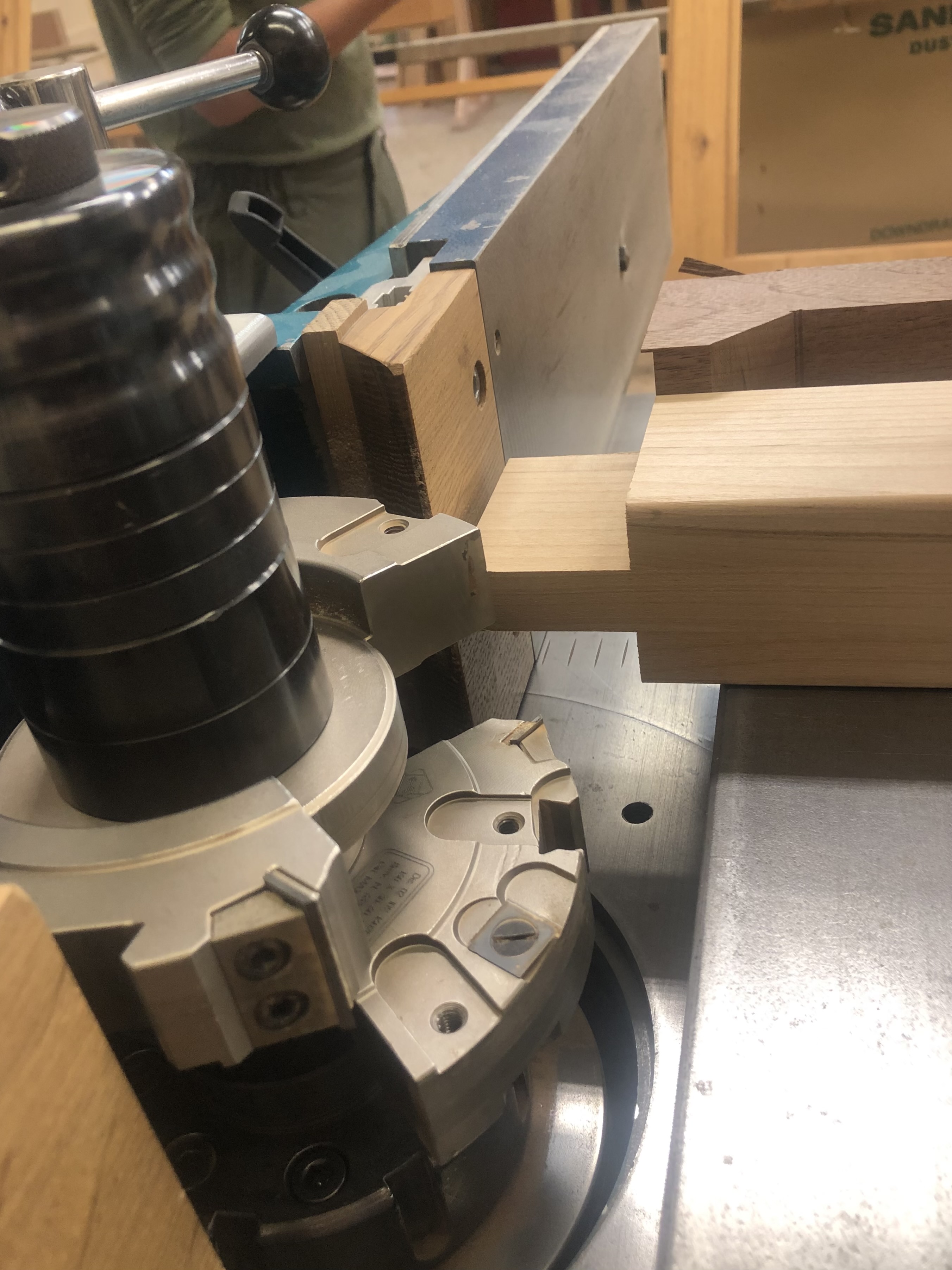

Joe Calhoon
I don’t mind the spurs on tenoning disks. They leave a cleaner cut than groovers without them and the little indentation is not noticeable in most cases. All my disks from the Garniga Multiuse cutter shown to the 320mm diameter Tenoner heads have the spurs.
View higher quality, full size image (2822 X 3763)
View higher quality, full size image (2704 X 3606)
