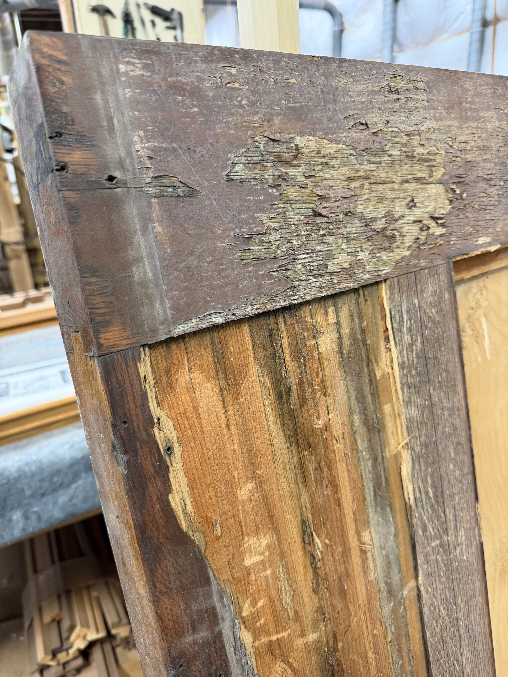

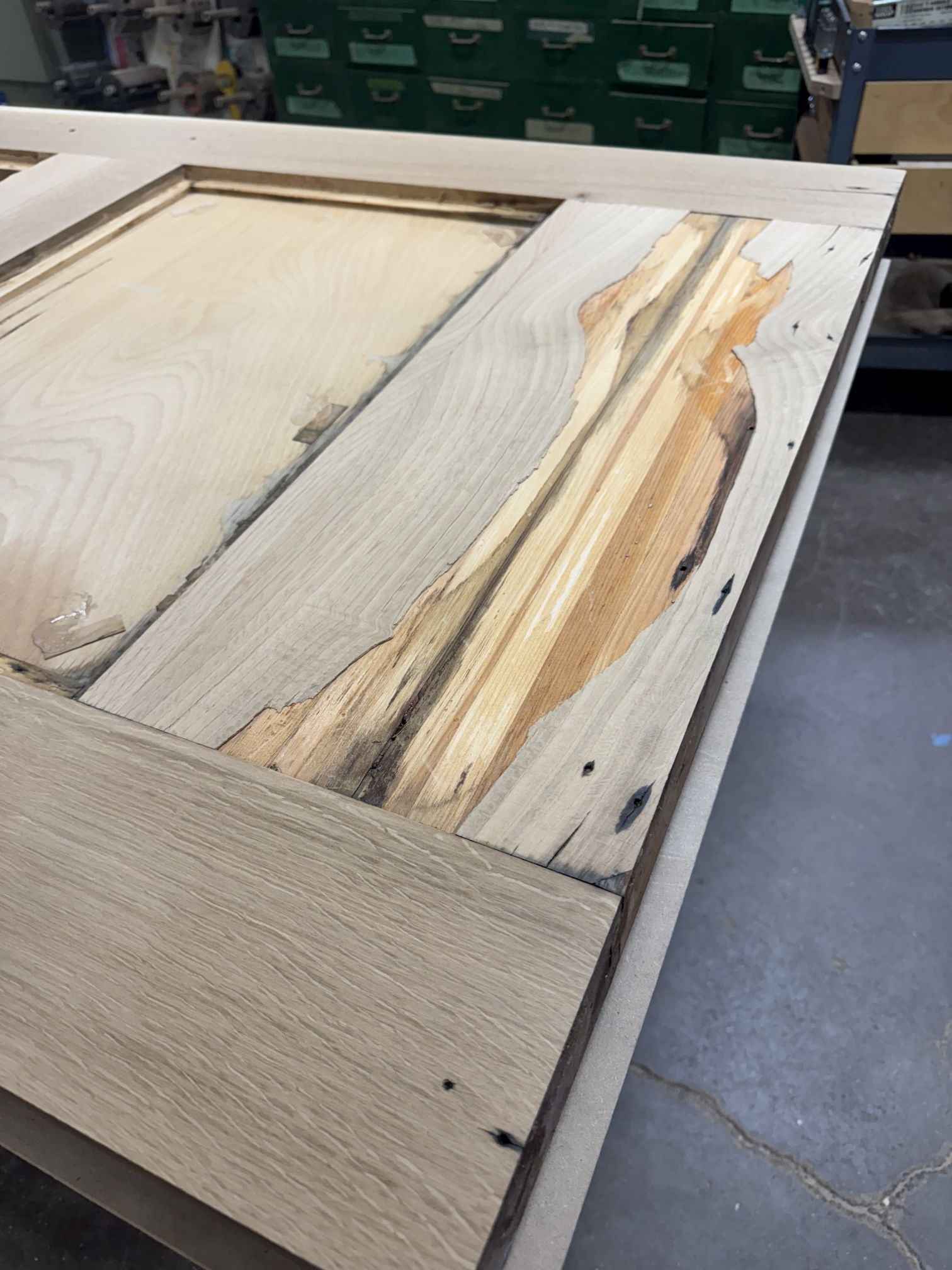

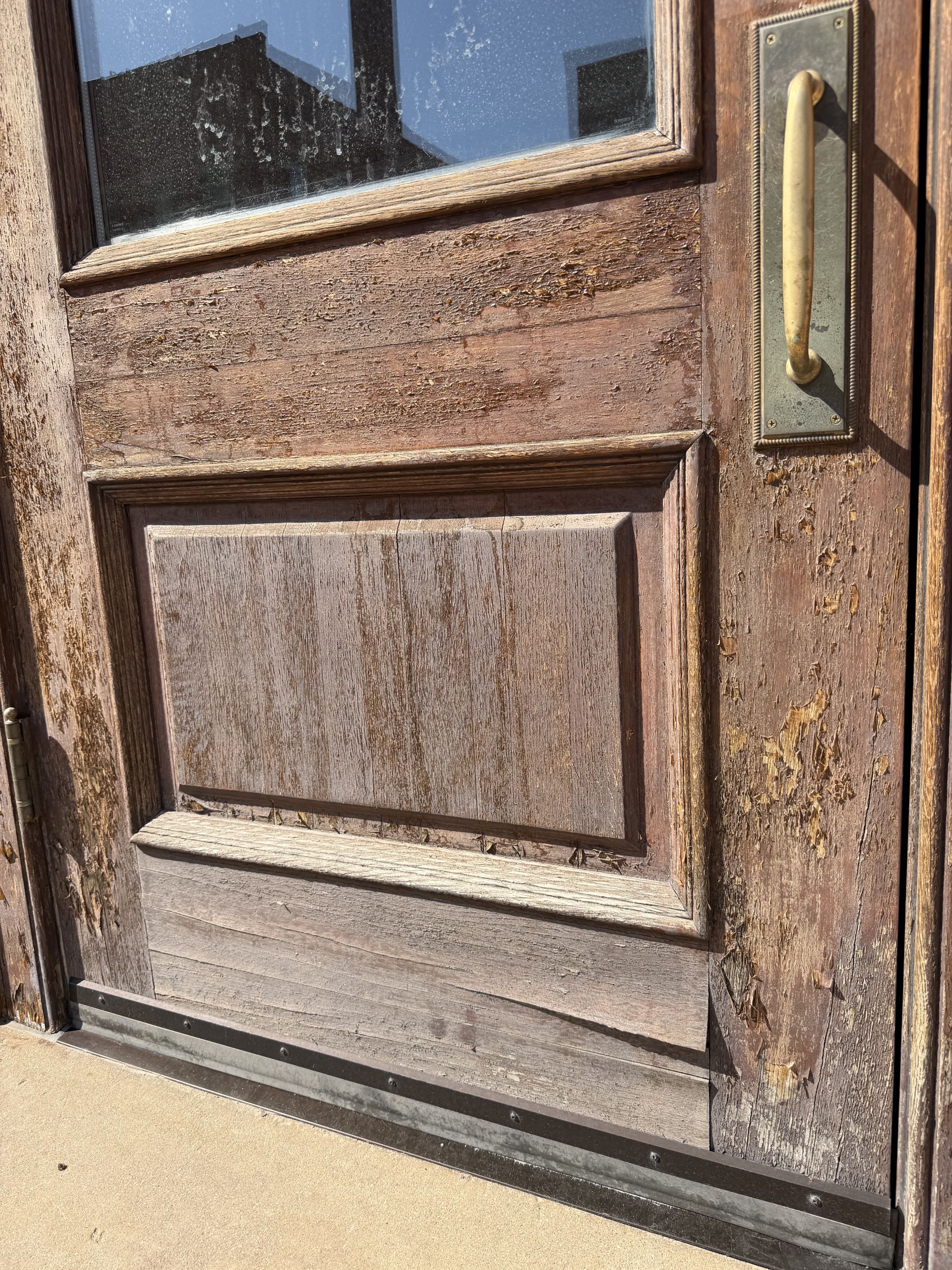

We have taken on a project that I would like to get some advice and feedback on. A customer has asked us to re-furbish several sun & rain worn wood exterior doors for a highly regarded building in our town.
We suggested that we can re-skin the doors. We received the doors, removed the bolection moulding, the glass, and loose pieces. We first were going to take the top layer of the door off by CNC and then we opted to use our wide belt sander. We are as far as removing the top layer. We are now at the stage of applying the new skin made from quarter sawn Sapele. This is where I am looking for advice:
1.) Do we need to be concerned with the moisture content of door compared to newly re-sawn skin? What if the door is dryer than the new skin? What issues can this cause?
2.) What type of adhesive would you use to glue the new skin to the old door? We use Franklins Advantage 405 but thinking maybe we should use an Epoxy like West System.
3.) Need to re-glaze the glass. What caulk do you use to caulk glass in? We use Nova Bond Pro caulk but it is not silicone. I feel silicone is the way to go since it is water proof. But as you know, silicone is it is not stainable or paintable and can be a mess.
Appreciate your feedback
