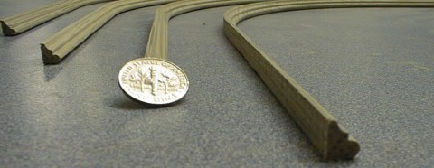

Here are some I ran probably 25 ago. I'm afraid I can't recall how I made them but my suspicion is that I had a custom router bit made. If I had my first CNC by then they were almost certainly made with it. It's been 10 years since I sold the company and these were done many years before that.

BH Davis  Member
Oops........senior moment. Forgot to attach the image.
BH
