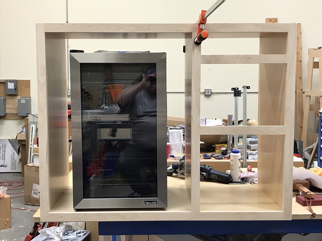

I am building a cabinet for a client who now wants to alter the design, making 60% of what has been done, throw away.
The issue centers on the space around a mini fridge. The manual for the mini fridge recommends a specific minimum space around the fridge for ventilation. After seeing what the space looks like, in person, the client is not happy.
The client did sign off on the initial design. My concern is the mini fridge prematurely failing due to lack of ventilation and having the client seek a legal remedy.

There is too much open space surrounding the mini fridge, according to the client. Unfortunately the opening for the fridge drives the size of the bank of drawers to the right of the fridge.
A new carcass, face frame and drawers will need to be constructed. There is the loss of fabrication cost as well as material cost.
The client picked out the fridge and the location is in an alcove in the master bath, so it will be a warm and humid environment. The cabinet depth is limited by a wall outlet on the right side, limiting overall depth to 23 inches.
All the under counter mounted mini fridges I've seen are vented through the bottom, but are too deep for this application. The client wanted a mini fridge that was only 15-17 inches wide and 18 inches in depth.
The current design allows 3 extra inches on the sides and top.

This is the coffee bar with the mini fridge and the ventilation space as specified in the product manual.

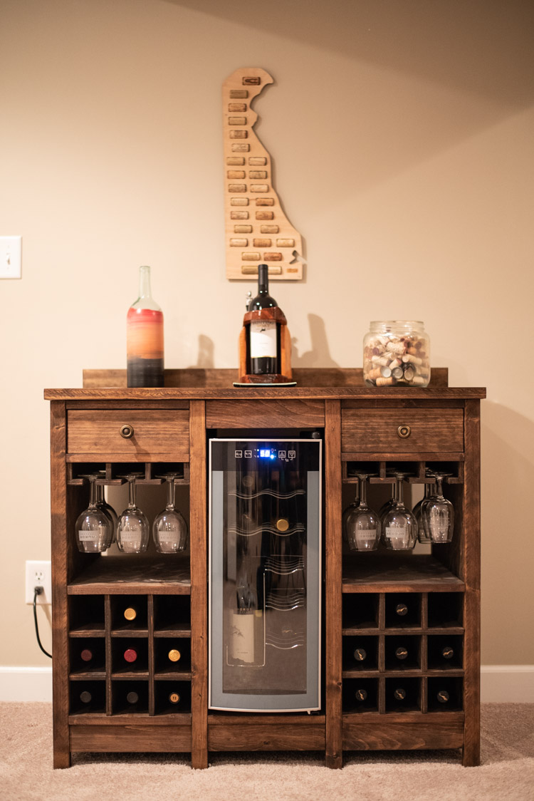

As you mentioned, I recommend having the client sign a statement for the redesign. Alternatively, could you not include a wine rack design within the space and around the fridge with gaps/mesh/ or another to allow for wine bottle storage and ventilation?
Something like this? - But with spacing...
