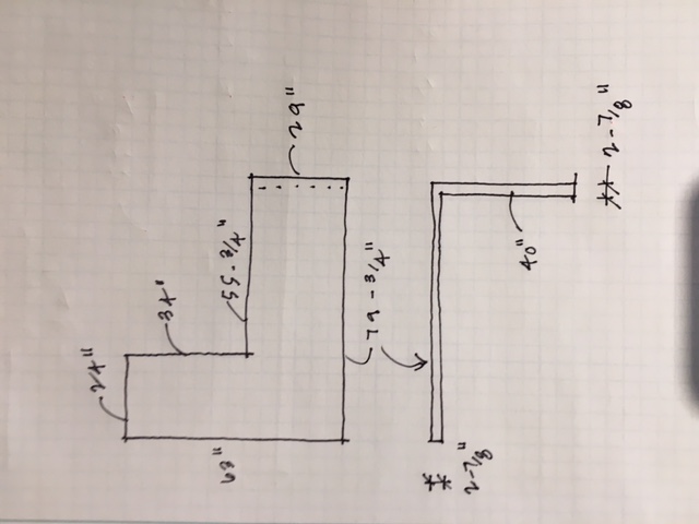

i don't want to bias any opinions interpretations so please let me know what you think the height of the leg (from touching the floor to the top of the countertop) is supposed to be based on this drawing. i'll wait for a few responses before elaborating on my drama.

Ill give it a go.....
floor to top of counter 42 7/8"
4/17/18       #3: owning your own business is always ...
Mark B Member
I would read that as counter top is at 40" +/- 2.875
lol. A heavenly tolerance to meet.

Pretty sure you are looking at a plan and elevation, the top is 40"AFF or 40" Clear with a 2-7/8" thick top, the leg is 2-7/8" wide to match the top.
When in doubt do a shop drawing.

The picture is not to the same scale but I think the 40" is the clear
drawing_one.pdf
4/17/18       #6: owning your own business is always ...
Alan F. Member
oops that one didn't have the dims
drawing_one_3.pdf

gentlemen - thanks for your guesses.
the shortest, long version is that my interpretation of his drawing was that the 40" was to the long points (top of top to floor) since all of the other dimensions are long point measurements. per his asking and my regular process, i sent him a shop drawing (attached). he approved the shop drawing. we built it to the drawing and upon dropping it off, he discovered the leg was shorter than what he needed and stopped payment on the check he'd just given us two hours earlier. we didn't install it so we didn't initially know there was any problem.
since friday, we've exchanged some emails where he somehow wants me to admit that i drew it up incorrectly and take responsibility, even though he's worked it out with the homeowner to accept a piece of base to hide the gap (accepting the piece as-is). i'm never going to do this.

Based off of that sketch I would have asked for a clearer drawing or at least called for clarification. It's too bad that someone else's lack of detail becomes the cabinet makers "mistake".

If I was given that drawer my, I would have had a phone or face to face clarification on what they wanted. Second I would have had a face to face or phone conversation to review my drawings and specifications so it was clear what we are building and why. I have found that the customer doesn’t know or understand what they don’t know or don’t understand. My guess is the builder spent about as much time reviewing your plan as he did on his drawing.
With that said, he has your built project and your money and all the leverage. You can be a hard nose and do the whole attorney or small claims court thing and waste a bunch of time and money to maybe get all your money or you can pick up the phone and eat a little crow and give up a few bucks and get your money and go back to work and consider the loss tuition. I suggest a call over email as many people like me are short and to the point and people think I’m being a jerk, where as a phone call gets the tone of the voice and you can usually do a better job of resolving it.

Although clear to us we would have shown the 37-1/8" clear under the top on a shop drawing but we probably would have asked before doing the shop drawing as it scaled differently and wasn't clear.
He signed off on the shop drawing, for us that's then end of it.
Our proposals on install by others excludes field verification of any dimensions or site conditions.
We just got paid for remaking some trim where they sent us a 109" build dimension when they meant the other 10'-9" dimension.
The simple solution now is to make him a curb for the leg to sit on with some trim.

The tag line and bullet point are on the inside of leg, so I read the overall height at 42 7/8

Sorry, but I'd see that as 42 7/8.
Easier to cut down than to add too.

I see 40" tall overall height. Whoever made this drawing noted a 2 7/8" stile on the right side & 2 7/8" top rail. The drawing does not show a 40" stile + an additional 2 7/8". Depending on the client/contractor this would not be re-made for free, I would agree to "help" somewhat based on how much I valued this client.

All the dimensions in the plan view are shown on the outside of the cabinet/top with lines connecting the dimensions to the outside.
The elevation view shows both the inside and outside of the leg and the 40" dimension is on the inside and pointing to the inside so it makes the most sense that it is the inside dimension, though I definitely would have called for clarification before making my own drawing.
If it were on the outside and pointing to the outside then I would consider that the overall height.
