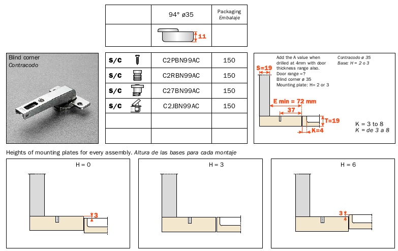

When using Salice blind corner hinges do the mounting plates go 37 mm back like we do on normal cabinets?

Hi Al,
This is true, but the mounting plate location is also dependent on the edge bore location of the hinge with the blind corner.
You can see in the drawing that a 4mm hinge bore works with a 37mm mounting plate set back. If for example, your hinge bore were at 5mm or 6mm you would need to compensate by moving the mounting plate to 36mm or even 34mm.
Hope this helps.
Merry Christmas
Dennis

Yes, it’s available in soft close.
C7RBNE9AC
Hinge with dowels.
