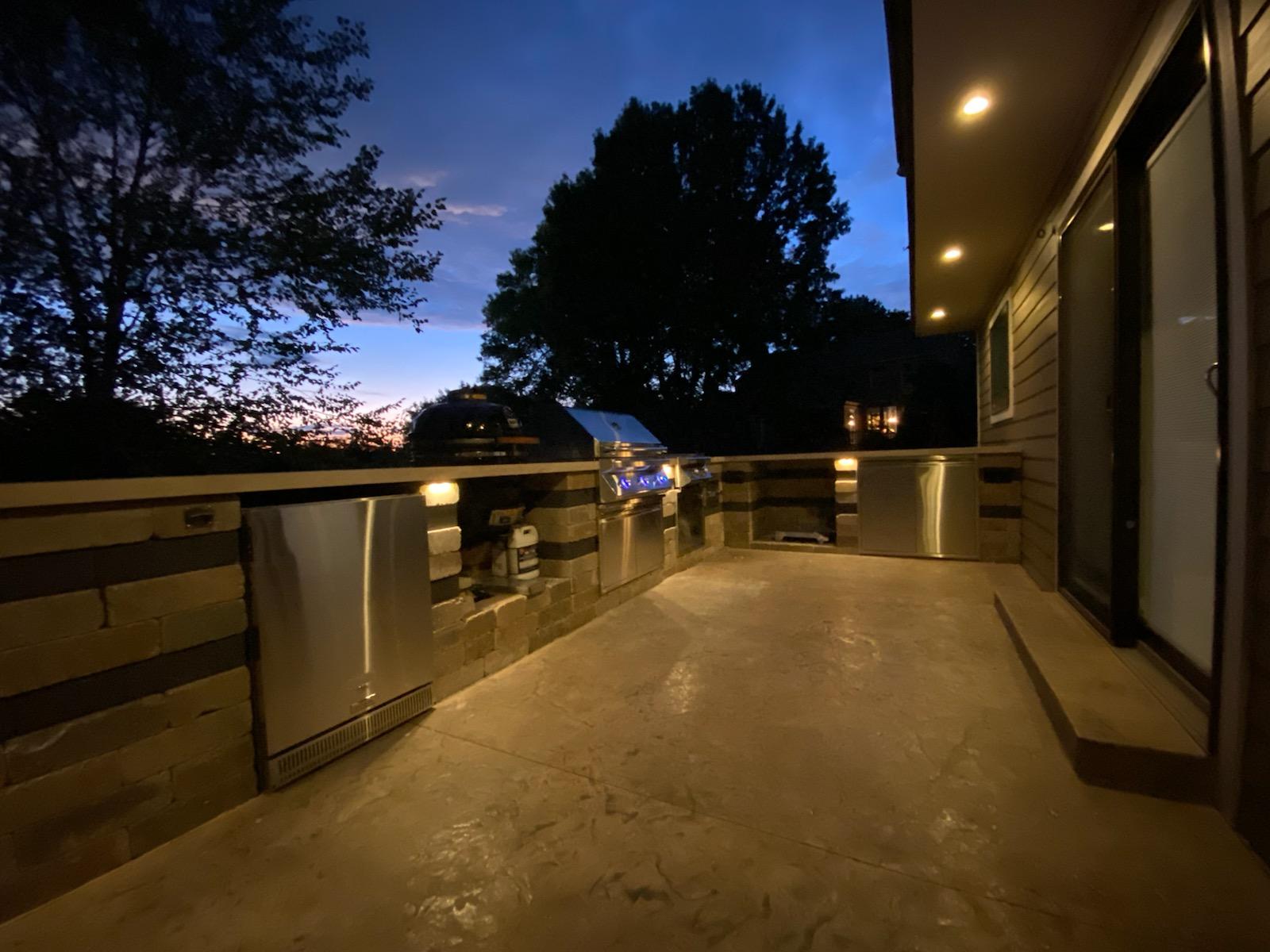

12/6/20       #14: Stone countertop cutting ...
Patrick Drake
Scott,
This is not difficult.
I had a project this past summer, an outdoor kitchen hardscape project.
The homeowner wanted to save a few dollars by using 3' x 4' slabs of travertine 2'' thick.
I just used my old beat up Makita worm drive with a diamond blade, garden hose, and a clamp and guide. Not rocket science.
PFD
12/6/20       #15: Stone countertop cutting ...
Patrick Drake
Photo of the job.
