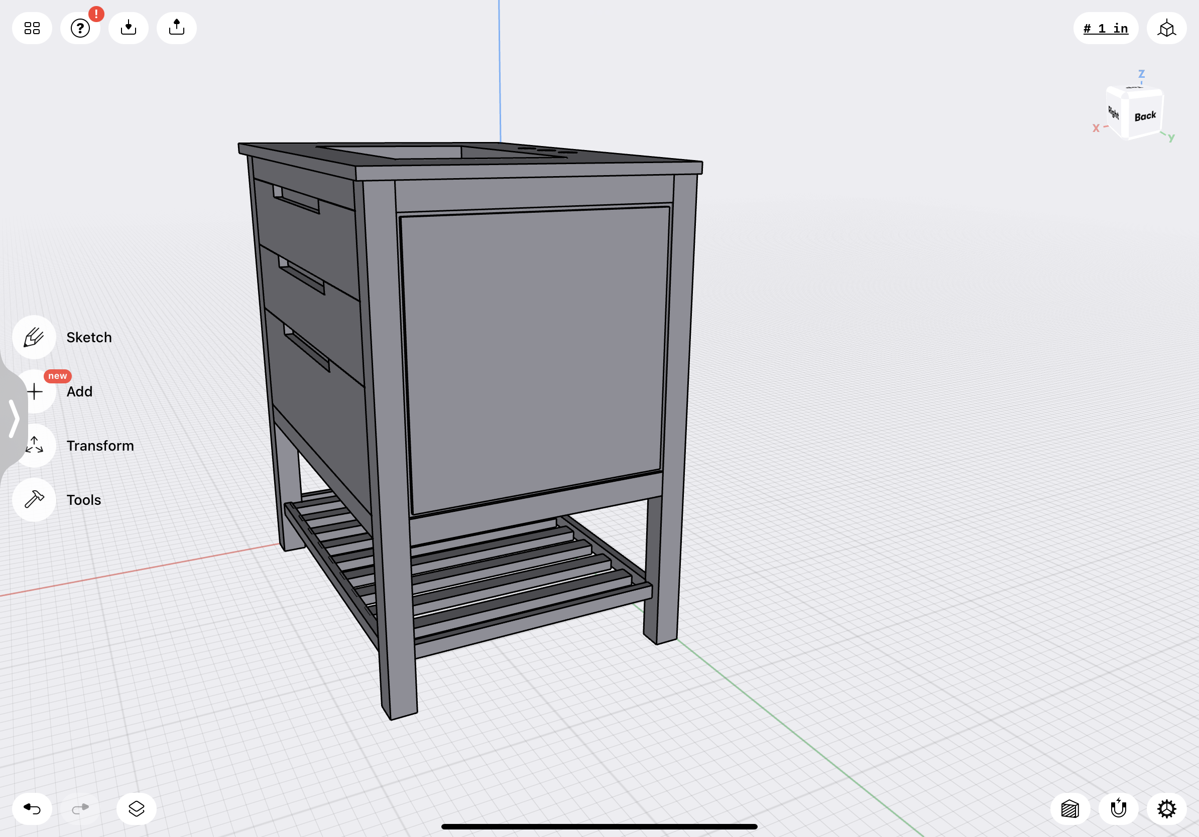

I am building 2 Bath Vanities out of White Oak, I suppose design wise it would lean more towards "furniture" style than a traditional cabinet for a visual.
There are 4 legs 1.75 x 1.75 with a top rail and bottom rail about 18" from the top. The sides will have a solid White Oak panel 1/2"+ thick ~18" x 18". Between these two rails, the panel will will be flush with the legs and the rails with a reveal 1/8" to 1/4" around the edges to create a shadow line. I would like it to be as minimal as possible but am worried about expansion. Looks like White Oak has the possibility of expanding quite a bit, I don't know the change in MC from Winter to summer in my area so I just took a guess at 4MC which when plugged into the calculator gives me something like .26xx - Am I looking at this the right way?
The other question is how to best keep the panel centered, I was thinking of using space balls but now think it may be better to just pin it in the center top bottom inside rail and maybe just space balls on the bottom top to help with any rattle. thinking this may be the best way to have any chance of the panel expanding equally right/left so the reveals stay somewhat even.
Hopefully I explained it clear enough, any feedback/recommendation would be greatly appreciated.

Here is a screen shot for a better idea. It is showing a 1/4” reveal, I would like to do 1/8” - 3/16” but idk…

I haven't done the calculations to double check the the answer but it sounds about right. You could halve the movement by selecting quartered or rift cut oak.
With respect to keeping the panel centered, you can pin the panel tongue top and bottom in the centre from inside the cabinet.
The down side of a frame and panel here is that any water drip down the side could collect in the groove at the bottom of the panel and discolour the wood.

Thanks, unfortunately i have the side panels resawn out of flat sawn already, do you think that if i allow 1/8” deeper slot that would be enough for the movement or should i go 1/4”?
Good point on the lower rail, I didn’t think of that

There's no harm in working a deeper dado. Apply one or two coats of finish to the panels and frame grooves before assembly to seal them. This will help with any water that might get caught in the groove.

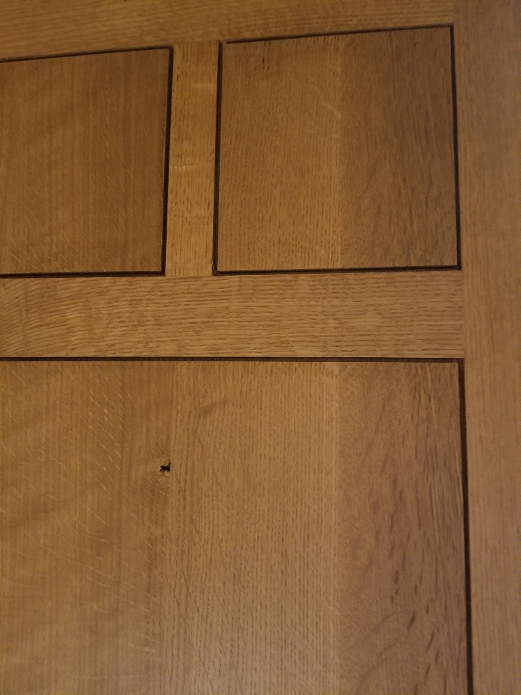

We have built many doors like this from many different materials with reveals ranging from 1/8" to 1/2". This is a popular style when a customer wants something a little different. We brand this as "transitional". I've never had a call back or a door failure. It's a frame and panel door like any other, built with space balls like any other, designed for the center panel to expand and contract like any other. If the reveal were to measure 3/32 in the winter and 5/32 in the summer, who cares?
The attached image happens to be the back side of a door in my office, but reverse it and you have exactly what you're describing.

DJS, thanks for the info.
No one would care about 1/16”, i am more concerned if for example (extreme case) if the reveals are 1/4” and the wood moves 3/16” in one direction now you have a 1/16” gap on one side and 1/4” on the other.
I was planning on pinning it in the center but I don’t know if the wood expands evenly right and left.
I have never used space balls, I mostly build furniture now but 25 yrs ago I did a lot of cabinets. So with space balls yow just add the diameter of the ball to the depth of the slot?

Exactly. Space Balls are about 1/4" in diameter so we allow about 3/16" extra beyond the size of the panel. This effectively centers the panel and keeps it centered even if there is expansion and contraction, so long as you do not pin the panel.

Center pinning from the back or space balls will work. Space balls with a 3/16" gap will center the panel during glueup, otherwise you will have to center it with a putty knife or similar tool. If pinned in the center, any difference in movement to either side will be negligeable unless the grain orientation changes drastically from edge to edge.
