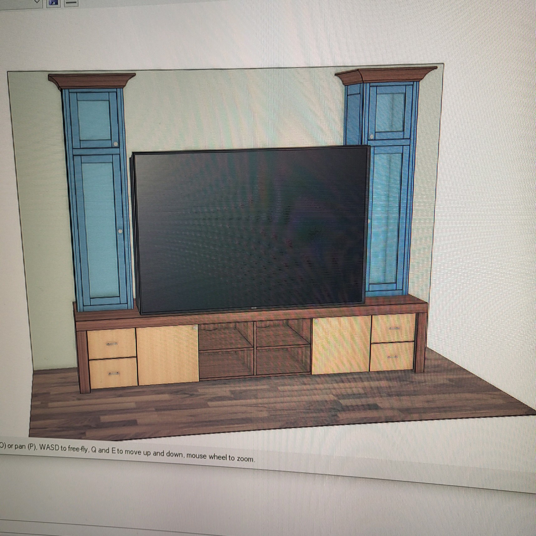

Karl E Brogger  Member
I bet almost all of us have something we made because we made some doors wrong.
I didn't measure a ceiling correctly and had some wall cabinets that went from counter to ceiling. Wrong measurement = no fit.
They've sat around the shop for over a year. I'm finally building myself a new TV stand, and those mistake cabs will book end the tv.
I might still pitch them.
11/1/22       #23: 5 piece cabinet door screw up ...
Karl,
Every tv commercial will give you the opportunity to give yourself a hard time for the first mistake and also the compromise in the tv cabinet design to make the doors work.
Read my first post and throw them out asap.
11/3/22       #24: 5 piece cabinet door screw up ...
You're probably not wrong. They are just going to be sitting on top of a waterfall top. If I want to remake those two cabinets, it won't be the end of the world to do so. They'll be pretty independent of the bottom section.
Walnut for the top and open section. I've got a partial sheet of Fir laying around I'll use for the doors, that will just end up in the dumpster if I don't use it for something. I think the Fir and Walnut will go together real nicely.
Fir cabinets sitting on top would look nice too I bet.
