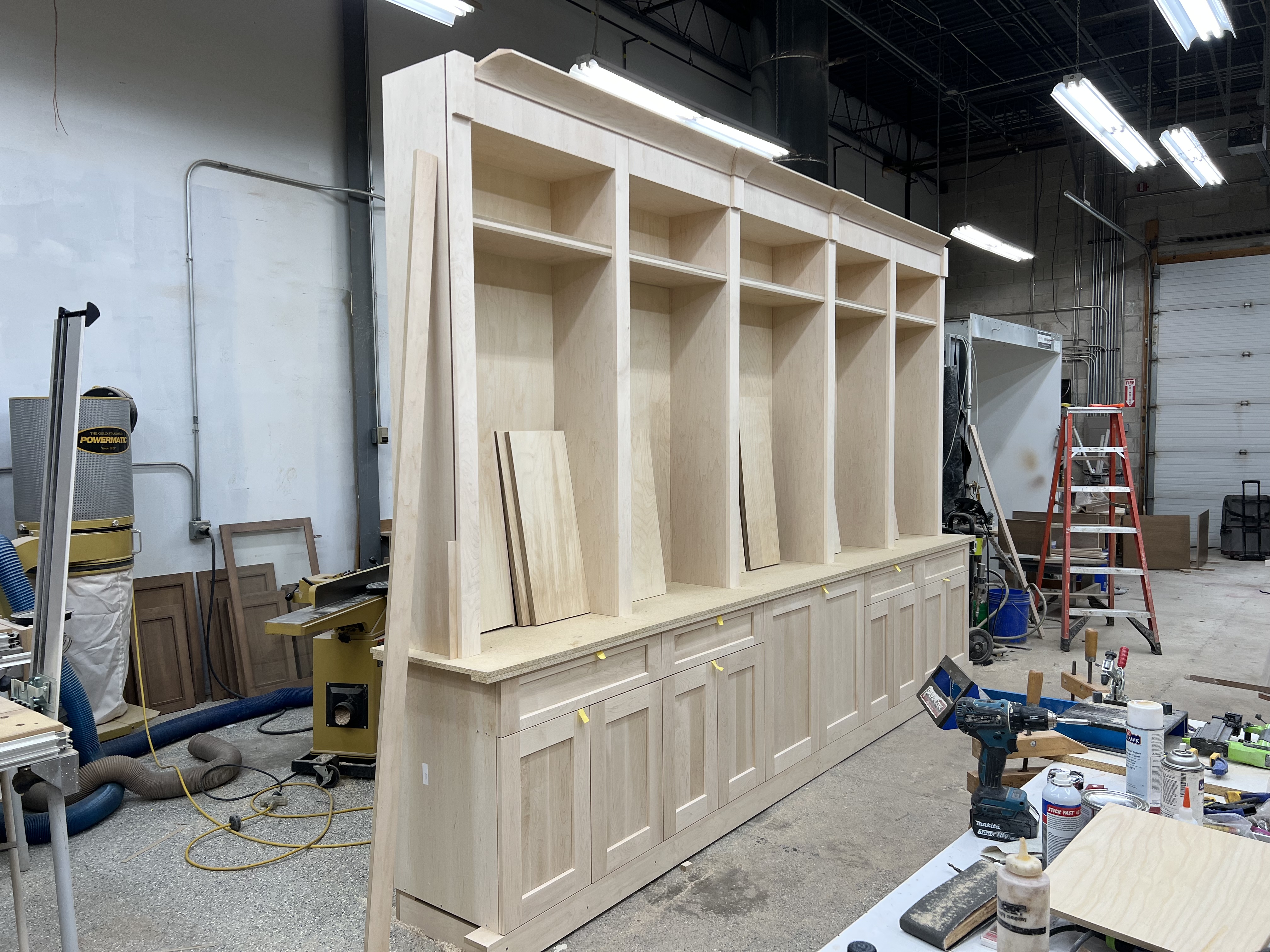

Hello everyone. I have done a bunch of crown molding, but this is a first for me. I typically will cope my inside corners. This particular instance of this tilt a bookcase, I am working on, there is a 3/4” block I’m bumping around.
Here’s the problem…
The crown is a 45/45, 1”x 4-3/4” plain concave cove
Everything was all good until I went to cut the coped piece into the main crown on the unit. The back side of the coped return was hitting the face of the crown on the unit. I tried to sand back the top side back side of the coped piece, but then it started to get into the profile of the cove, leaving me no choice but to miter all of my inside pieces.
What am I not seeing that I could have seen before I started to bother coping the pieces?
I included a picture of the unit. The problem Child care at all of 3/4” blocks I’m bumping around
TIA

Mark B
Run your short piece out from the face of the unit to uour ousode miter forat then cope to that.
12/5/22       #5: Coping crown but can’t really seem ...
Mark B
Sorry typos... run the short piece out from the face of the unit and wrap the snall block first. Then cope your long piece along the unit into that.

The angle at which the crown lays doesn't matter. It is what it is.
You need to imagine the cabinet with no crown between your "bumpouts". They would be mitered U shaped pieces. The long straight sections are coped at both ends.

It's hard to understand your description of the problem without a close-up photo of the pieces. To cut the copes you first cut an inside miter, then relieve the material that would intersect with the square-cut piece using a coping saw, rasps and files. The intersecting line at the face is the same whether the joint is mitered or coped.
I don't favor twisting the molding to meet the ceiling or running it out of level with the cabinet. If the ceiling is reasonably level I prefer leaving a slight reveal or shadow line to caulking the joint. If it is way out of whack, plan on adding a square molding that is scribed to the ceiling above the crown or have the ceiling floated to meet it.

2 things:
1. The crown is not capable because part of the profile is horizontal/in the same plane as the top and bottom. You will cut into the profile to make a cope work
2. No need to cope because (as someone else said) it won't move when nailed and also, the angle should be an actual 45 and not some variation/deviance of 45 like. A framed and sheet rocked wall.
