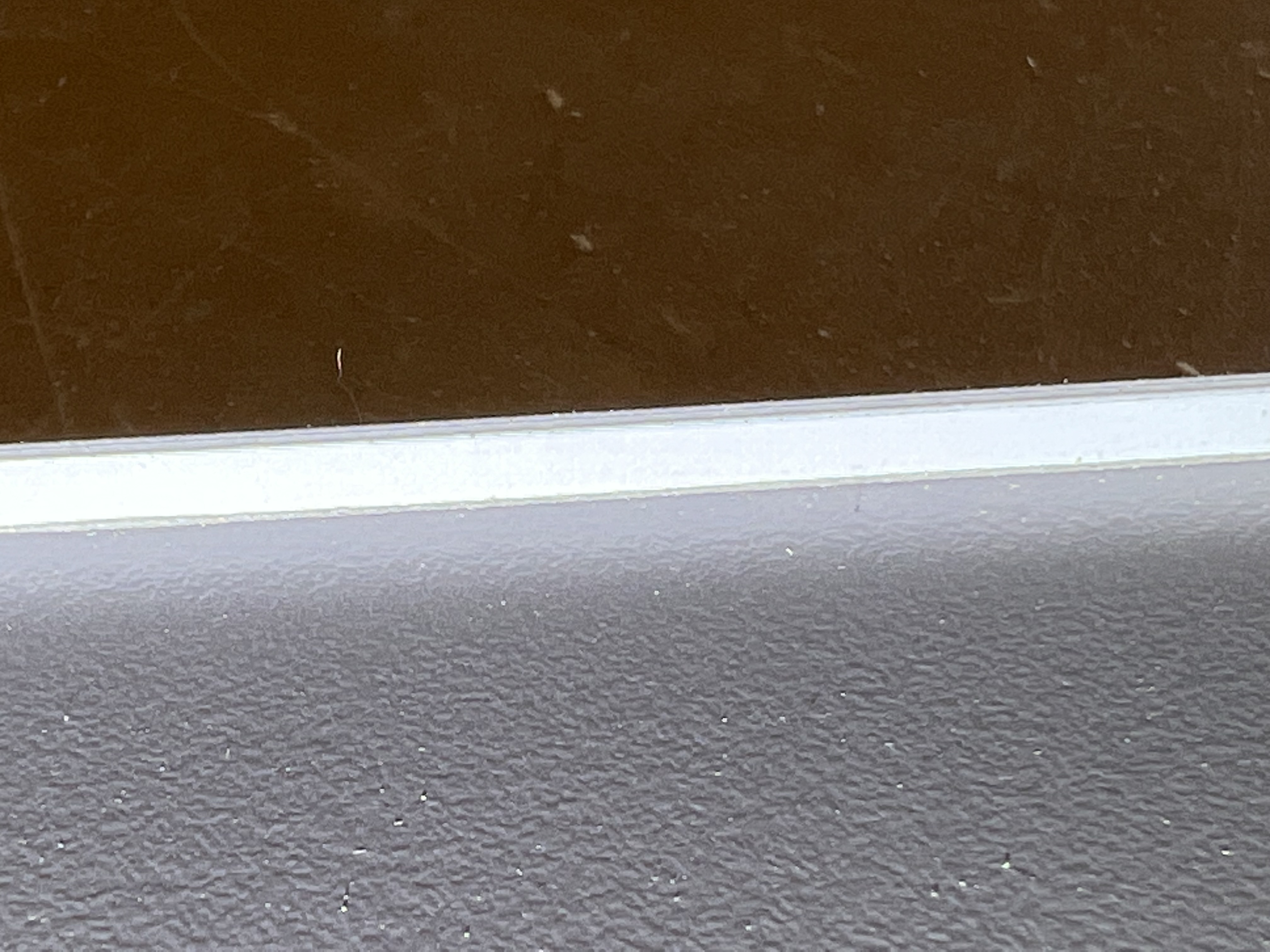

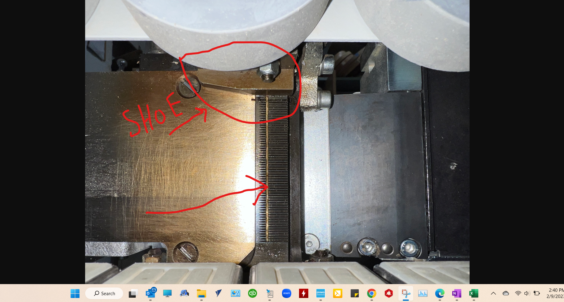

we got a new Holzher streamer 1057XLC it is still almost new and it was installed 7 month ago.
Suddenly it applies a lot of glue at the top of the part,
I reduced the glue cartridge pressure to 1.75 Bar.
Cleaned the nozzle.
RE adjust the Floating Shoe it is 1.5 mm under the slot of the copper rod
Using Jowat 286.30 temperature 210
Finally called the support and did not solve it.
They said it should not me covered under warranty it sound like tweaking issue.
So, I am trying to solve it on my own so far.
Does anyone got on to this situation before?
Thank you for your help.

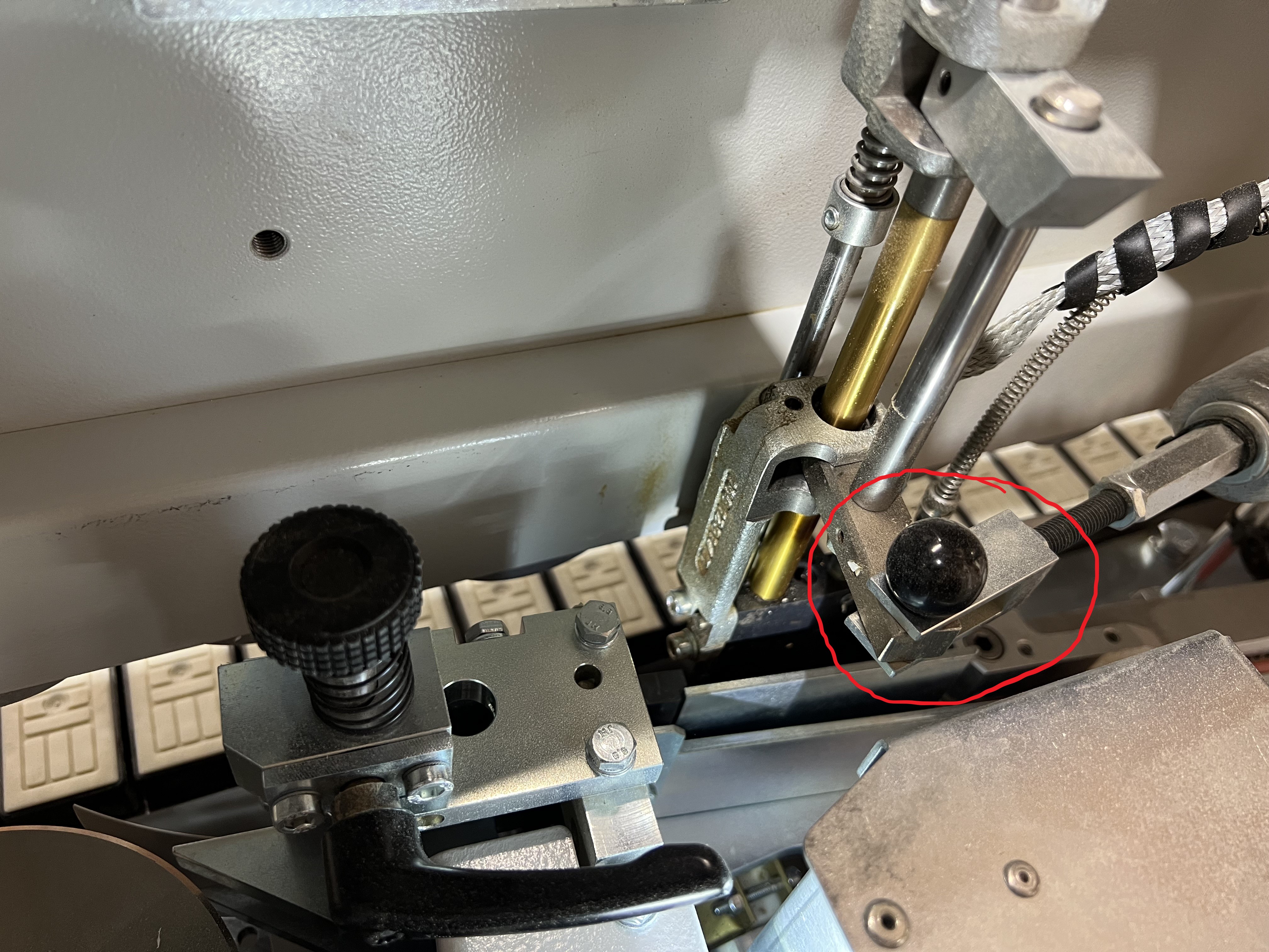

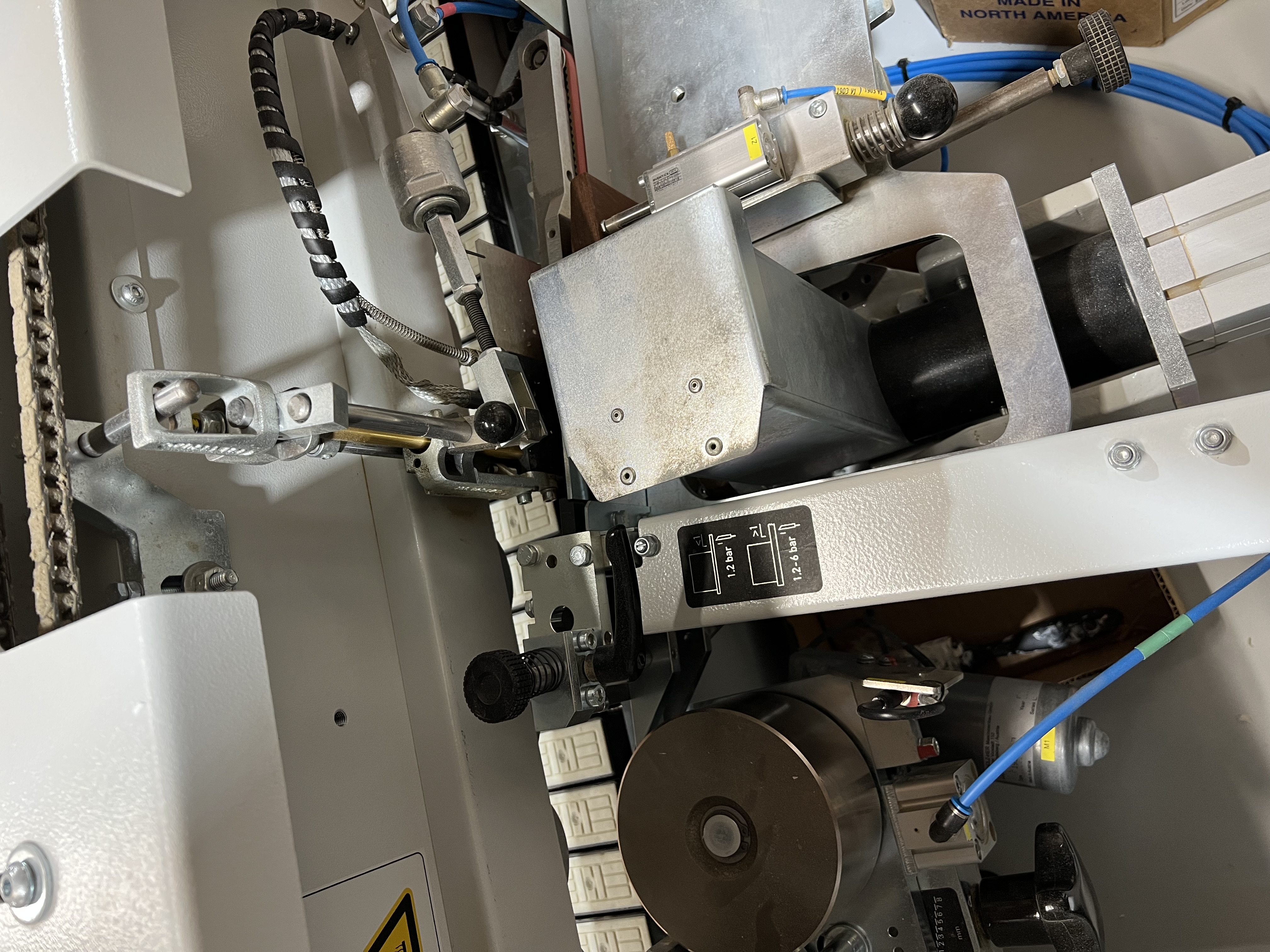

2/8/23       #2: Holzher Bander excessive glue ...
Kaleb Kleinsasser
Could you post a pic of your whole glue unit?

Hi,
Please see attached.
Thank you in advance.
2/8/23       #4: Holzher Bander excessive glue ...
Kaleb Kleinsasser
Pull the black knob upward and swing the air cylinder away.The cylinder opens your glue gate.Then turn the fork at the end of the cylinder clockwise. But do it a half a turn or 1 turn at a time. And see if that helps.

thank you for your response, I am on my to the office now and will try it , but one more question, does the sliding show, has to be even with the slot on the rod or has to be lower and if lower, how much.

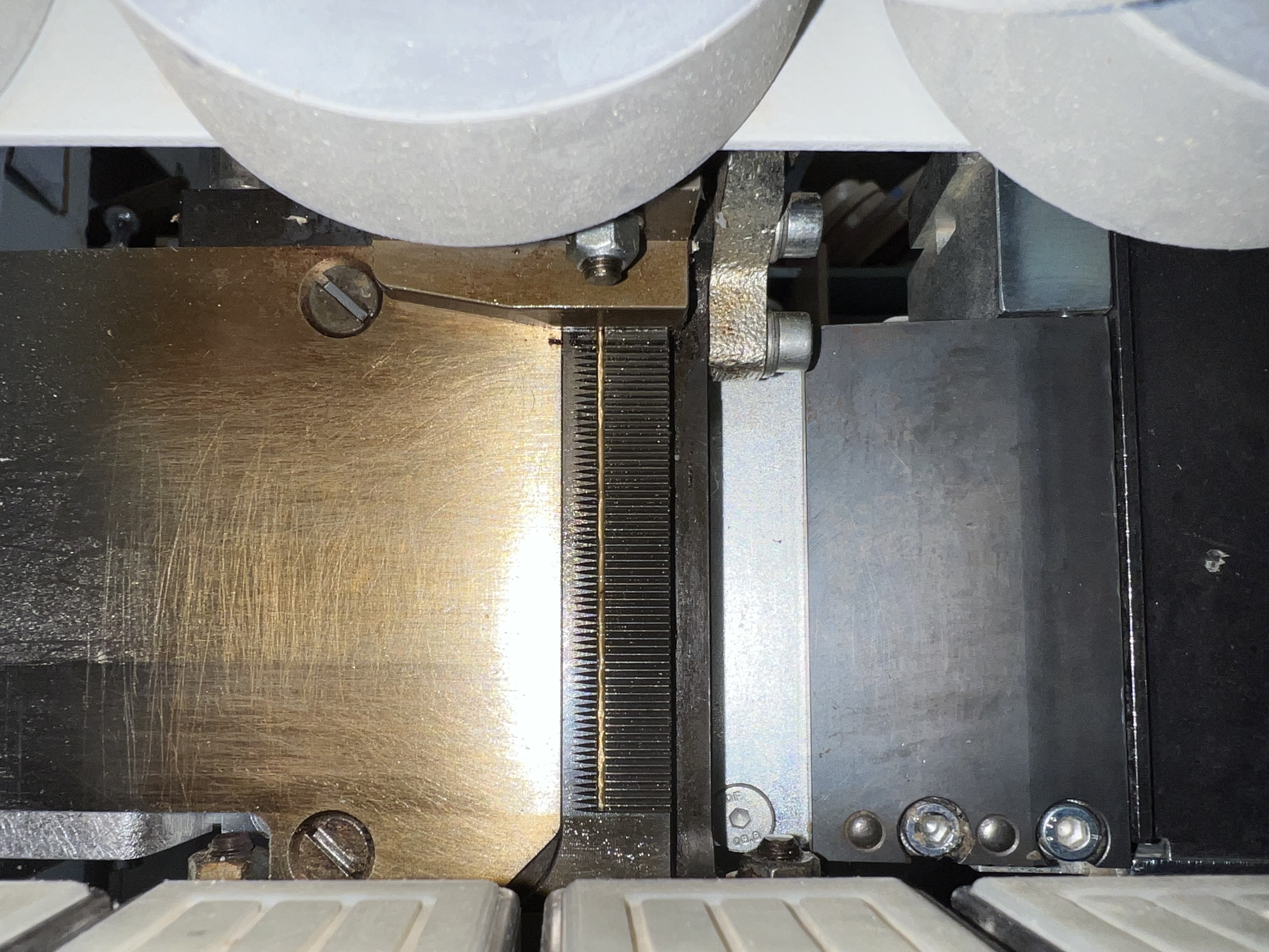

2/9/23       #8: Holzher Bander excessive glue ...
Akram Member
Website: http://www.americanvisioncabinets.com
I turner the fork 3 turns, reduced the quantity of glue bust still see the glue line.
attached picture showing glue nozzle, top shoe is sliding on top of the cabinet part and as you can see, the cupper rod is the one that has a vertical slot, releases glue when the Cylinder and fork turn it.
my question is the sliding shoe has to be aligned with slot or under.
Thank you.

I never had to adjust anything there so I can't really help you with that.

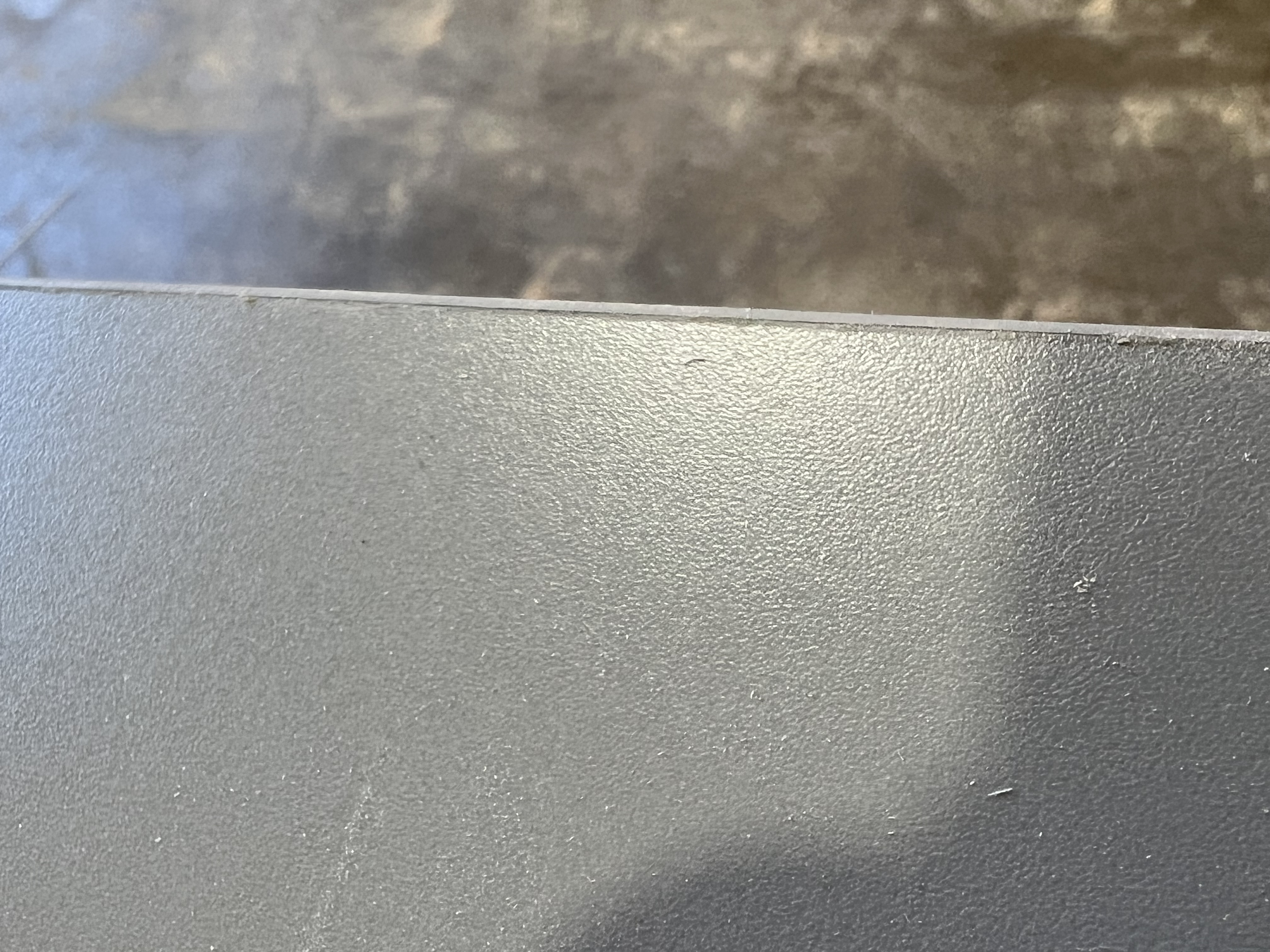

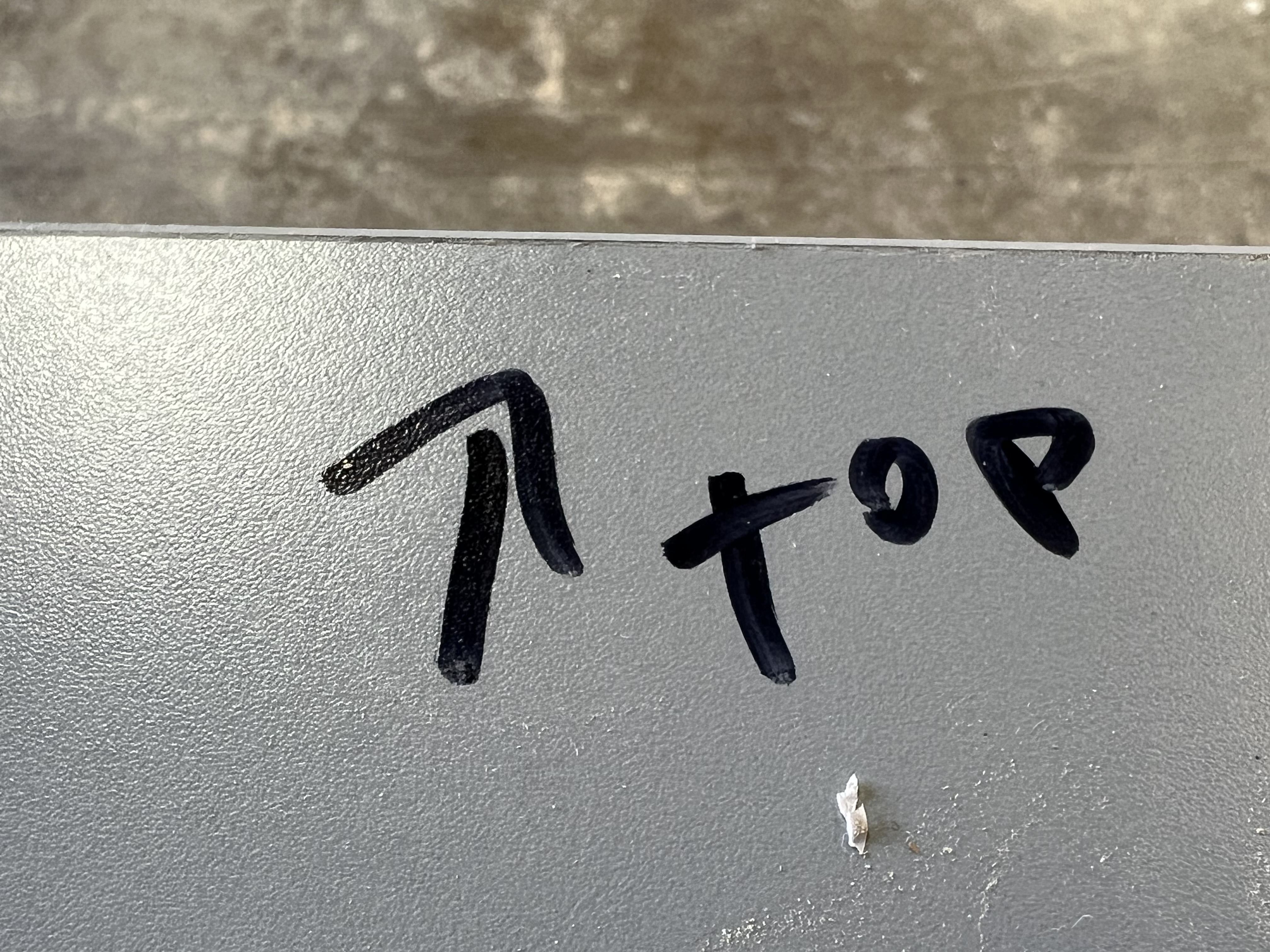

3/6/23       #10: Holzher Bander excessive glue ...
Gerry
Is the edge of your panel square? If not that can cause this.
