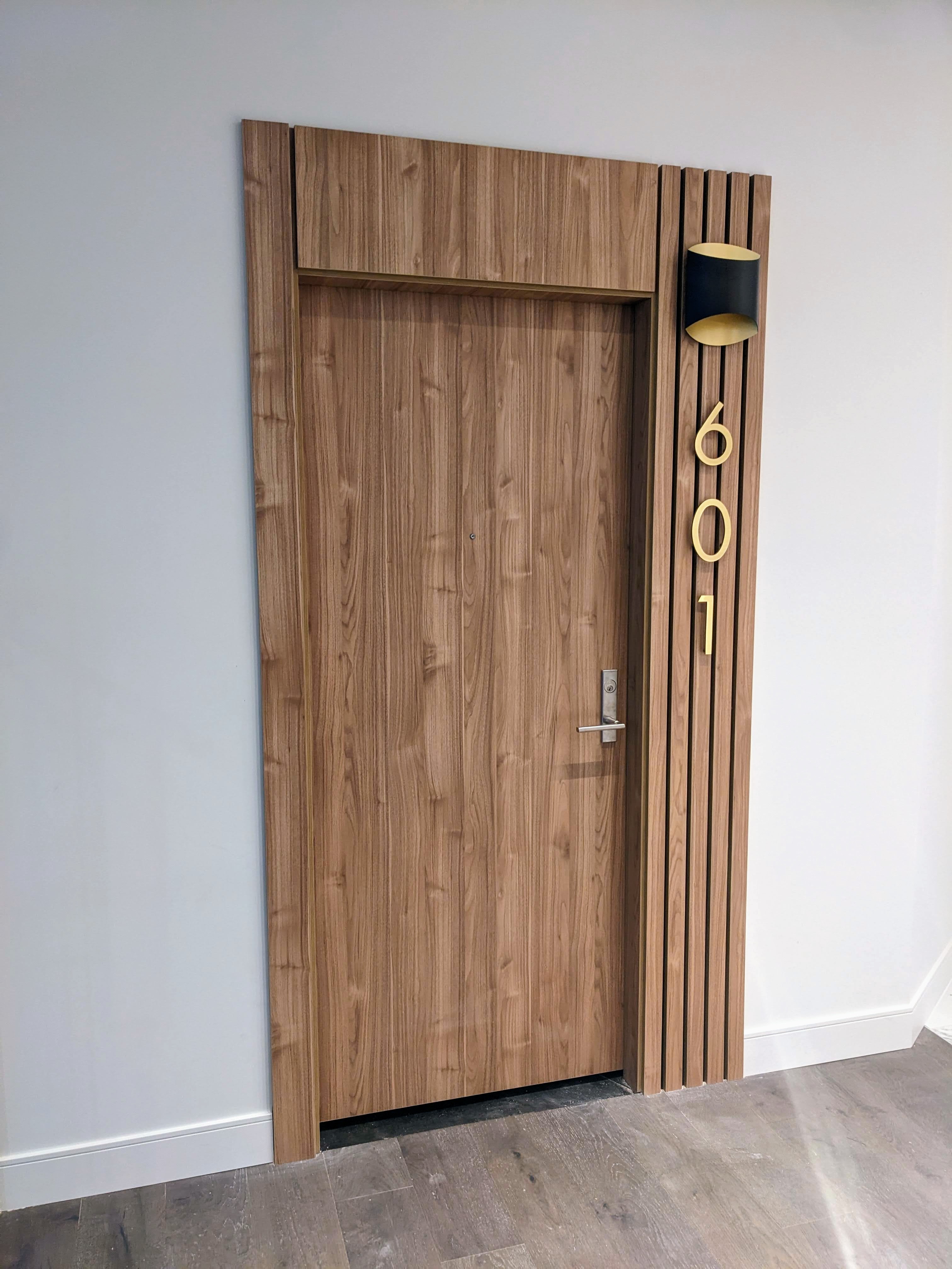

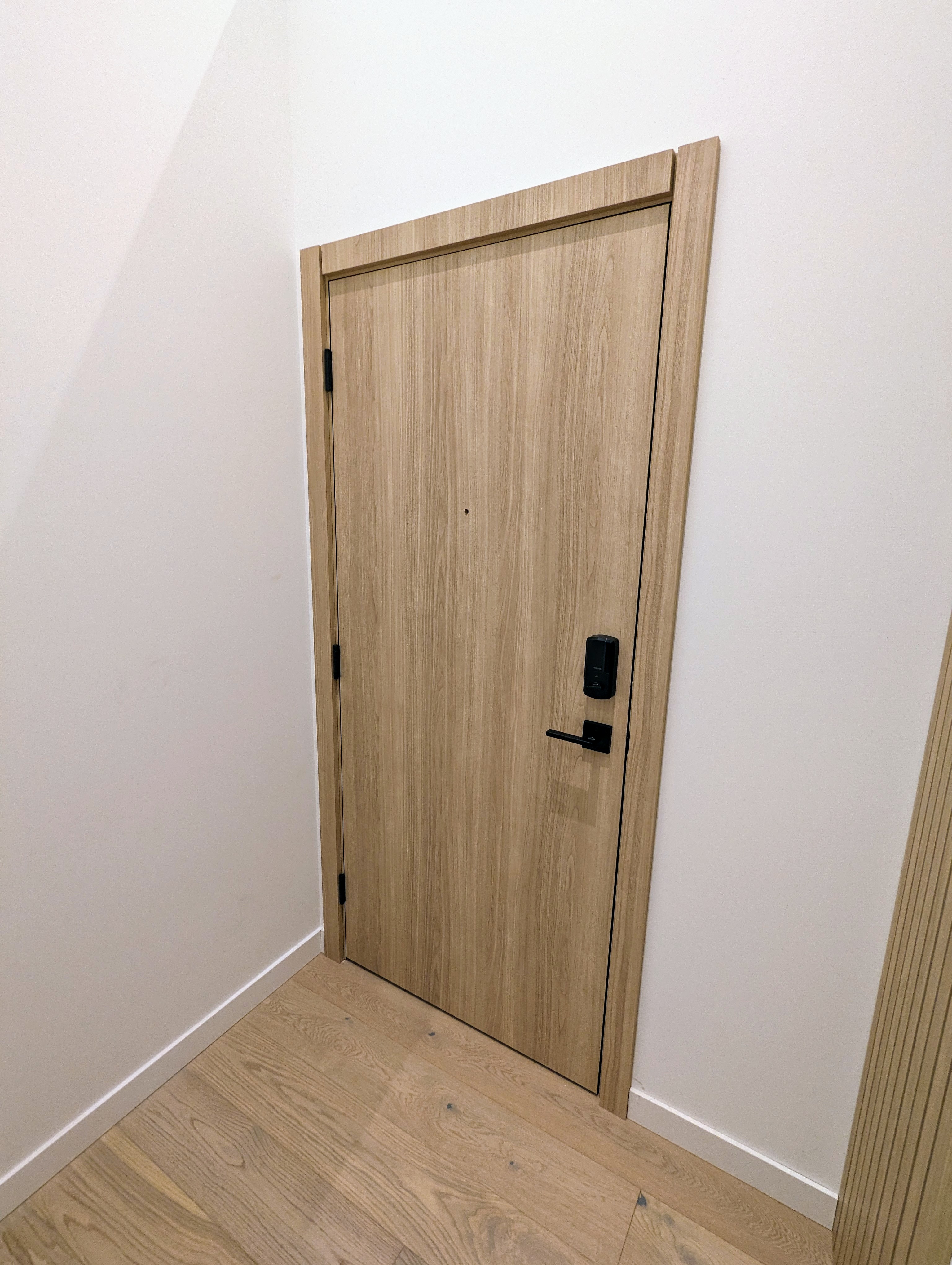

We install lots of laminated apartment entrance doors on new high rises and Milwaukee 12v 23g seems to last the longest for a cordless. They seem to last between 5,000-20,000 nails, depending on the installer. Still a far cry from pneumatic, but it's cheaper than dragging a compressor around.
View higher quality, full size image (3072 X 4080)
