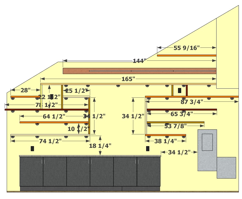

Speeds up panel installation for us immensly. We use it here and there and find that we might go through 300 fasteners in a month and then for the next three months use 10. So it comes and goes.
I will say that thre cost of the fasteners never bothered me as when used it was serving a purpose that samed a ton of time and we do our boxes with dowels and cse clamp so we are using it only where needed. I find them to be very fast and a great install aid. Also occasional use in the shop. For me install time saved is where it really shines.
In pic we used zeta to connect all shelf units on site super fast and easy with no visible fastener.
