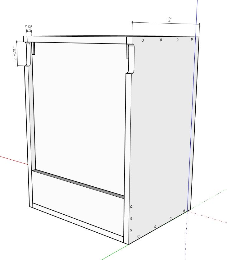

I am planning to start hanging wall cabinets using a rail on the wall and hanging brackets inside cabinets. My cabinets have 1/2" thick melamine backs that are tongue and grooved in a 1/4" deep x 1/2" wide groove on all four sides. There is also a 1/4" clearance between the back and the final edge of the cabinet. There are no nailers. I can increase this clearance to about 1/2" if need be.
Details are in the attached drawings.
Since I've never used this system before, I would appreciate it if someone could guide me on which hardware would work best with these given specifications. I don't have CNC, so minimal added machining would be desirable, e.g. a simple round hole in the back is preferable to some odd-shaped slots.
I'm also considering using rails on both the walls and cabinets since I don't expect that much need for adjustments if the wall rails are installed correctly (level and straight).
What do you all think?

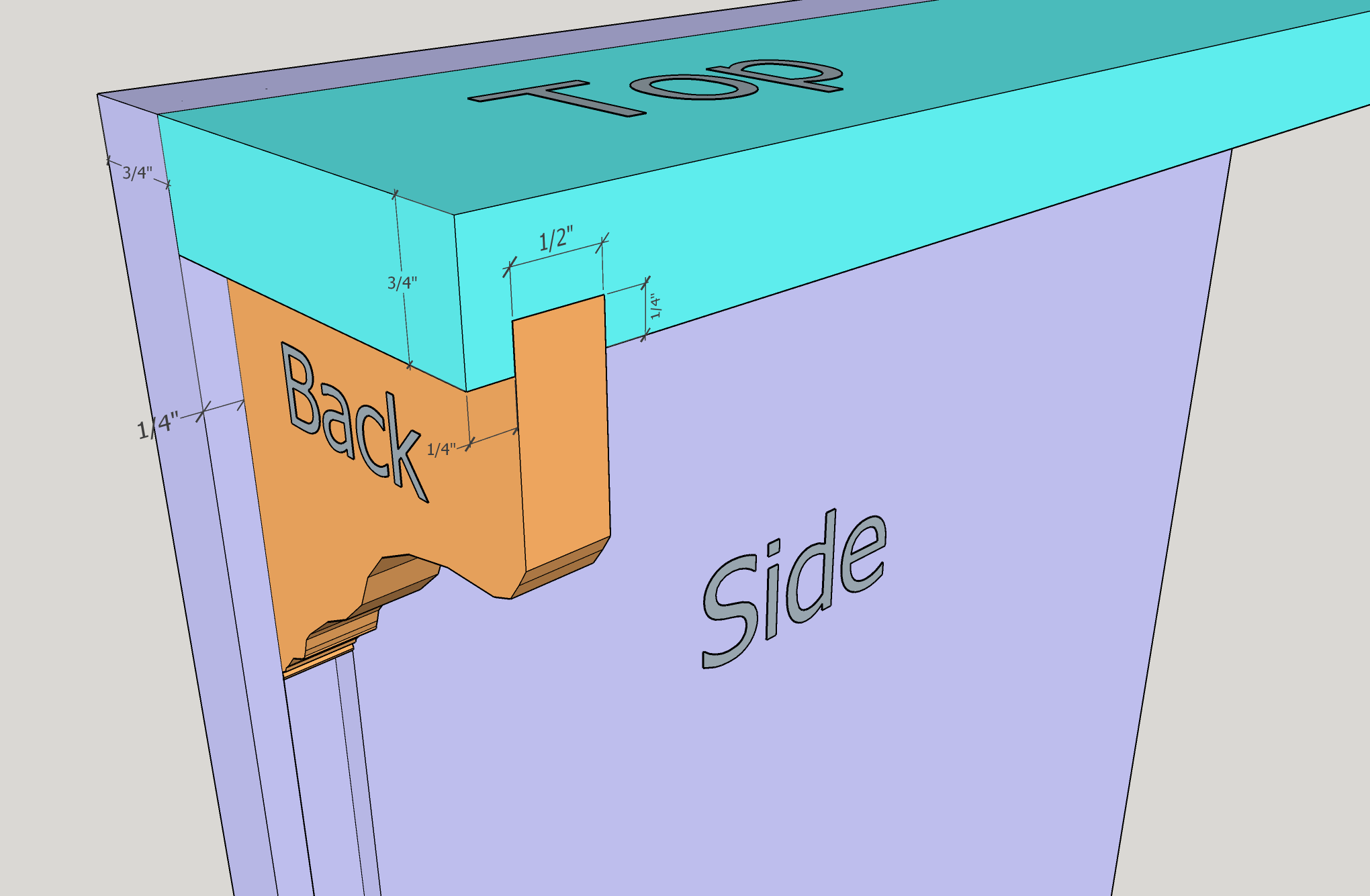

"French Cleat" Works great for us. Requires a 3/4" inset for the 1/4" back panel instead of your 1/4".
We build our uppers at 13" deep. 13"-1/4"-3/4" leaves us with a 12" interior depth. We also run a pocket holed 3/4"X3" nailer across the bottom so we can screw through the cabinet and secure it to the wall, cover the screw with a sticky dot.

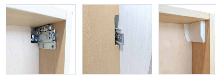

Suspension rail we call and a bracket that attaches to the side of the box.
its made of steel and the system works like a french cleat except this bracket has two way adjustment and the members are made of steel.
You need to machine u shape notch for the rail.
Way easier than any other system and flexible.
Good luck.

Yavuz, who is the manufacturer of those brackets on your picture?
1/28/24       #9: Hanging brackets for wall cabinets ...
Yavuz Member
Oggie, if you google "Peter Meier 875-Z1-24" you will find all the info you need.

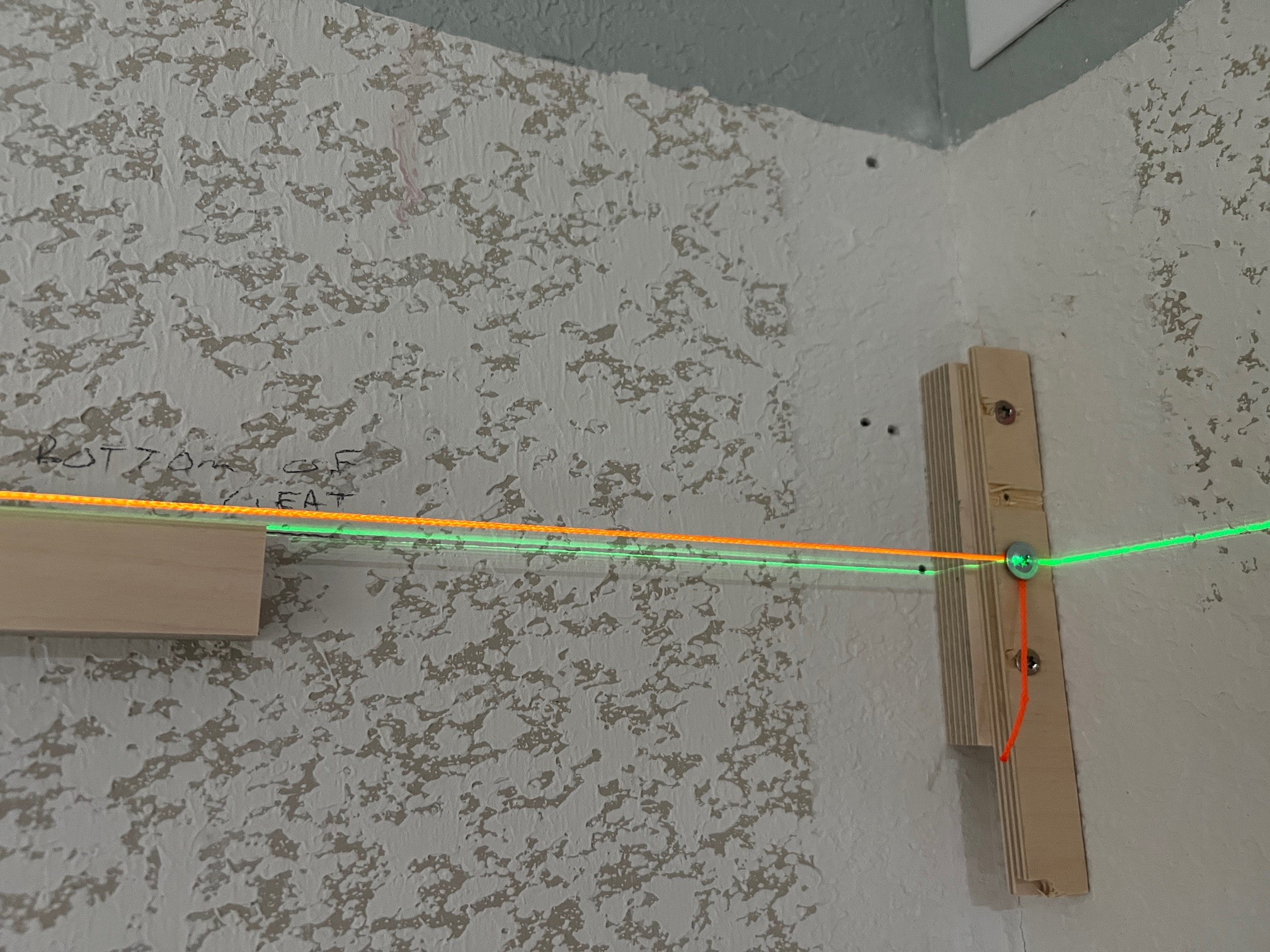

I am a furniture builder but currently building and installing my kitchen cabinets. Did frameless with 3mm reveals as well using Festool Lr32 I used a french cleat runner at the back of the cabinets. To install on my wavy wall I just ran a string and shimmed each cleat to the string. I double checked alignment with a long level and cabinets were shimming at bottom. The came out perfectly square, level (front top and face)
