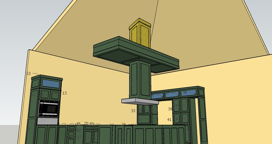

I have been asked to fabricate a range hood shroud as is shown in attached image.
While I am comfortable designing the upper and lower frame and panel covers as panels glued together, the large section is giving me pause.
The large section will measure approximately 51"× 144" × 16" tall.
Does anyone have any advice on how to approach fabricating this to hold the weight of itself, upper and lower duct covers, as well as the 150lb hood unit and inline blower?
While I first envisioned building it with cope and stick soft maple frames, I am beginning to wonder if that is asking for trouble with aesthetic cracking in the future. With this route, the ply would need to be glued into the grooves; I typically leave all panels/ply unglued with spacers.

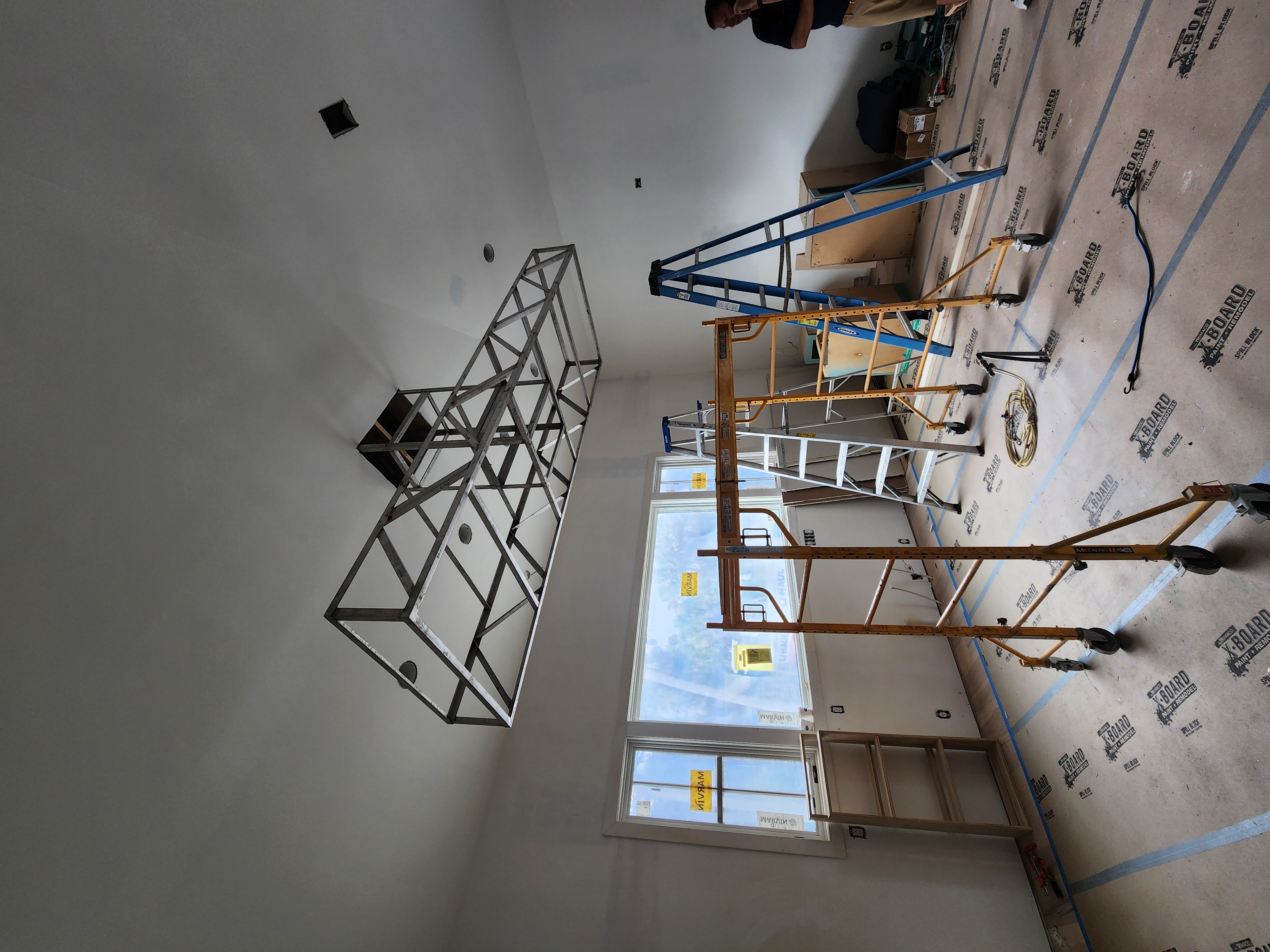

6/21/24       #10: Island Range Hood Shroud ...
Vince Member
Thanks for the ideas guys!
6/21/24       #11: Island Range Hood Shroud ...
Vince Member
6/21/24       #12: Island Range Hood Shroud ...
Dustin Orth  Member
Nicely done! Did it go together as you expected? Thanks for the final results, a lot of times no one gets to see the end of someone asking a question.
6/21/24       #13: Island Range Hood Shroud ...
Yavuz
That's what i am talking about. Awesome !
6/21/24       #14: Island Range Hood Shroud ...

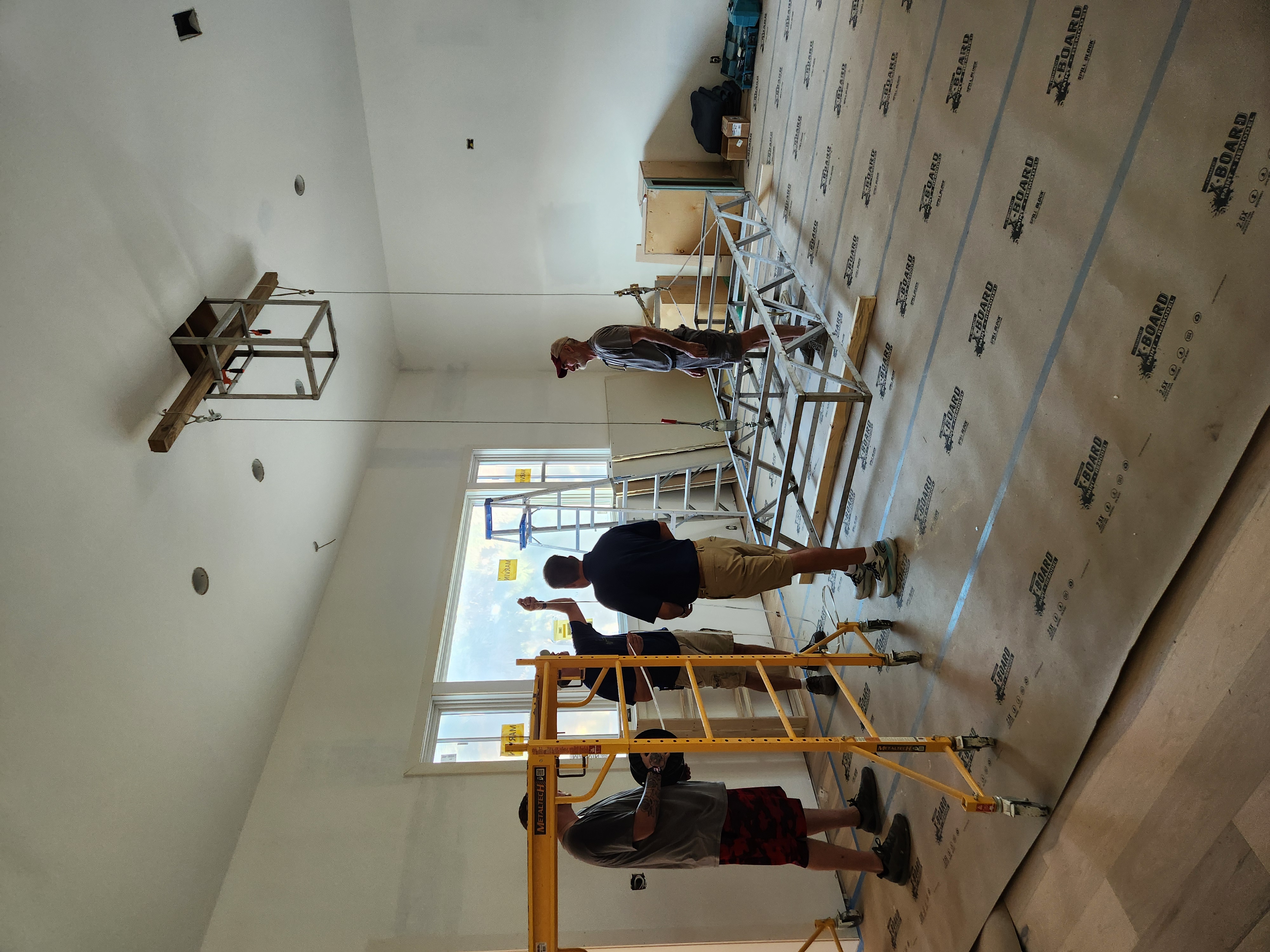

Vince Member
Thanks guys.
Dustin, yes it went together well. It was challenging to install, but of course, would be easier the next time.
We bolted to 2.5" channel laid on the rafters (there's an attic, two vaulted "ceilings").
Used two come-alongs to raise it.
The hardest part was drilling through the metal for the 1/2" bolts. Took 3 guys, one with a right angle drill, one steadying the drill, and one on a 10 foot 2x4 as a lever.
