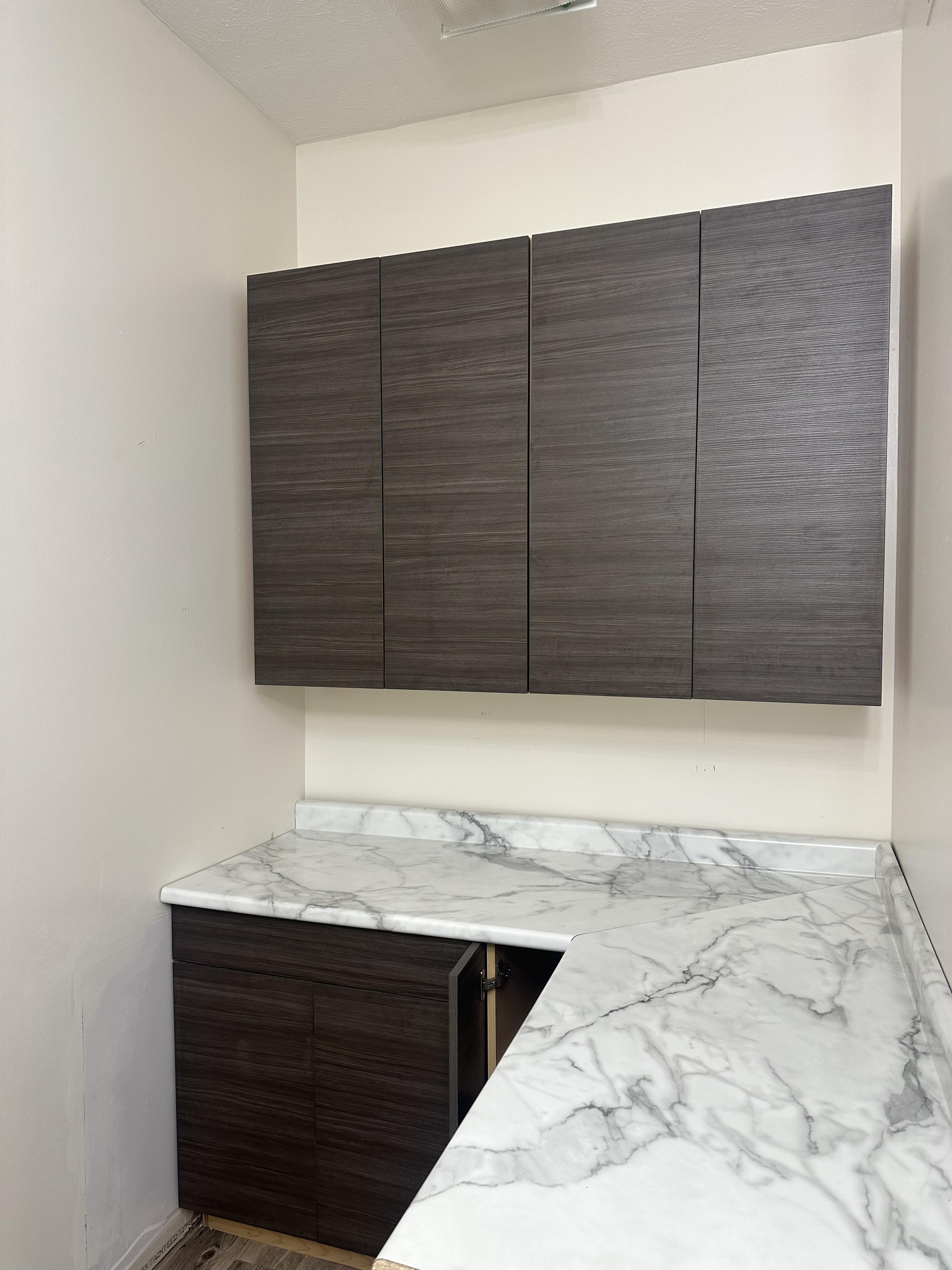

Had a chat with a long past acquaintance.
She's a Designer/Specifier
She shared a job pic
I shot from the hip.
"Whether veneer, or p.lam, those panels don't match."
That's what I said, V. Disagrees.
What do y'all think?

cris
I believe the designer is referring to the grain match.

Jay Kyle Member
I'm saying, there is no grain match...

Rich  Member
Did the customer order grain matching fronts? My first question would be why is the grain running sideways.

Jay Kyle Member
It's supposed to be horizontal grain, but the grain is supposed to match...

FM
They always come grain matched from my shop.
But if you are using in a thermofoil door that is the case. Isn’t going to happen. Plam sure but not Thermofoil.

Seeing as this appears to be a kitchen on a very low budget, my guess is that the quote did not include doors to be grain -matched. You might say but it doesn't cost any more to grain match but it requires care and attention which does come at a higher price.

It looks like an office utility space to me. The post formed top is a bit of a giveaway.
Laminate shops will push a job like that through quickly; they may initially cut and label the stock in sequence for a matched face, but by the time it makes it down to the person boring hinges, the labels are long lost, (They're usually written in sharpie on the back)
That the shop released them as is says grain match wasnt a concern for them. and if matched grain wasn't specified on drawings and contract, "Ya gets what ya gets"

The horizontal grain has become common around here over past few years. We have done quite a few of these but it’s rift sawn white oak . And the grain in this picture does not match
