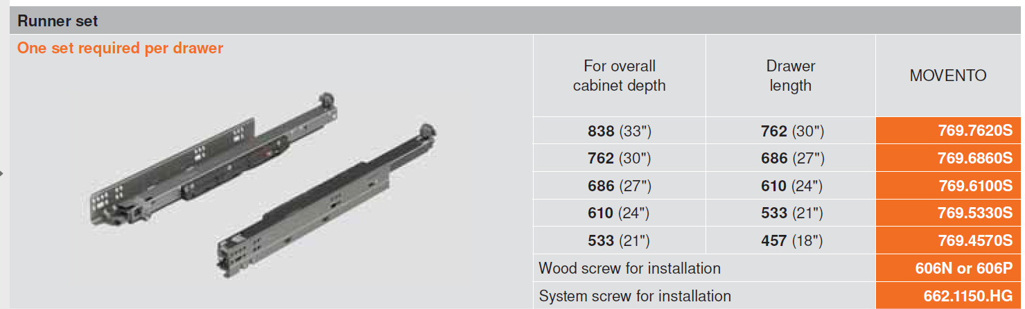

From the catalog
MOVENTO
Overall cabinet depth Drawer length
838 (33") 762 (30") 769.7620S
762 (30") 686 (27") 769.6860S
686 (27") 610 (24") 769.6100S
610 (24") 533 (21") 769.5330S
533 (21") 457 (18") 769.4570S
Wood screw for installation 606N or 606P
System screw for installation 662.1150.HG
11/2/25       #4: Blum 27" Movento Slides ...
Well that didn't work well
