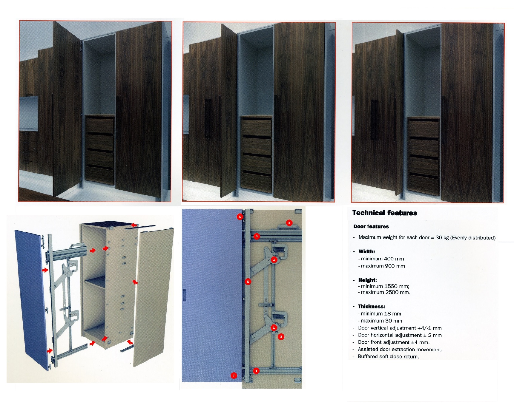

Bill,
Here is a preview of something all together new in the concept of pocket door systems for larger, heavier doors with Euro style cabinets.
View higher quality, full size image (1721 X 1368)
