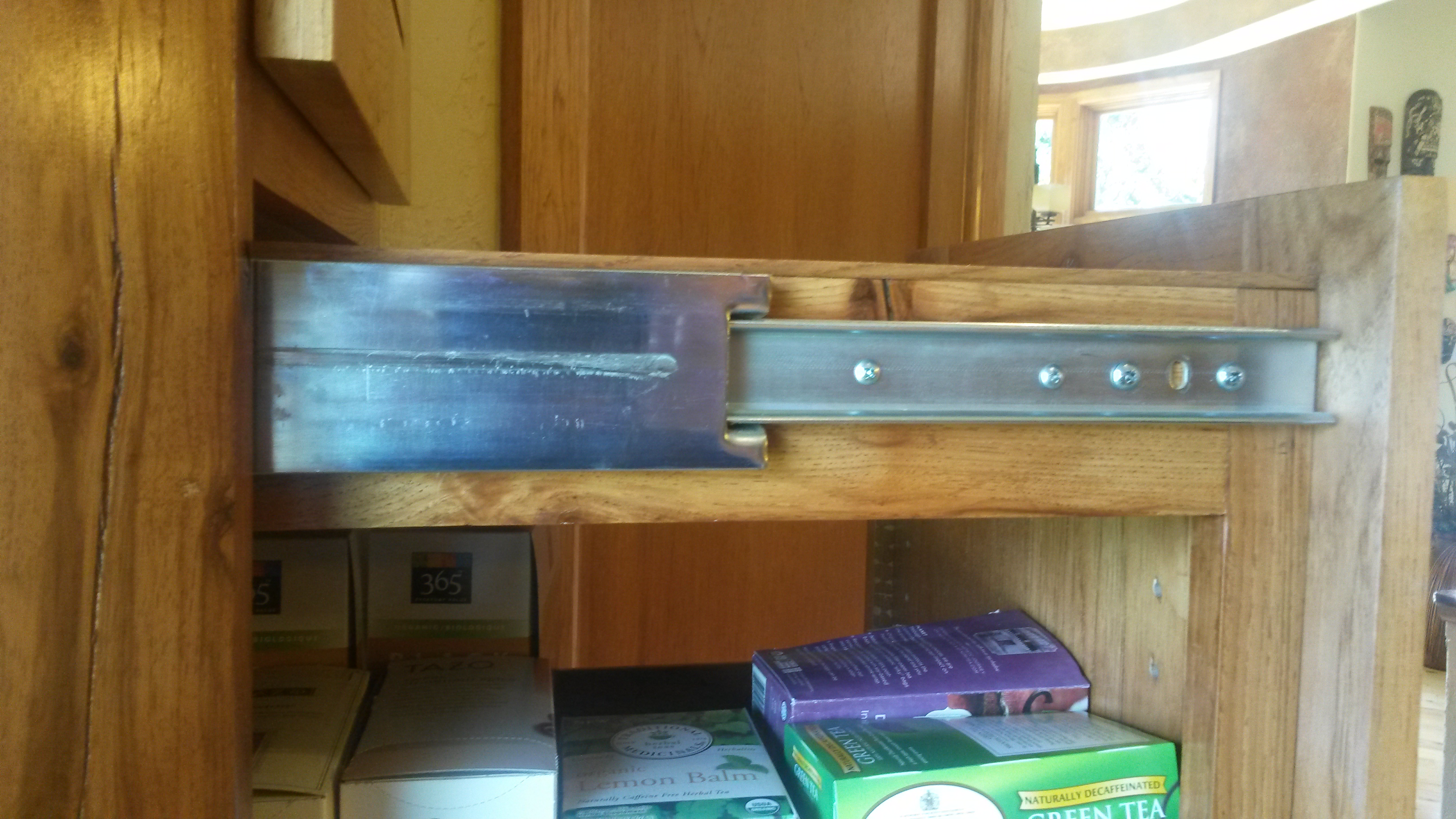

A customer has this slide out pantry with these slides. It seems as though a screw has backed out which is now binding and catching on the slide. I don't recognize the slide or see any means to release them? I can't unscrew them, because it won't open far enough to get to the last screw.

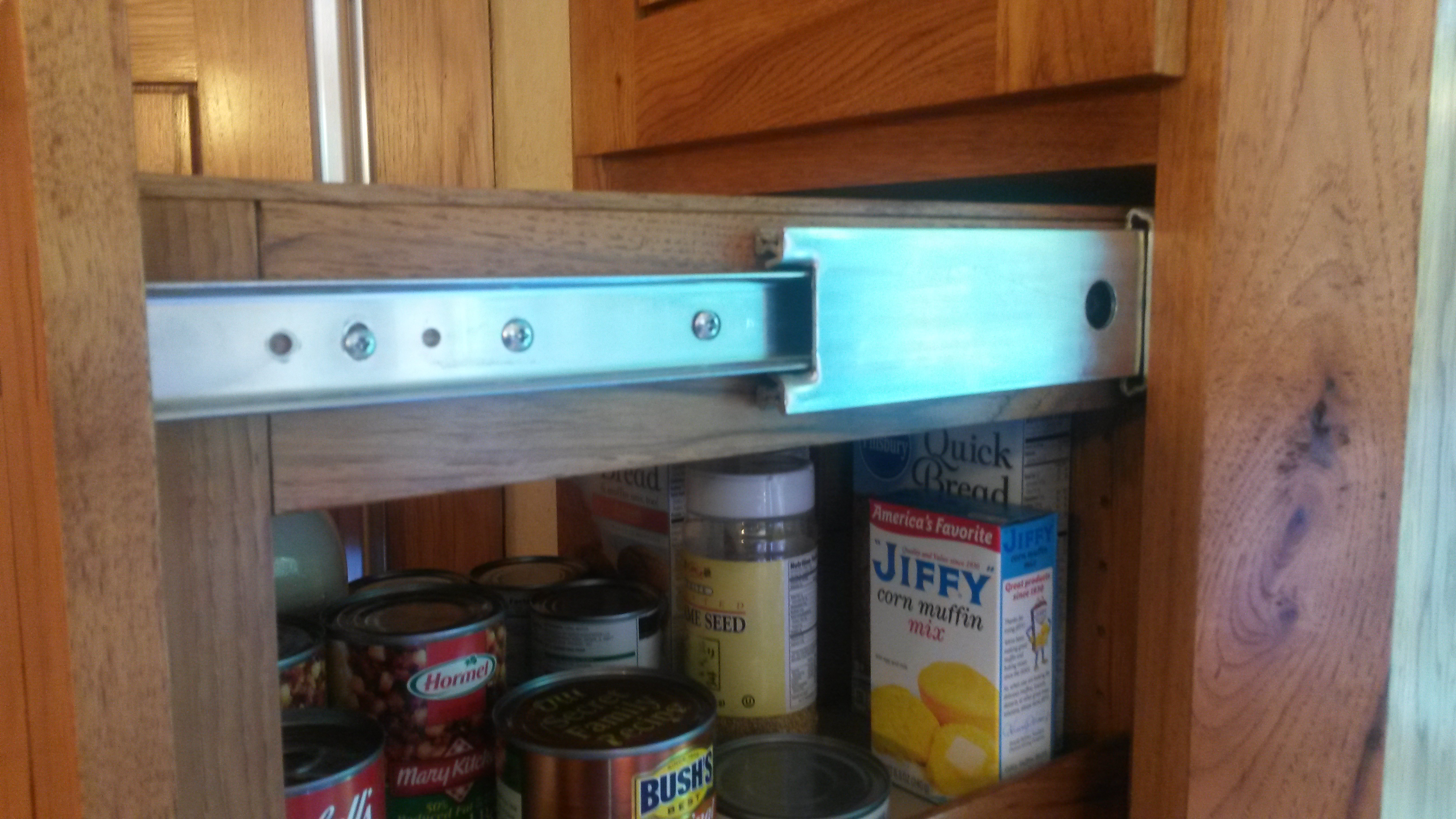

The second picture is of a second slide out fully extended which is working properly.

Looks to be an Accuride profile which proofs nothing. Too many knock offs but not a KV or Grant/Hettich.
There should be a release that you may access with a long narrow screw driver. What is the dimension of the outer channel, height?

Check the side clearance dimension. If that dimension is somewhere around 3/4" (.75), than it's a good bet that it is a Accuride Heavy Duty Knock-off. That slide has no quick release, it must be disconnected by the screws. If a screw is preventing it from sliding out to get access, than you may need to remove the slide from the inside. Not easy in any case.
