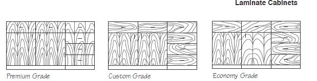

I sure hope you have some specs, residential or commercial ?
Remember Specs Trump plans (Pun Accidental)
View higher quality, full size image (619 X 159)

The specs should tell you grade Economy, custom And I doubt premium.
can you post the spec section

Went through the specs again this morning and found that they are requesting premium grade. Thanks for the help!
2/22/16       #8: p-lam on drawer fronts ...
james mcgrew Member
If that is the case I would google the AWI standards, and Join the AWI in the long run you are gonna want to know this.
Premium can call for some things beyond a grain direction and with laminate make sure it matches verticle and horizontal
Depending on architects knowledge of AWI specs You may have to plam the interior of the doors and drawers.
