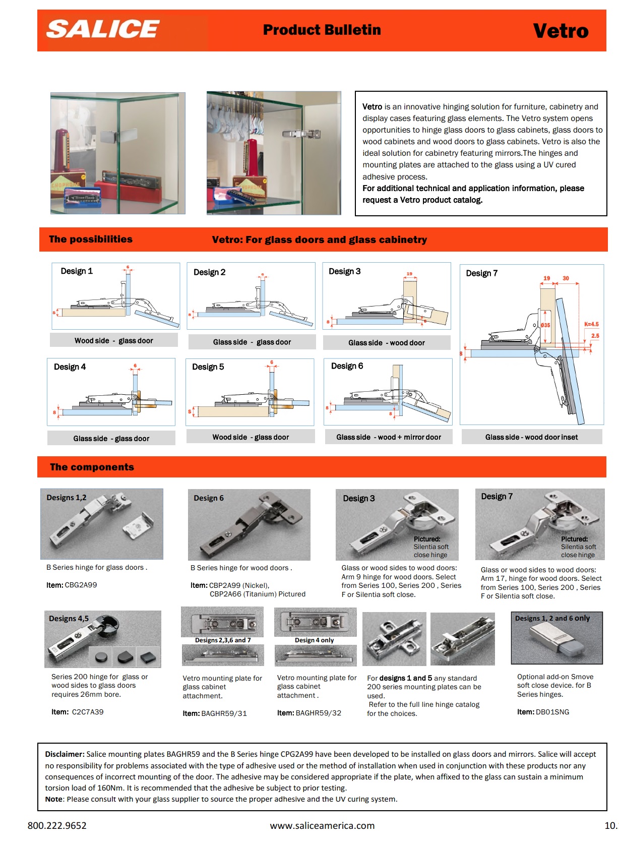

I am not familiar with any glass door hinges like what you describe that can be used with glass over 1/4" (6mm 1/4" TAB).
Salice does offer a hinge that attaches to the surface of the glass by means of a UV adhesive. There is no drilling of the glass required.
Here is a product bulletin for the Vetro hinge.
View higher quality, full size image (1228 X 1676)

I seem to recall seeing a Grass hinge that could be used with 3/8" thick glass but I can't seem to locate it anywhere now. Maybe I was just dreaming on that.
