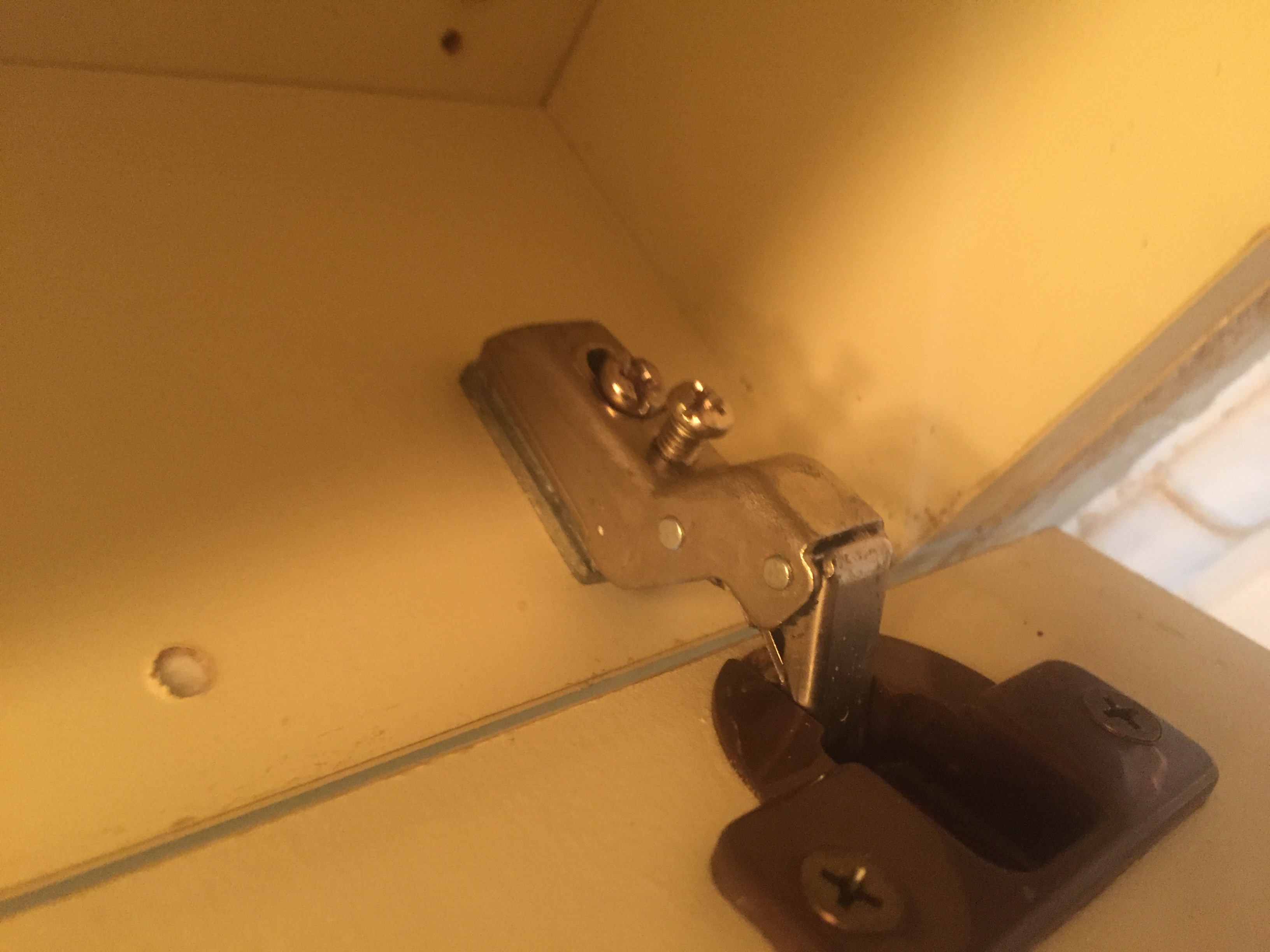

I am looking for a hinge for mirror doors.
The hinge cup is 3/8 deep
35mm bore and the arm is only 1 1/2 long
Is for a medicine cabinet.
Thank you,
Armando
9/23/16       #2: concealed hinge for medicine cabine ...
Hey Armando,
What you have there is a 1980's vintage concealed hinge with a plastic cup that could be any one of several brands. You will need to look in the salvage yards for something exactly like this.
The 3/8" cup depth is the key here. Also, it also looks like an inset crank hinge arm.

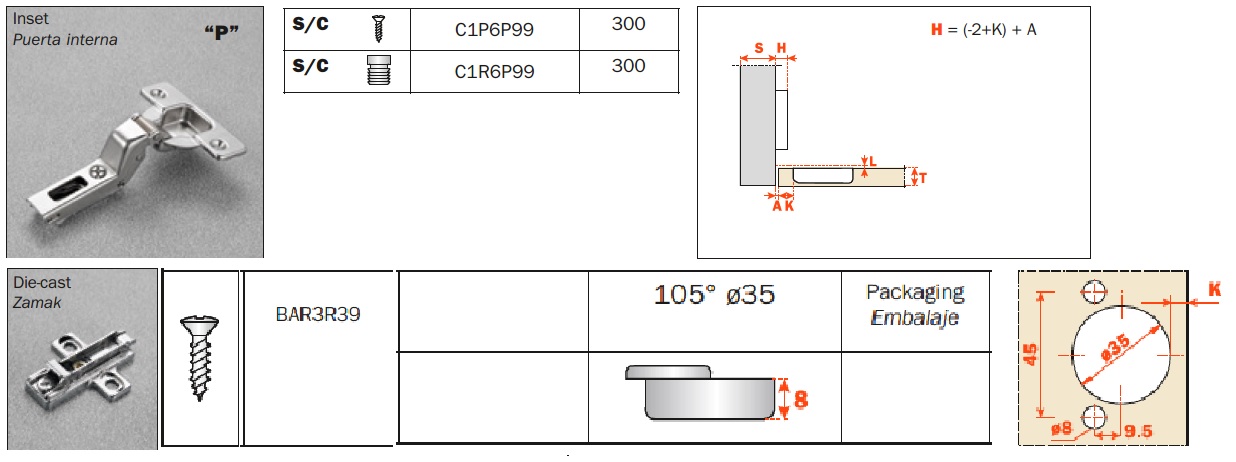

Here is the Salice, Series 100 inset hinge. It features a cup depth of only 8mm (less than 3/8"). You will also need to replace the mounting plate to a Salice mounting plate.
Good luck
