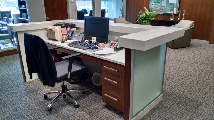

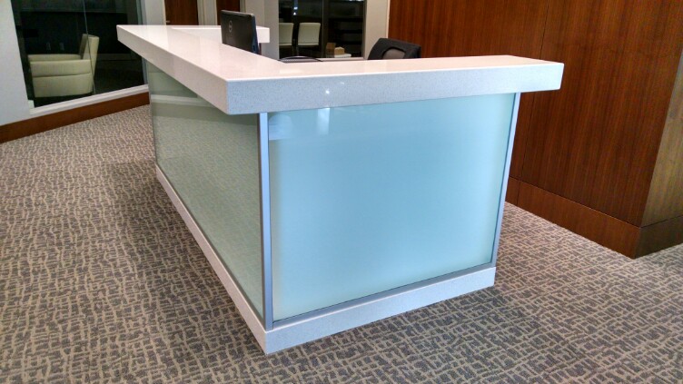

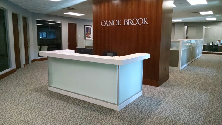

Tom C
I Do not get exactly what you are saying?
This is white Laminated glass 1" in front of white melamine. Glass in CRL alum.extrusions.
Walnut cabinetry behind.
LED strip lighting up in top recess gives a cool effect at night.
Silestone tops-Drop mitered. Silestone Base
View higher quality, full size image (752 X 423)
