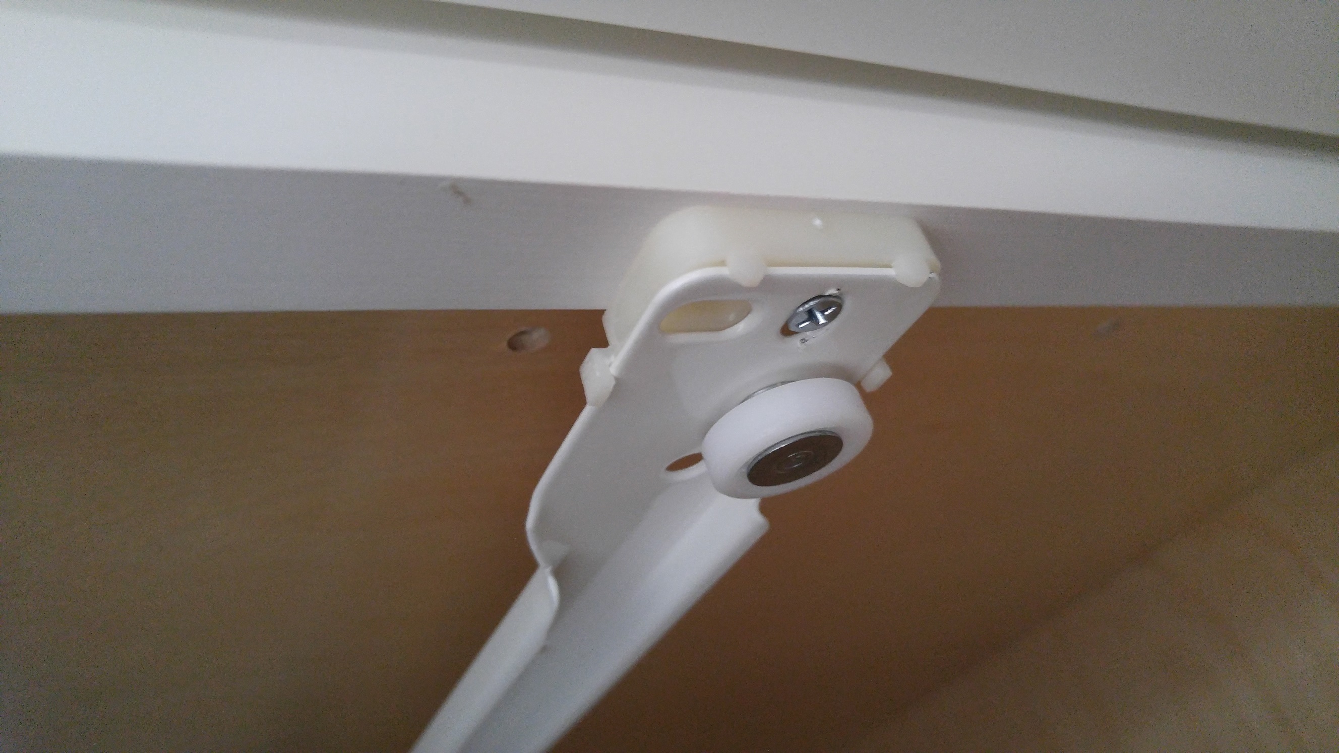

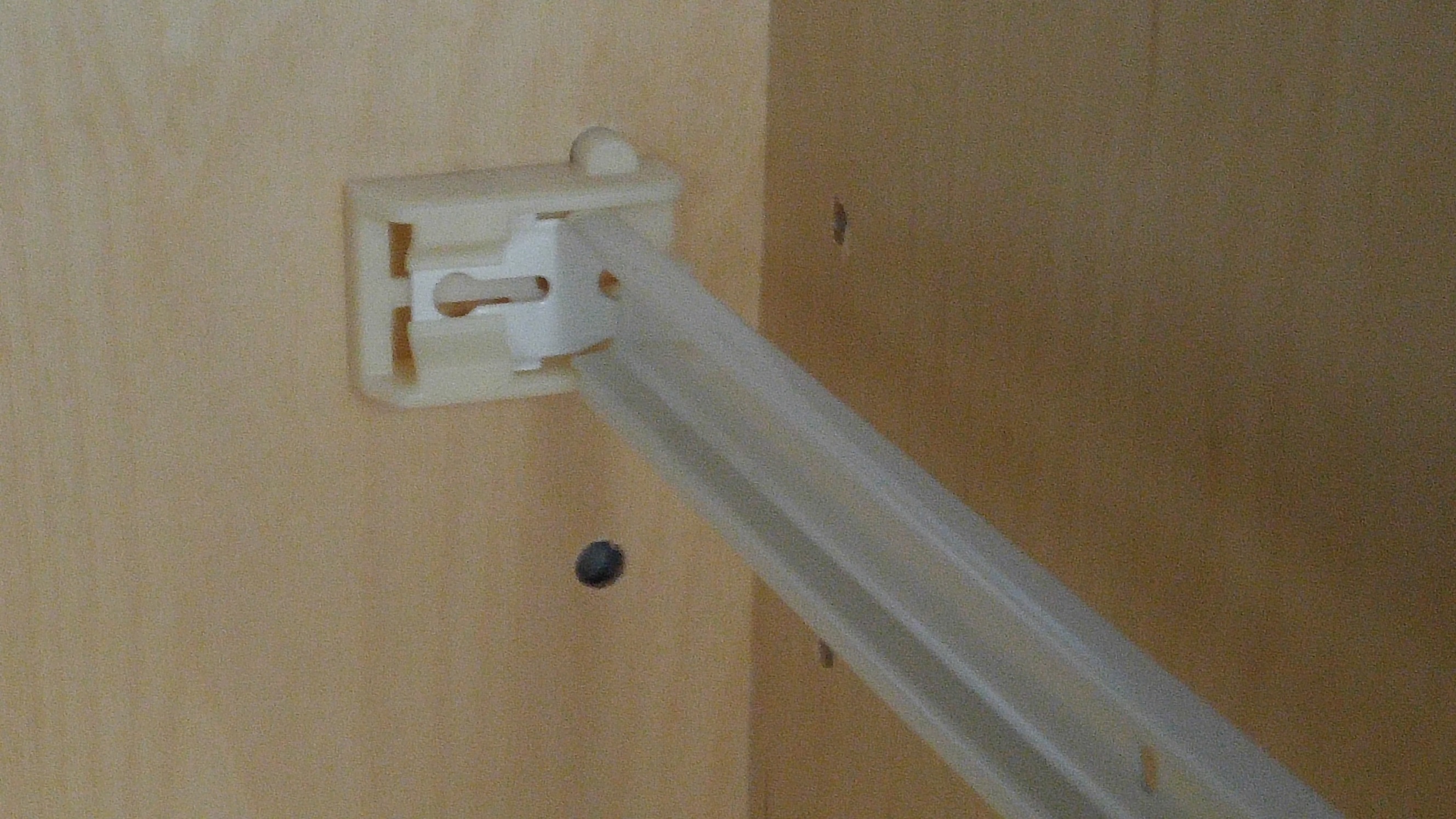

I have a project that I need to match existing slide hardware.
Can anyone tell me who makes or is the distributor for this particular slide and spacer setup. I find many similar but not the same.
View higher quality, full size image (2656 X 1494)
5/27/17       #2: Looking for this Slide Hardware Set ...
These were pretty generic slides used by larger manufacturers (Merilat, Aristokraft etc...).
The photo of the rear socket is called a V-notch slide. Grass and Houck both produced this type. I would check with them.
The front spacer looks like a product called "Billy Block" which is available from Westlund Distributing in Minnesota. It could also be a proprietary item made for a specific manufacturer.
5/27/17       #3: Looking for this Slide Hardware Set ...
Paul Miller
I have had similar requests in the past. This guide holder in the back of cabinet is the weak point for this drawer. The cabinet probably has a 1/4" back which most shops would not recommend.
I have just used blocks on the side of the cabinet and if someone brings this up as an issue, I explain that what we did made a superior cabinet. It has never been as issue.
